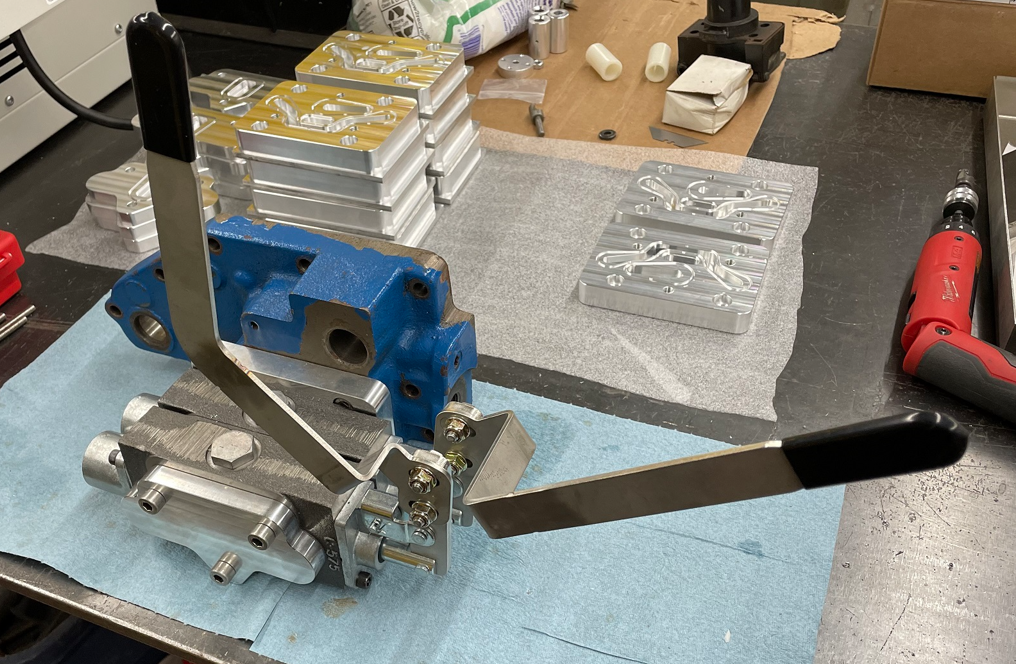

I've got a design 90% complete in CAD so just need to finish that up and then machine a prototype. I recently had a job change so this got delayed a bit. Hoping to get back to working on it soon!

Do you have any pics with your kit installed? Im curious how the levers will be
Since I don't have a 1720 to put my own kit on, I don't have any pics of the kit with the new levers. I've sold a couple kits in the last few weeks, so hoping I can get a picture from one installed soon.

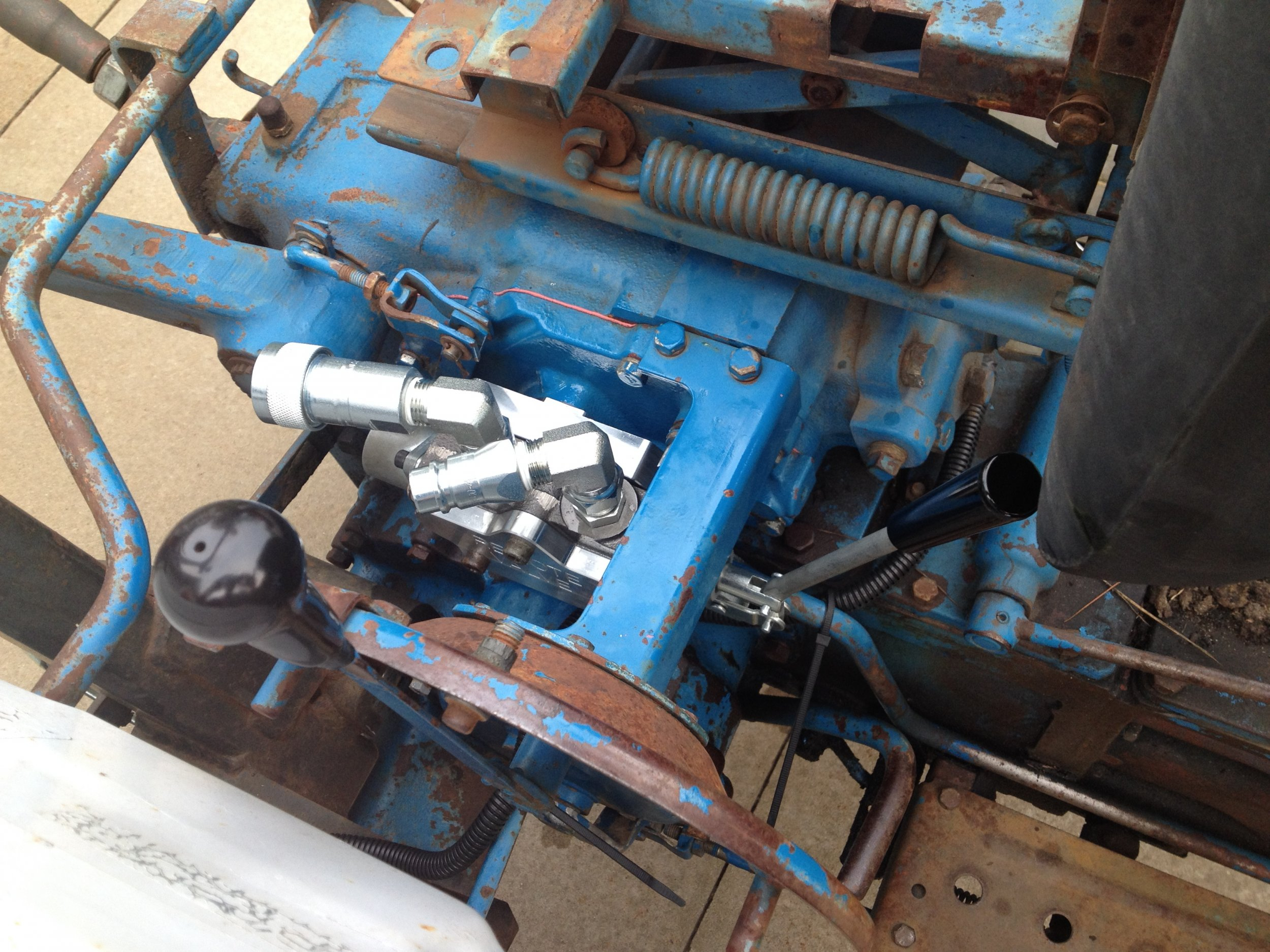

Got a kit from @tedward4 looking forward to installing on my 1620. Meanwhile I just did a 99% install on my TC33da of an OEM valve I found on the internet and parts I cobbled together. Overall cost was under $300. I got really lucky as the OEM valve is the most expensive part and is hard to find. Mine did not have the lever, linkage or anything specific to my tractor. The hoses are 12" 3/8npt off the internet as are the fittings. The lever is a 3pt lever that was cut and bent to fit the curve of the fender and exit in the right spot. That lever alone from NH is around $200. The adjustable link needs to be around 7" long and can be found on the internet. I got a used NH one for $20 and spliced it to length. I didn't remove the wheel as it is filled and I felt I could access all I need. Once the inner plastic fender shield and the top plate was removed I could reach either around the wheel or through the top of the fender where the levers protrude. The most fiddling was around bending and trimming the re-purposed lever, and measuring/welding the bracket lever on the valve itself. Splicing the linkage went quickly. Probably spent about 4 hours altogether. I still have to fix the location of the quick couplers. Perhaps add a short fitting to even up the hose lengths. I paid $120 for the valve and probably around $150 for the rest. Can't wait to get my top link!
