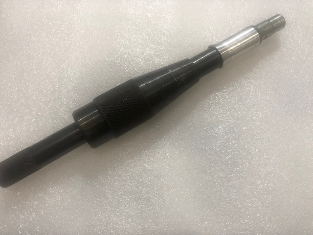

IMO, best $35 tool for 20-series Ford/NH CUTs if you don't nave it already. Pretty much all you'd need is in there.

Since the clutch alignment tool for the 1720 can't seem to be found anywhere, I wanted to describe how I aligned both clutches. I used a standard universal alignment tool (Lisle 55500 or similar) and a friend turned another cone piece from a block of aluminum to center the PTO clutch. I will attach a picture to this post later tonight to maybe help someone else in the future. It was frustrating that I couldn't just buy the FNH special tools.
   / Ford/New Holland 1720 Clutch Overhaul Questions #15
You got off just as well and for a lot less $$ than when the alignment tool was readily available.
