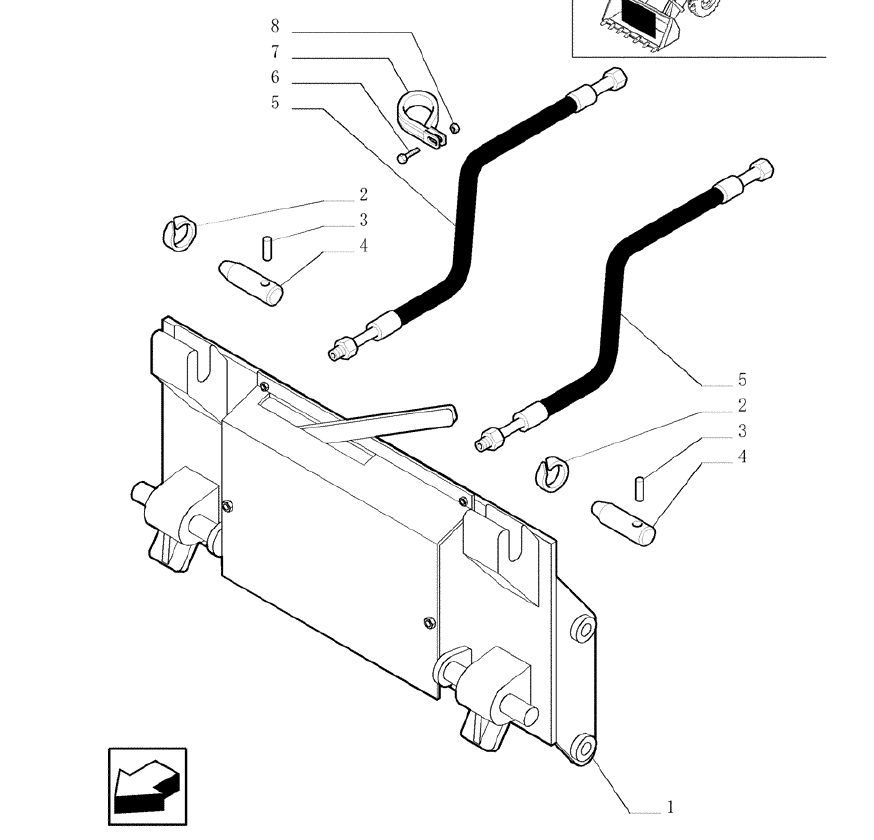

Here is Eddie's thread on his grapple install.
I PMd Eddie for some questions on his conversion. I was considering doing it to my 575E. He said if he did it over he would probably go with a construction type QA rather than the skid steer type. He said he ended up modifying his extensively to get strength out of it.
The Euro Global attaching system may be an option.
I have read that skid steer QA is not good for back grading but have no personal experience.
New Holland offered a Quick Release system for my 575E. The tractor part is over 3 grand and I haven't found the corresponding bucket or other attachments.
Here is what that looks like in the parts breakdown.
