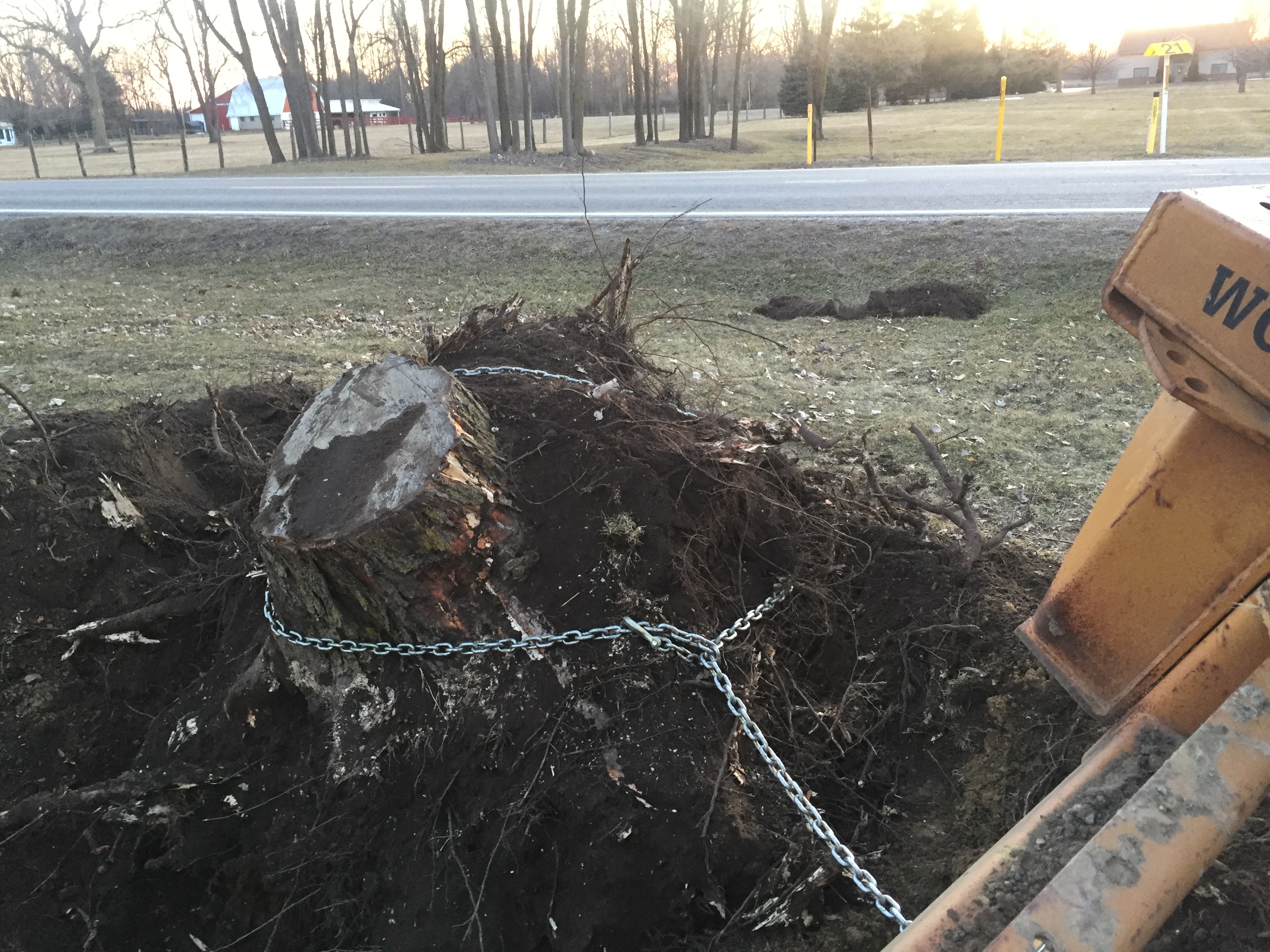

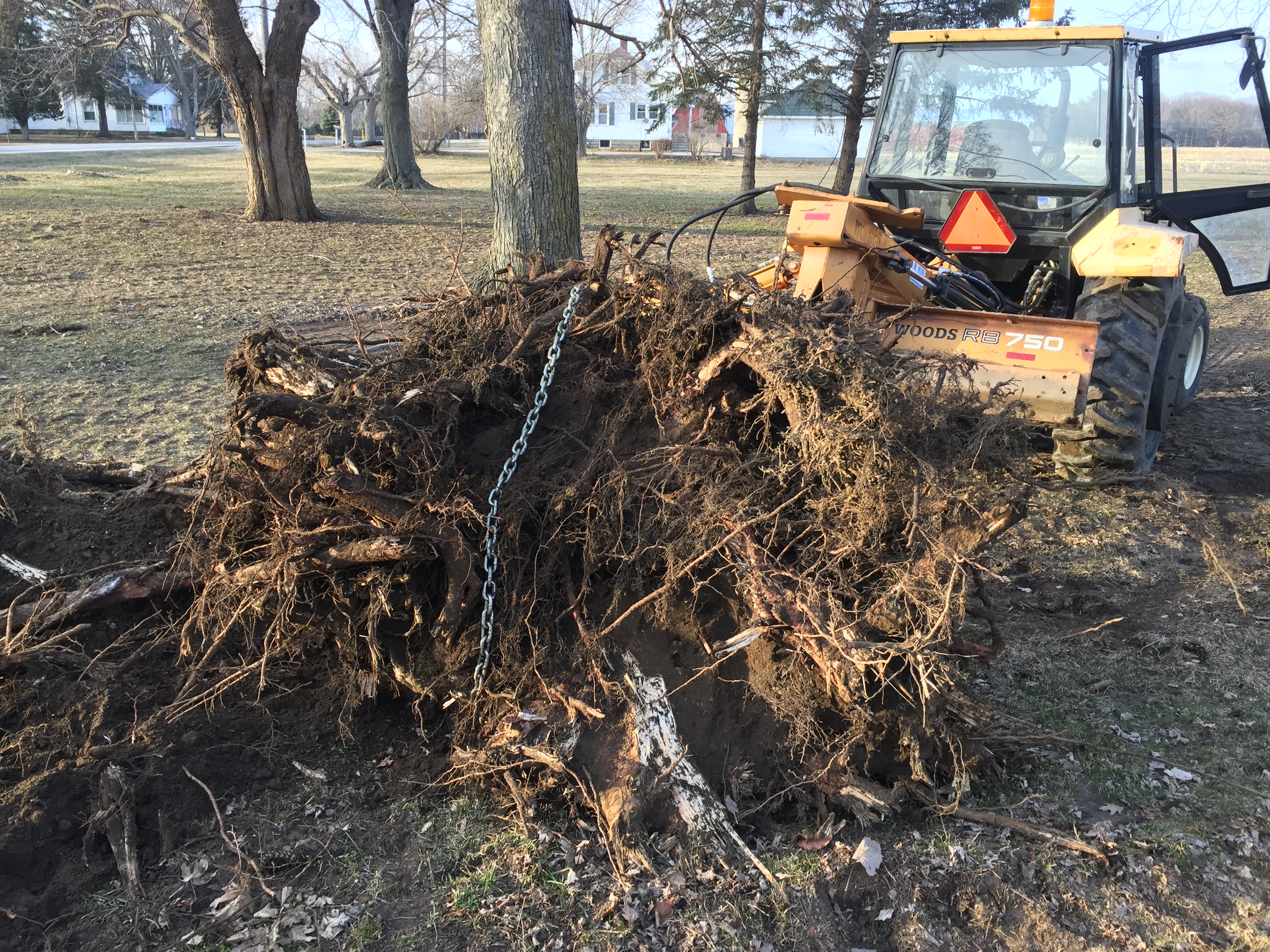

I dug out these stumps that were next to the house last week. The oak is 30” across and the pine was bigger. My Ford 4500BH loader couldn’t lift the oak or pull it out of the hole. The 545D pulled it out of the hole and across the field a 1/4 mile in 2nd low. There's about 1200lbs of wheel weights and 700lbs on the front end to keep it down.

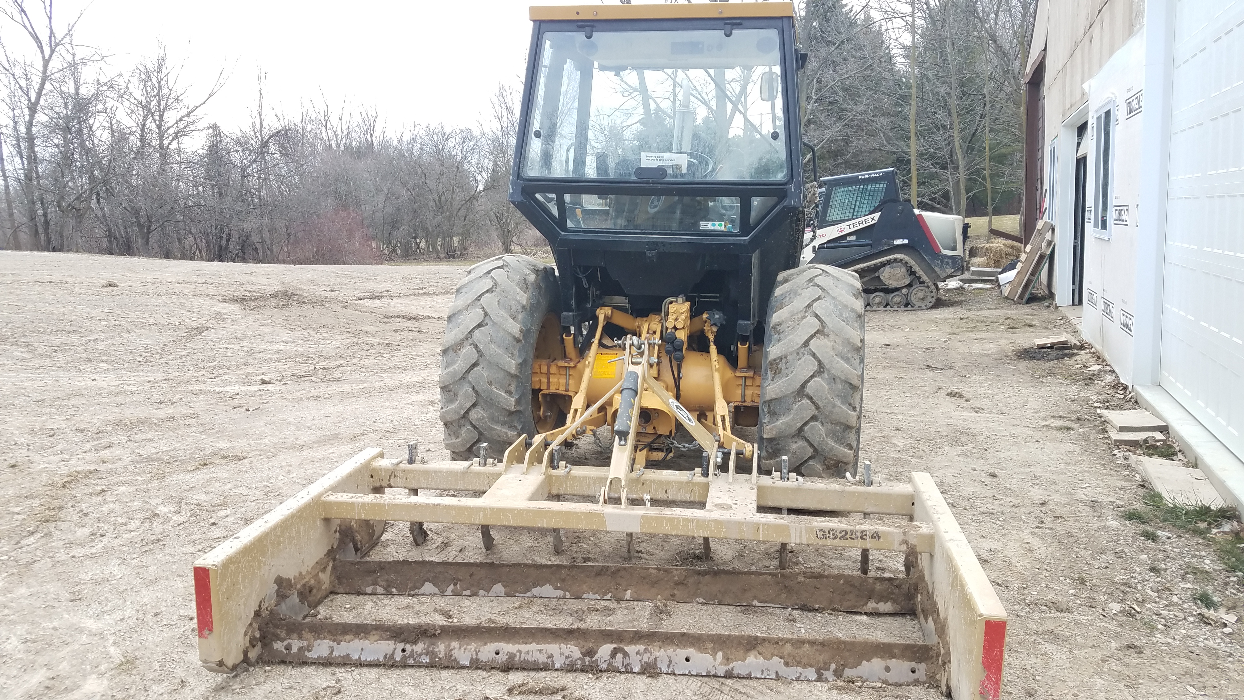

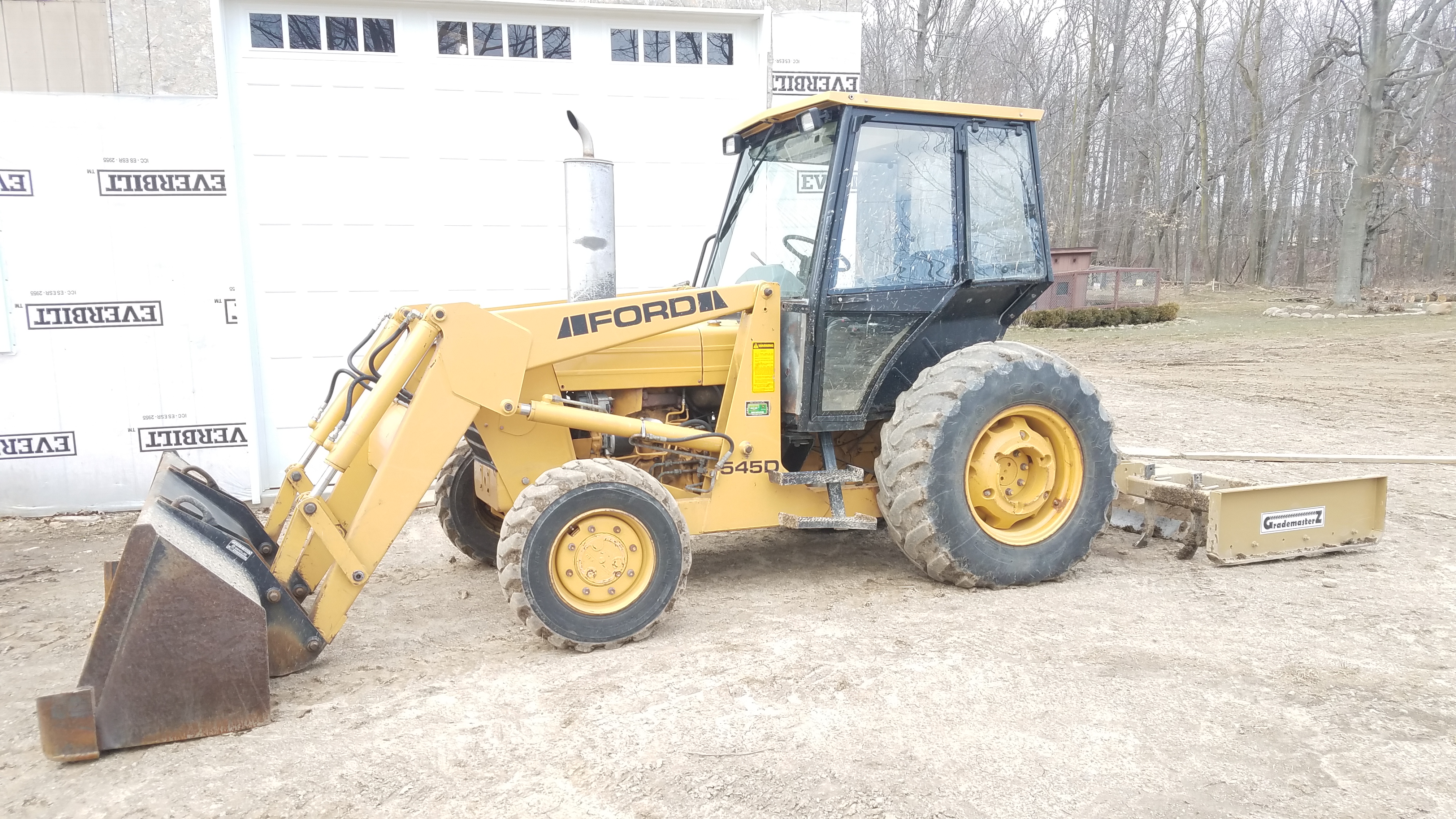

Well, she's here! So far so good! She's very clean... Although as soon as it warms up i need to spray her off, get the road grime and salt washed off. I will need to do a little bit of "rust-repair" on the cab and fenders, but it's minor. Considering the age and hours, she's in really nice shape. I'm especially appreciative that the paint is all original. I like that I can see everything on there with nothing hidden.
So far everything appears to work as it should! Seems smooth. I'll probably replace all the filters and fluids with something premium, just to be sure they're fresh.
Today I'm hoping to put the LPGS on her and grade the street. Won't be MUCH of a test but it will help me get more comfortable.
Anyway, here's some pics... And don't mind the barn, I'm still in the process of redoing it!

Sprayed her down and removed the cab-fenders. They'll need minor repairs, and I'll probably just remake them so they're not as bulky.
Hooked up the LPGS and graded the street. It definitely pulls better than my 4000 pound lighter Massey with 55 HP and HST. I could grade uphill in range 6 of 8 with the full contact of both of the blades of the grader digging in. I could grade downhill in range 7 of 8. I guess I could probably also have done downhill in range 8 of 8, but I felt like I was really lugging it.
I practice messing around with the torque converter while grading. Now it's starting to make sense. I could feel it when it locked in and I could feel it when it was released.
I also tried Shifting the speeds while in motion. I found that it didn't like to change speeds unless I kicked the shuttle lever into neutral. I could still change speeds while rolling, but again, it wanted to be a neutral to cooperate.
So far so good. Still going to take some time to get used to. As far as pulling the grader. I'm not so sure it was a night and day difference from using my Massey HST. Sure it pulled stronger, but I don't know if it would be enough to sway me to this machine over the convenience of the hydrostat. I think I'll notice more of a difference once I start using the loader. I need to order quick attach brackets 4 the machine, looks like I can get one for about 900 bucks shipped to me.
