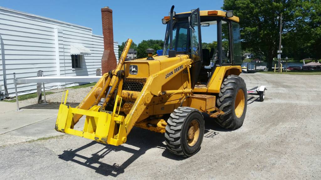

I've been reading this thread with great interest, because it seems like you got a sweet deal on a great tractor. I will add that I had Washburn make me a skid loader adapter for my tractor. The design is terrible, the quality is low, it took a month to get, but it was relatively cheap. I would not buy one from them again, but I don't feel like I need to replace it again either. My little deere 210 doesn't quite spec out as good as the 545 does, but I haven't been able to tear up this adapter or ETA 6K pro duty forks. I had to do the work on the bucket myself. 20180703_143258.jpeg

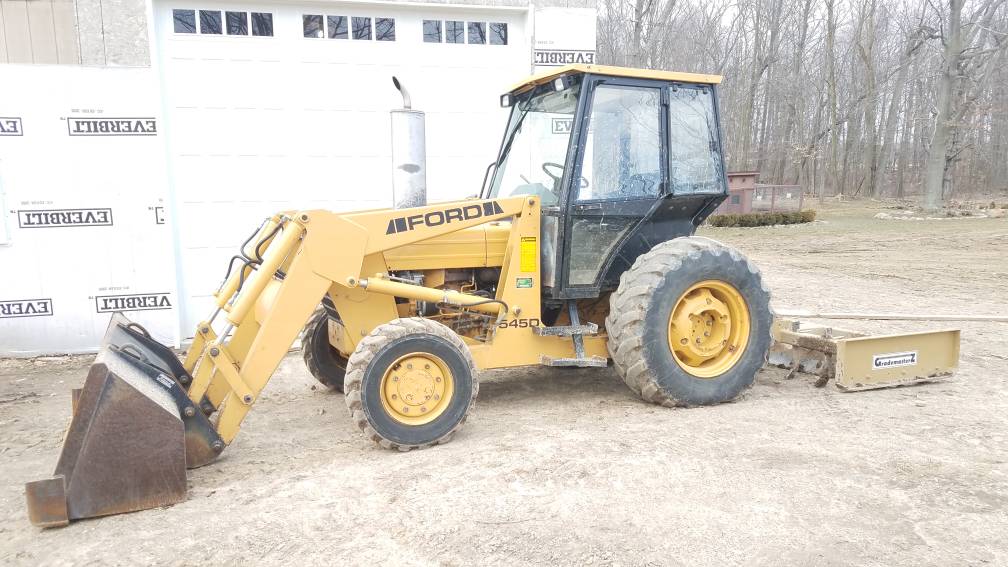

I haven't been back on this forum much because I've been so busy with work, so I figure I will update on this machine. I really like the 545d. It's tough, the loader is fantastic, the Hydraulics are smooth, and I feel like it would be very difficult to hurt this machine. It's probably the easiest starting engine I have ever turned a key on. Got a really low center of gravity and it feels very stable.
However, I just put it up for sale as I'm not using it as much as I thought I would, thinking about grabbing an additional skid loader instead. In the areas where I would be using this machine, the added strength and weight isn't enough to overcome the maneuverability of the smaller Massey with the HST. So I will likely keep the Massey and sell this 545d instead.
Here are a couple pictures to keep the thread alive. If anyone is interested in the machine, I have it listed at $22,500.
Don't mind the barn, it's getting updated with new siding this summer...20180410_155530.jpeg20180410_180828.jpeg20180410_083525.jpeg20180518_105017~2.jpeg
