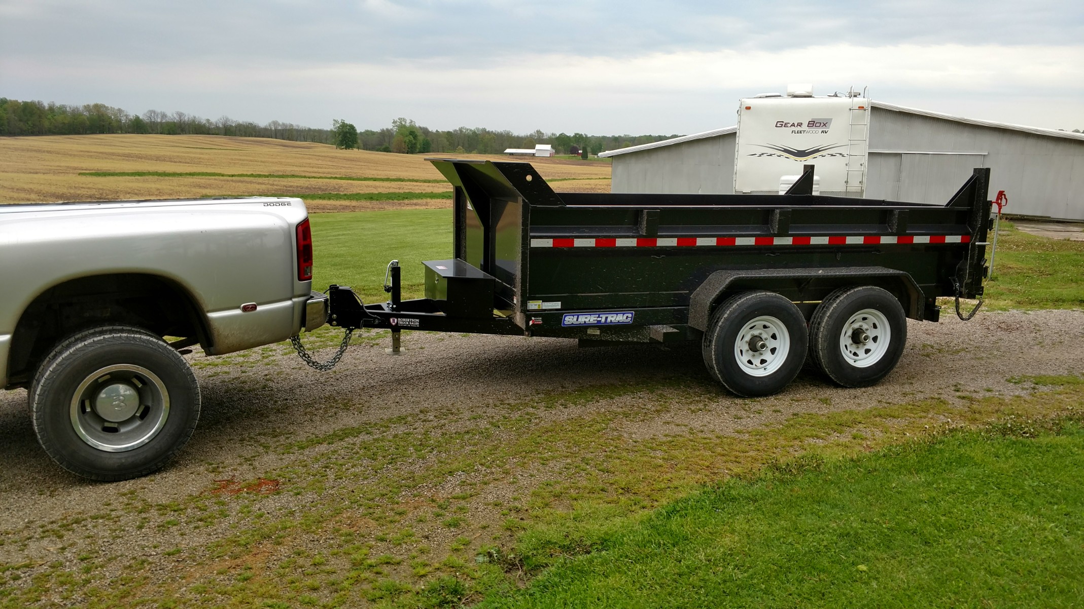

Yep, I am happy with the sure trac so far.
Of the 12 loads I hauled, before making the drive to the back of the property, I hit the lever to make sure it was going to dump before making the drive. One of the loads I had to use the backhoe and shove a little more to the back of the trailer. So all 12 loads I would guess would be near max capacity. Which i think is 8700-8800#. 12k trailer that weighs ~3200 and change. 8-10 scoops from the backhoe bucket at ~1000# each so the math seems to work out about right too.
This is why I had issues with the other trailer. I want something that is gonna dump what I put on (within reason). Because hauling firewood, dirt, rocks, etc aroun my property...I dont have scales. No idea what things weigh.
On a side note, when digging the goldfish pond (gonna have to post pics of that but will start another thread)...Once nearing the end of digging I started piling dirt for the mound where my waterfall was going to be. But knowing I would still need more dirt to dress up, the 13th trailer load didnt get hauled and dumped. Rather parked and wheels chocked. Well, I am glad I went to the 7' trailer instead of 6'. Because my 6' loader bucket on the MX fits between the insides of the trailer and I can scoop dirt a little at a time directly out the back as needed:thumbsup:

Did you or will you raise the dump up a bit before unloading some material from the back? O will you just pull some back with the hoe to get it to dump when finished pulling material off? Just wondering. Jon
/ Forest River Dump trailer
#65
Didnt at first. Because there were 2-3 scoops I could get just by opening the barn doors. then I had to raise the dump a bit to get the rest to slide to the back
