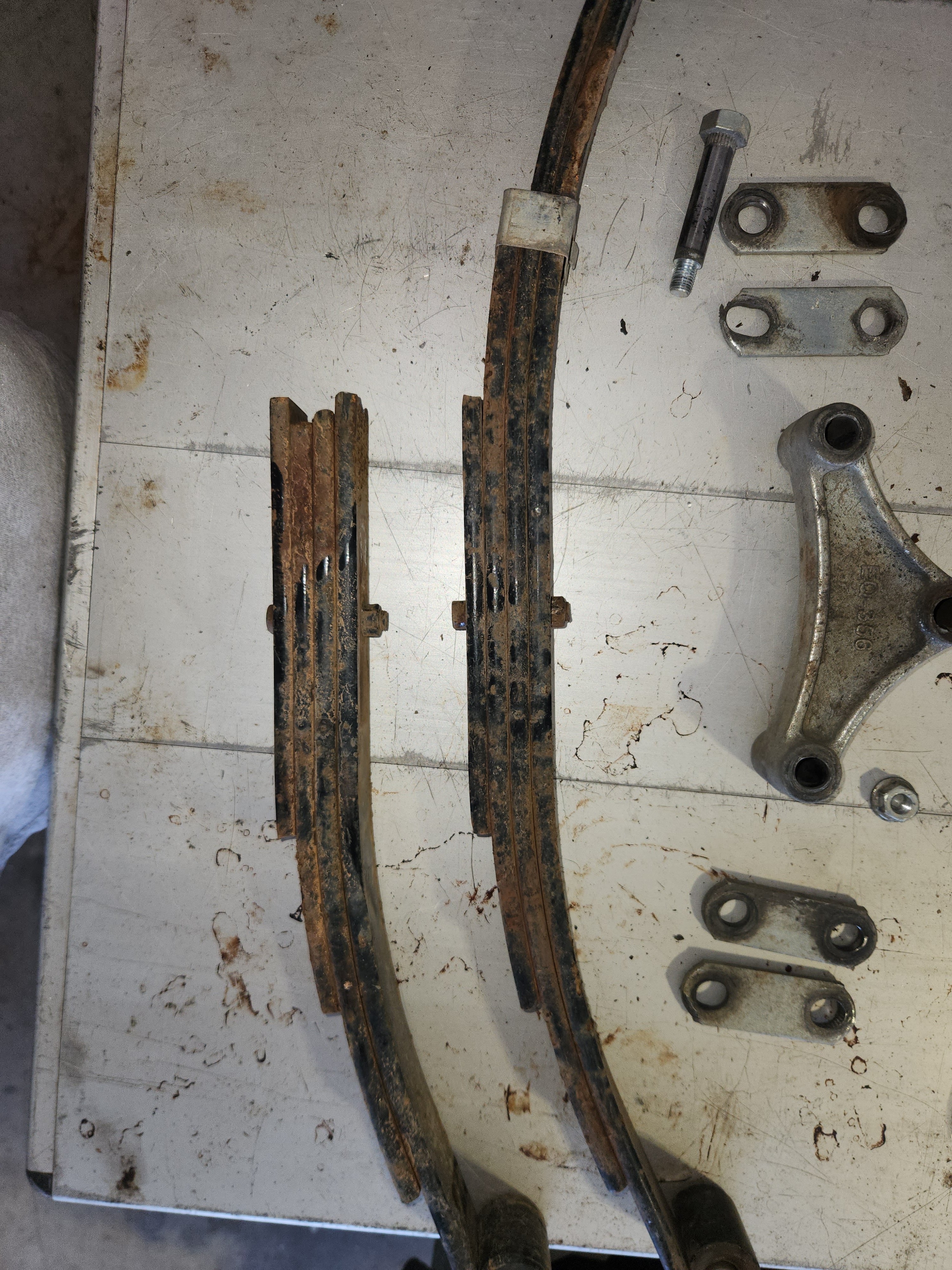

I have a Griffin 6x12 Dump trailer I purchased new in June 2024.
Updated pics to show trailer rating
The battery lasted about 3 months
The tires lasted about 4 before they were coming apart.
I just broke a spring last week, not covered by warranty.

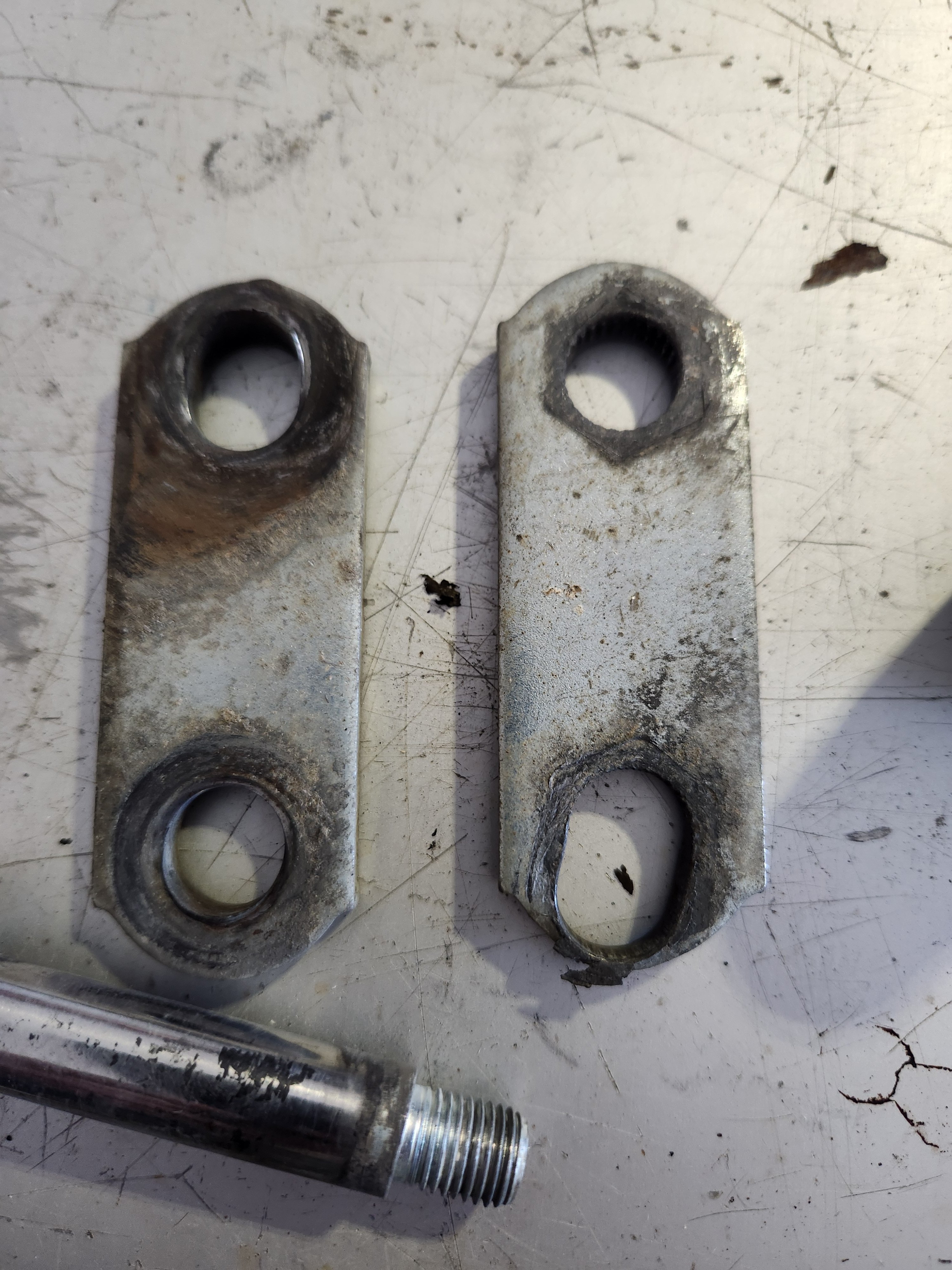

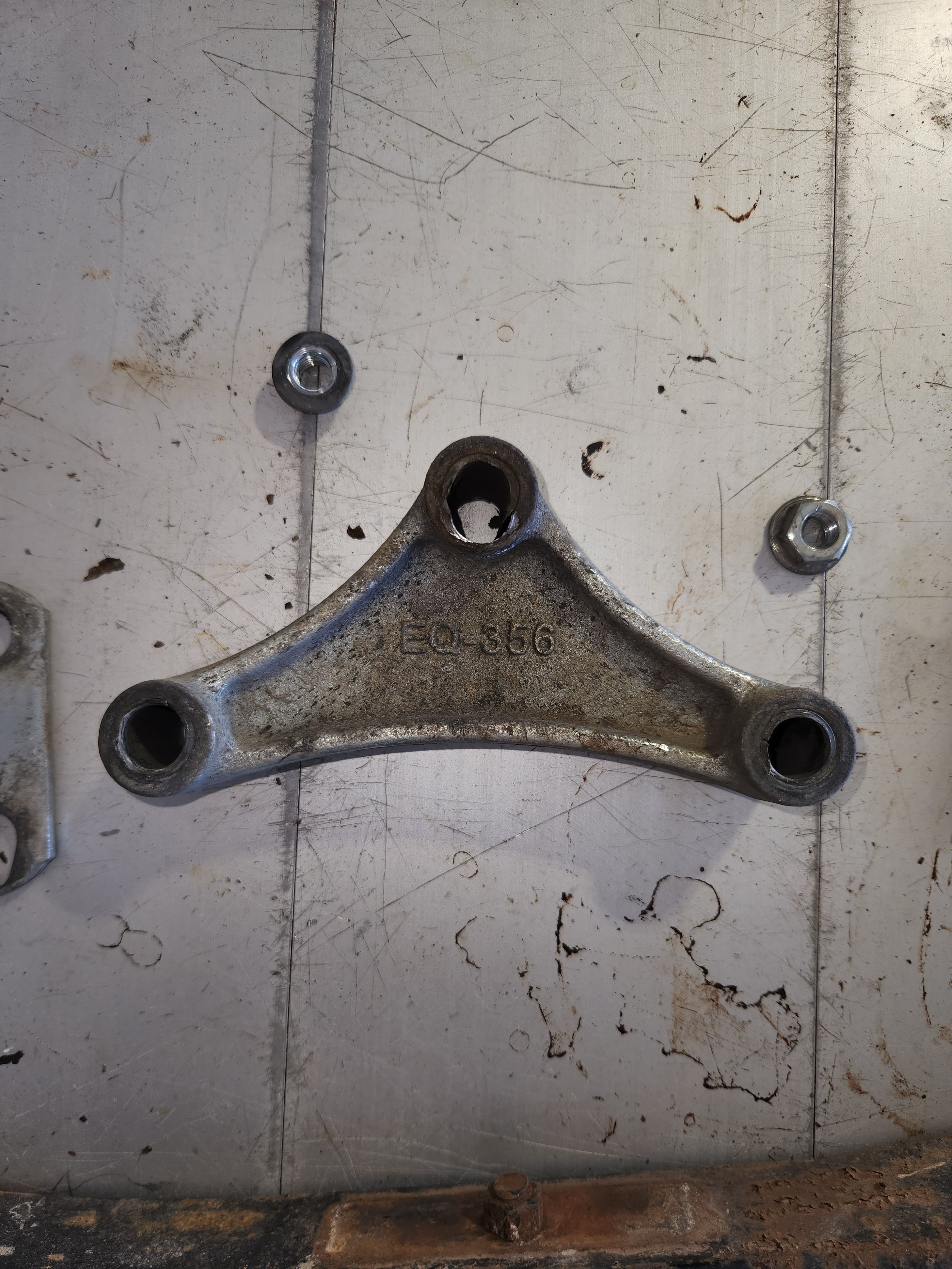

I took the suspension apart and found the bushings had all failed, the equalizers are worn out of round, the links are also worn out.
Are these made as though most people would not actually use them much?

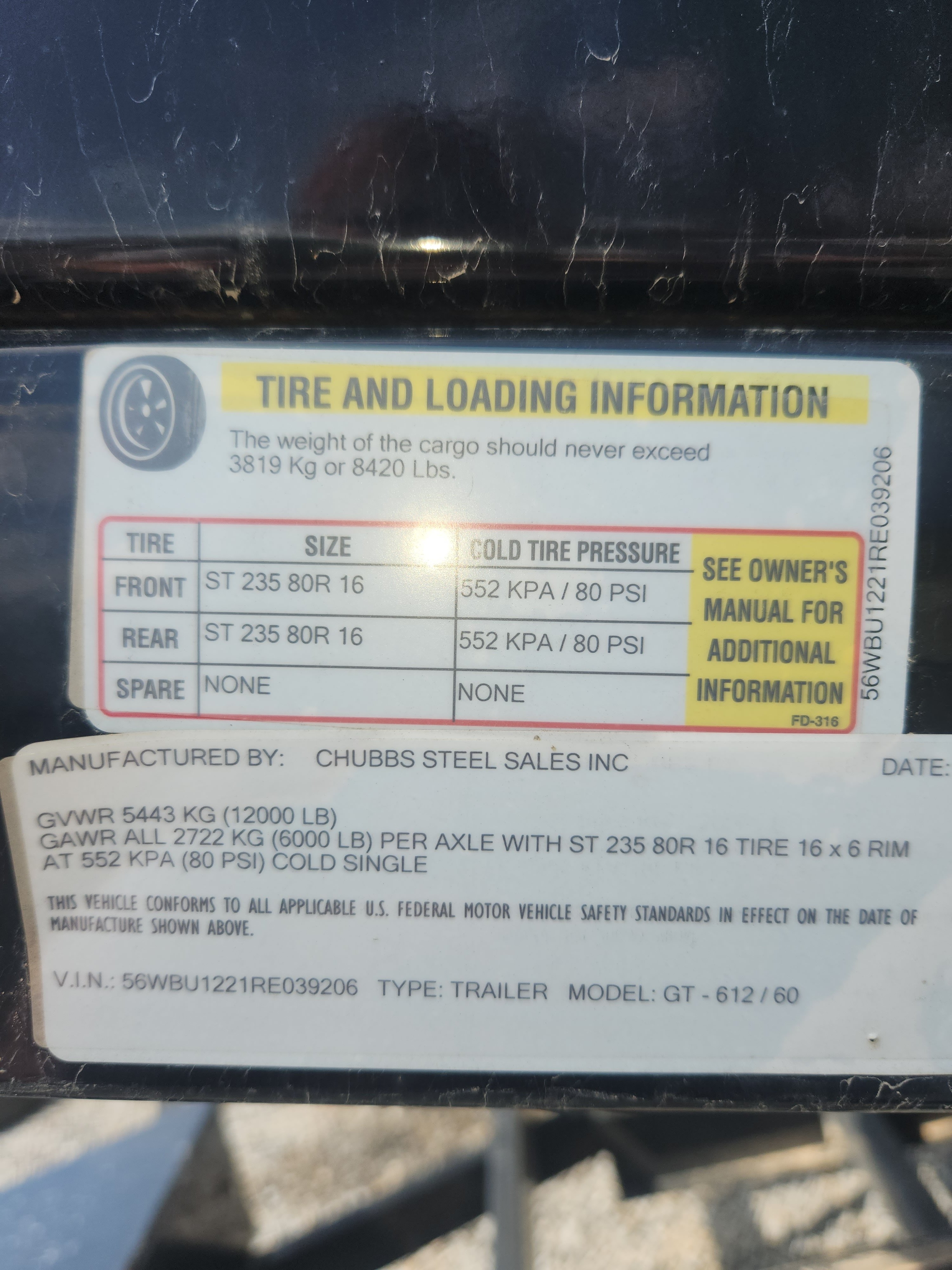

It is rated to haul 8K. Most of what I have been hauling is gravel I have bought at the quarry. They weigh in and out, so I've only been over 8k a couple times by a few hundred pounds.
The tires that came on it had a max rating only a couple hundred pounds more than the loaded weight of the trailer.
As I pull it apart, I see all plastic bushings and no greasable bushings.
I will be upgrading to brass and greasable.
I have no complaints on the actual trailer and hydraulics. My issues are the light duty tires and suspension components.

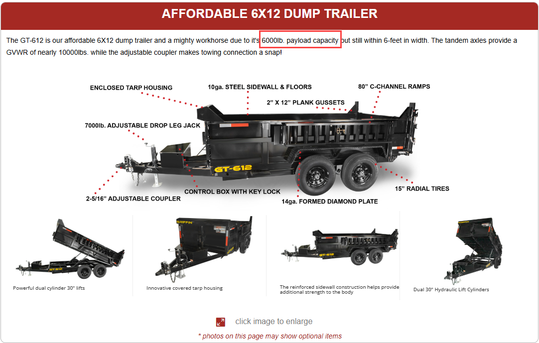

I think most trailer manufacturers spec the cheapest components that will carry the rated load, nothing more. I don't know what you were sold, but you might want to recheck the rated load capacity. The capacity I see on their website for the GT612 6'X12' dump is 6,000# load capacity. I don't see an option to upgrade load capacity, just a jack increase from 7,000# to 10,000#. That might account for your excessive wear. Also check the load rating for the tires. It doesn't list a rating on the website, just 15" radial tires, but they may have been Load Range D 8-ply tires. That would barely cover the GVWR of 9,990# with 6,000# of payload weight. If that is so, I would up that to a Load Range E 10-ply if it were my trailer.
HOLY S%^&, thats some criminal trailer design right there. A 6x12 dump trailer can easily be loaded with DOUBLE that much weight.
To the OP, if you really bought a 6k rated 6x12 dump trailer without realizing it, well first of all I am sorry. but second of all, c'mon.

Any dump trailer can easily be overloaded. I've never seen a 6x12 dump trailer that is rated to haul 12,000 lbs. But, you have a good point. The OP bought a trailer from a company that specifically advertises that it's products are cheap. "Affordable" and "inexpensive" is all over the place on their website. When it comes to trailers, you often get what you pay for.

Time to bore the equalizers and rebush with 660 CA bronze alloy bushings, cross drilled for grease fittings and the outer links need to be remade and bronze greaseable fittings installed there as well.
All trailer builders go with the least expensive components to glean the best profit margin. Plastic bushings don't work on ANY trailer, least in my opinion but that is what you most always get anyway along with no grease fittings.
Had that issue with my Kaufman goose neck and redid the suspension myself plus I added triangular gussets the the outboard spring hangers to eliminate any twisting of the hangers when making tight turns with the GN loaded or overloaded as the case may be.

I'll never for the life of me figure out why they put nylon bushings in those shackles and equalizers. My $60K RV had them. They were gone in no time. I bought the MoRyde bronze bushing kit for mine.

That might work as long as they're not the cheap cast iron equalizers.

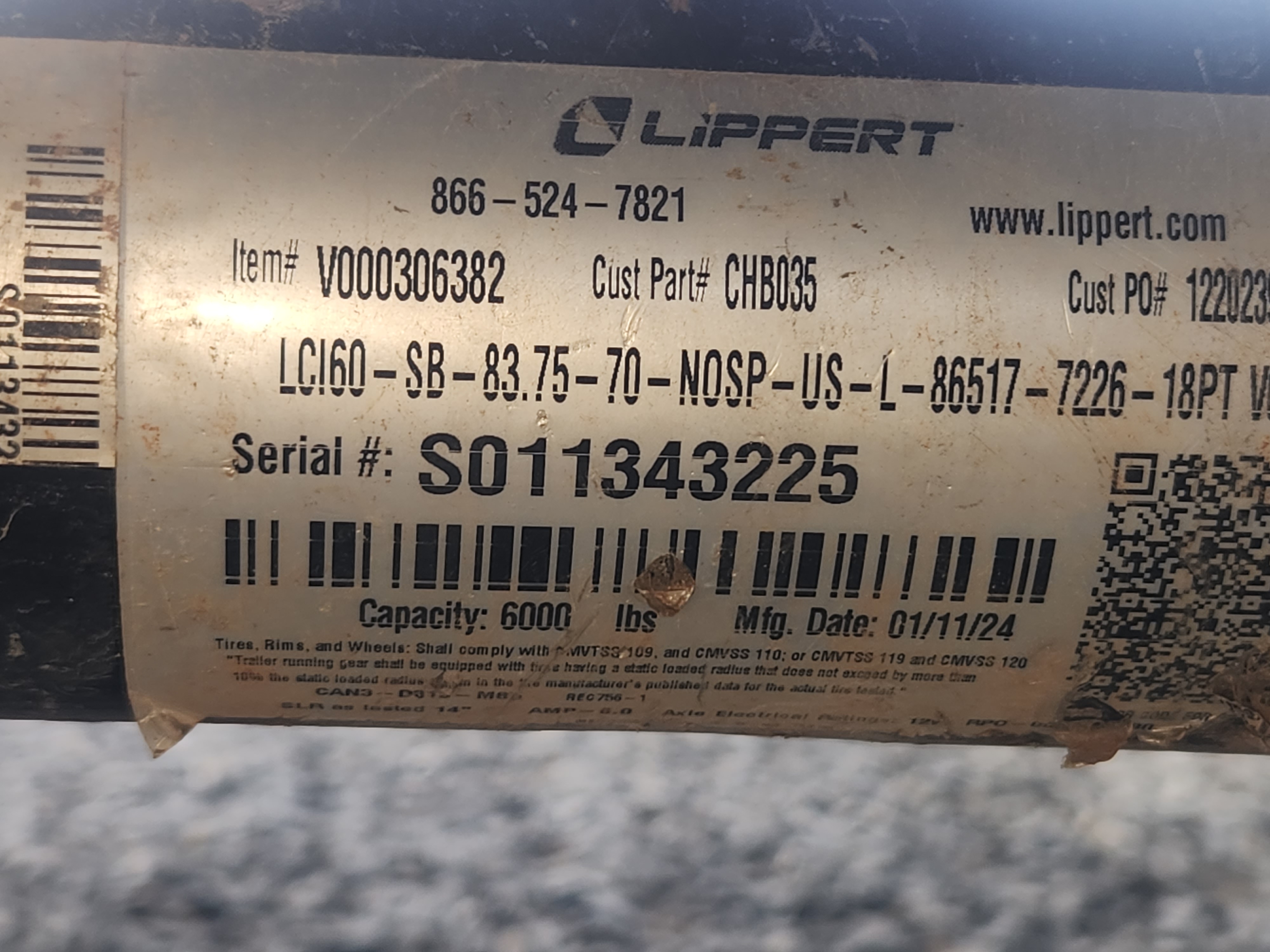

6410 payload listed in the chassis specs below the picture. But well under the 8K the OP was hauling.

No, it's got 2x6k axles, rated for 8K payload. The sticker on the trailer also says so.
I am guessing they de rated them after poor performance.
