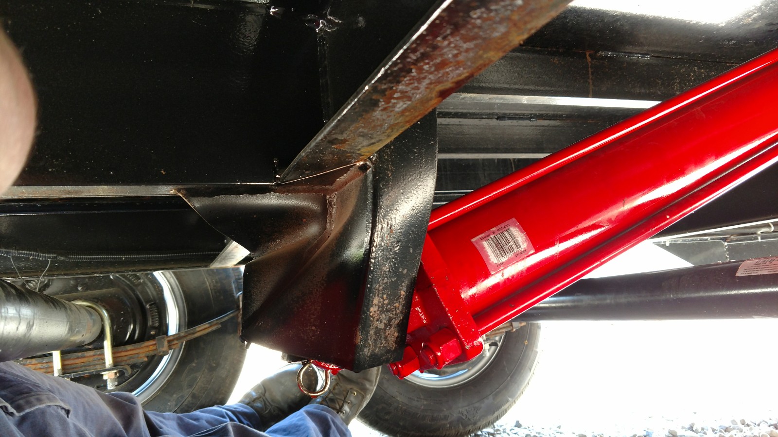

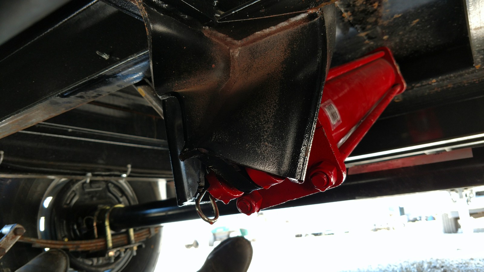

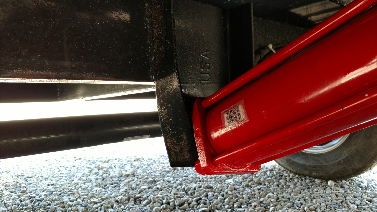

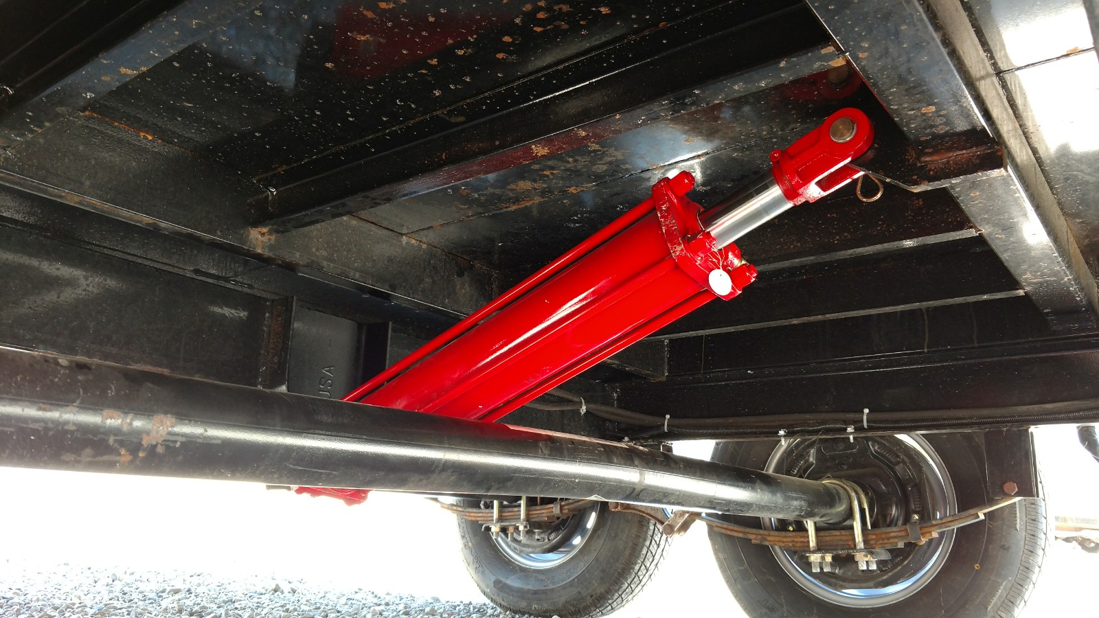

Bought a sure-trac 7x12 12k. Untested yet. So time will tell.

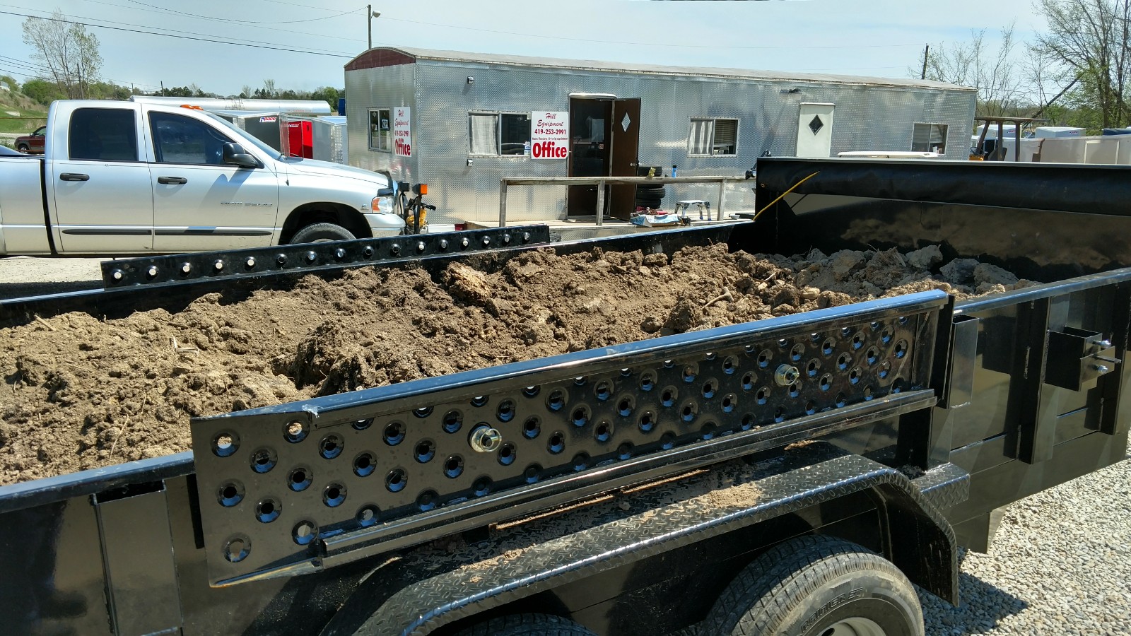

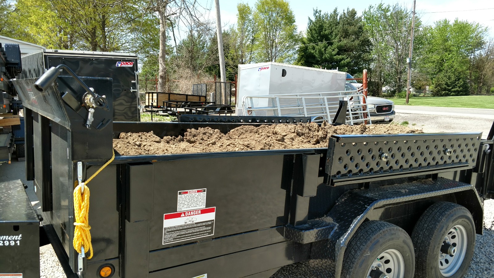

So far it works well. I dug a goldfish pond in front of the house a had to get rid of alot of dirt. (haul to the back of the property).
Parked it beside where I was digging so I could load straight from the backhoe rather than have to scoop up spoil piles later.

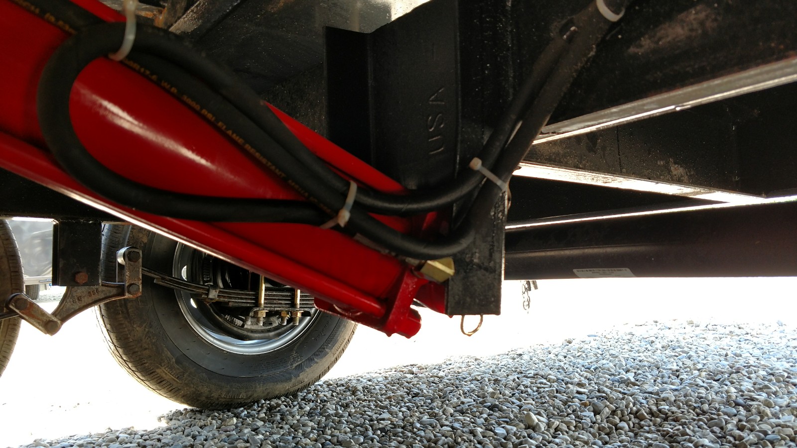

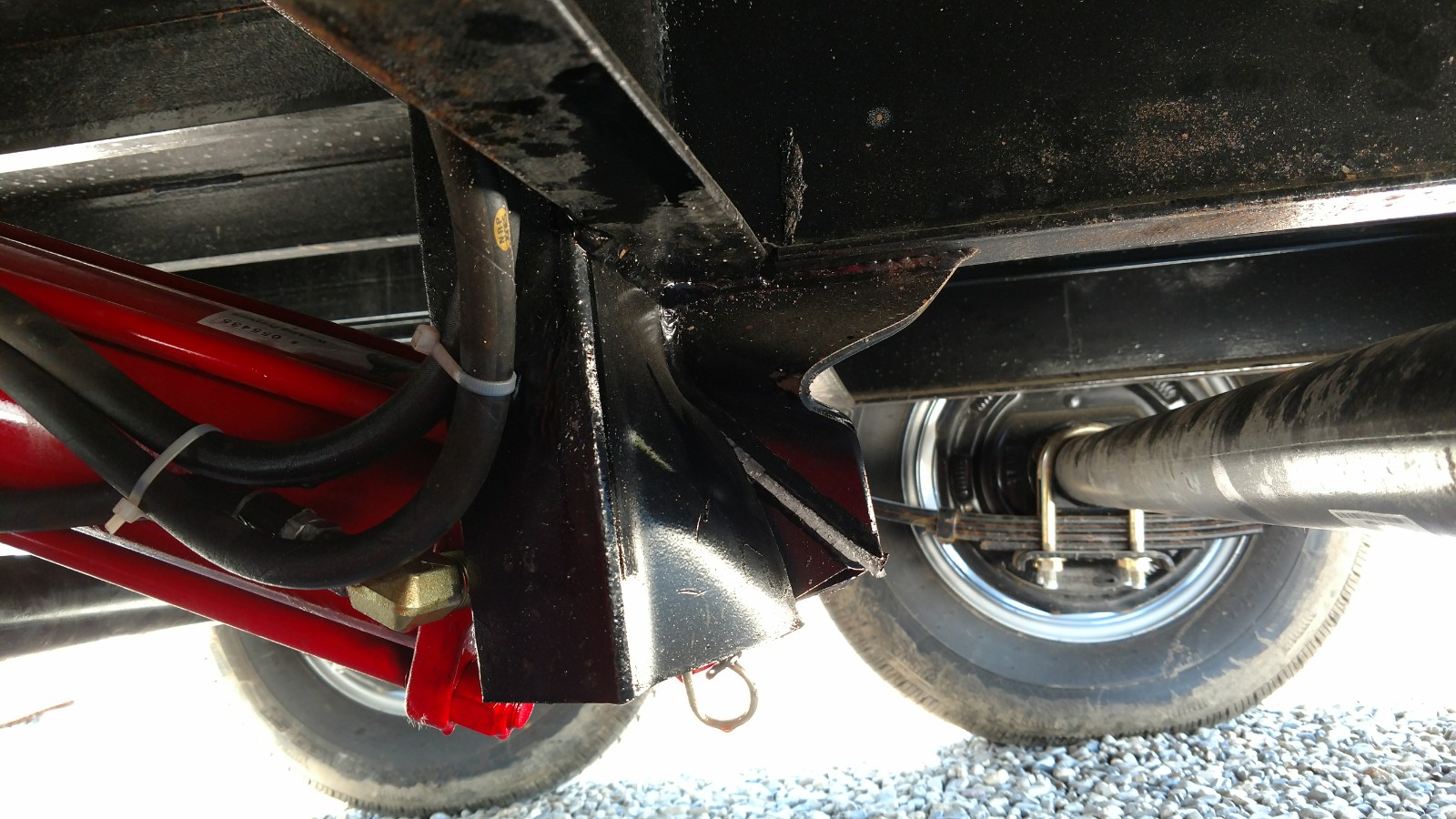

8-10 scoops per load. No issues dumping. Hauled 12 loads. Best thing was I didnt have to get off the seat or even drain the battery. Where the hoses hook to the pump, I put quick couplers on there. Then some hoses/adapters to run off a remote on the tractor.:thumbsup:

FWIW, the battery on my dump lasts at least 21 cycles (over 1.5 days). My charger said 55% charged when I hooked it up (not sure what that mean in terms of residual cycles).
Not a concern for you but, so far, I have not felt the need to bypass the on-board pump.

Dont know how many cycles a charge will last. Is your trailer power up and down both? Or just power up? And alot depends on battery size, and how heavy the load is.
But wasn't just about battery preservation. For $80 worth of hoses and couplers, the cycle time is at least twice as fast, and not adding any wear to the expensive pump unit, never have to worry about battery charge, and dont have to listen to the pump whining.
