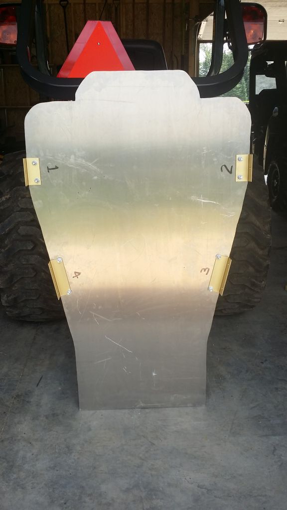

I'd owned my MF 1529 for just a few months when I realized it was only a matter of time before I snagged a hydraulic hose, fluid line, or control linkage on the underside of my tractor. I stopped by the local metal shop and bought a sheet of 1/4" aluminum to make a skid plate. It was easy enough to do and certainly worth the money spent.

I checked out your site. Looks like a nice installation. How long have you had it installed, and how is it holding up? Anything you'd do differently, if yo were doing it again?
I do wonder a bit about the dis-similar metals (aluminum against steel) causing some corrosion issues, but the paint may give some protection? However, the aluminum certainly is nicer when I comes time to remove and re-install. My belly pan is 1/2" steel. I have to think what it will take if I ever have to take it off. (Fortunately, the access holes are already installed.)
Those rear brackets that you were thinking of, but didn't get to due to restricted access might be something to consider if you ever have a rear tire off. It might not be needed, but it's some extra insurance that you won't catch and bend things when backing up.

This summer made the 4th year that the tractor skid has been installed. So far, so good, no issues and I wouldn't change anything. This is not the first 1/4" aluminum skid I've made, having done one for my Jeep Wrangler some years ago. Of course, that one saw much, much more abuse than this one on my Massey.
I enjoy the lighter weight compared to steel. I've had the skid off a couple of times since installing it as I need to pull it to do engine oil changes. When I pull mine, I put a rolling floor jack under the middle of the skid, remove the mounting bolts, lower it a small amount, and slide it out of the way. Easy to do. I haven't seen any dissimilar metal corrosion issues and for what it is worth, and I didn't have that issue on my Jeep either. Having that vehicle in Arizona where things were extremely dry might have made a difference too.

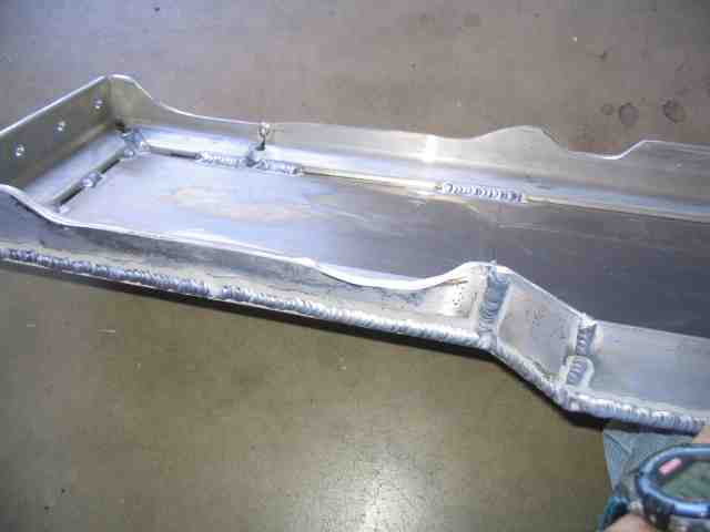

1/4" aluminum will hold up very well to off-road abuse, be it from a tractor, ATV, or a Jeep. One benefit is the ease of drilling holes. Of course, if you are going to weld, a TIG is the way to go. When I moved, I lost my access to that which is why my brackets are bolted onto the tractor skid instead of welded in place. We make do with what we have, right?

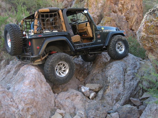

Here is a typical trail in Arizona that my Jeep would find itself on.....in this case, my aluminum gas tank skid is supporting the back half of the Jeep. Plenty strong and did the job very well.
That picture reminds me of a trip we took to Moab Utah 2 years ago. Me and the grandson went on a jeep ride like that, as passengers of course. I had never seen or imagined anything like that in my whole long life. I found it amazing that you could set up a vehicle so that it could go the places we went. Talk about pucker on those high canyon walls.

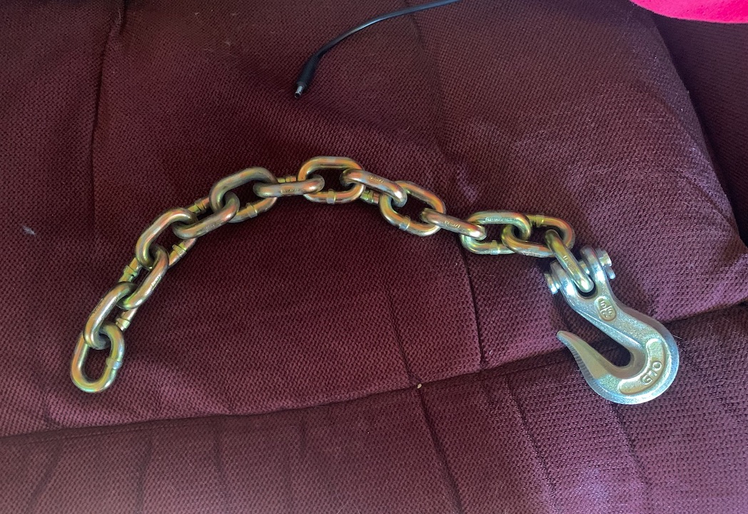

I prefer a hook on the end of my cable. It gives me more options. Sometimes you just want to hook up quick and not mess with a key hole or you want to hook onto a chain that has no free end that will go thru a key hole like a couple chokers I have with a grab hook on the end so I can make then into a long choker or a chain on a car stuck in the ditch. Or maybe you have a choker whose free end is stuck under the hitch you just dropped. Put the hook on it and drag it out from under as you as you leave. This is just my preference and why. On the other hand one of those key hole cable end fittings that Hud-Son carries makes a nice clean cable end. Way cleaner than a hook and 3 clamps. And you can get a hook by adding another chain in the key hole. So it all come s down to personal choice.
I definitely prefer the keyhole on the end of my cable, but 99% of my use is attaching chokers to pull out a log. My winch came with a hook on the end, but after having the choker pop out of the hook one too many times, I decided to replace it with the keyhole fitting shown earlier in this thread. It's a claner connection, with less stuff to catch your hand, and the choker is far less likely to become unhooked.
It does limit the uses, however. For example when pulling a car out of a ditch, or when I need to add a chain for that extra 20' of reach, you are limited to what you can attach to a keyhole. (All of my chains have hooks of one sort or another on both ends, so won't go through the keyhole.)
I finally got around to making this up for myself. It stays hooked to the side of my bucket full of various chains, or hooked to the safety screen on my winch until I need it. Attach it to the keyhole on the end of my cable, and I now have a hook. Thanks for the suggestion, Gordon, even if it did take me a year to get around to following up on it.

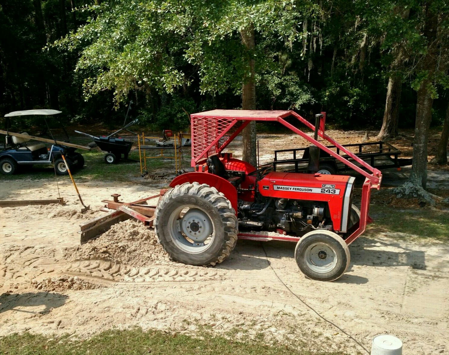

Forestry Mods???
None of that here....:laughing:
Looks like a nice set-up. I can see limb risers and the cage above and around the operator. I suspect you have other changes that are not so obvious in this photo. Is there a belly pan, or a grill guard? Other things I'm missing?
