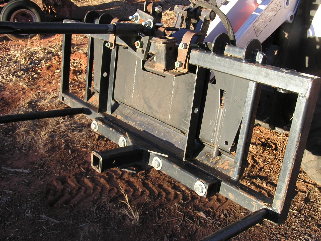

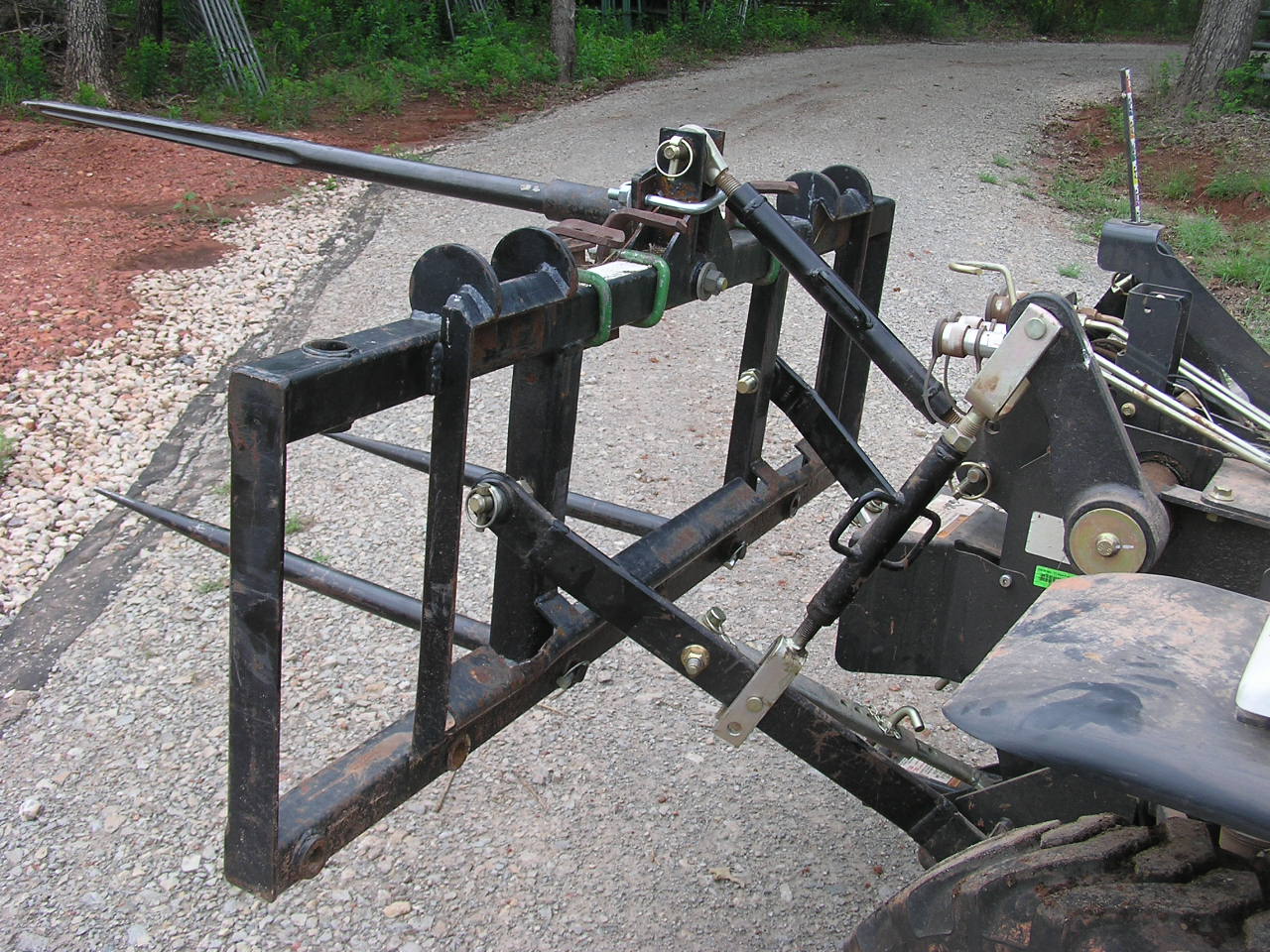

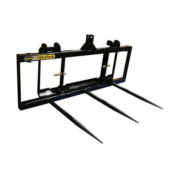

I took it as wanting to use on the front or the back. The build shown in this thread has a Euro (I think) mount AND 3-point tabs on it. So it can be used with either. Crystallake (nor I) have ever seen a similar setup only with SSQA and 3-point tabs.
There have been some threads about home built fork frames that fit either end.
The one I have isn't pallet forks, it is a Speeco UltraFork, but the design would work for pallet forks.

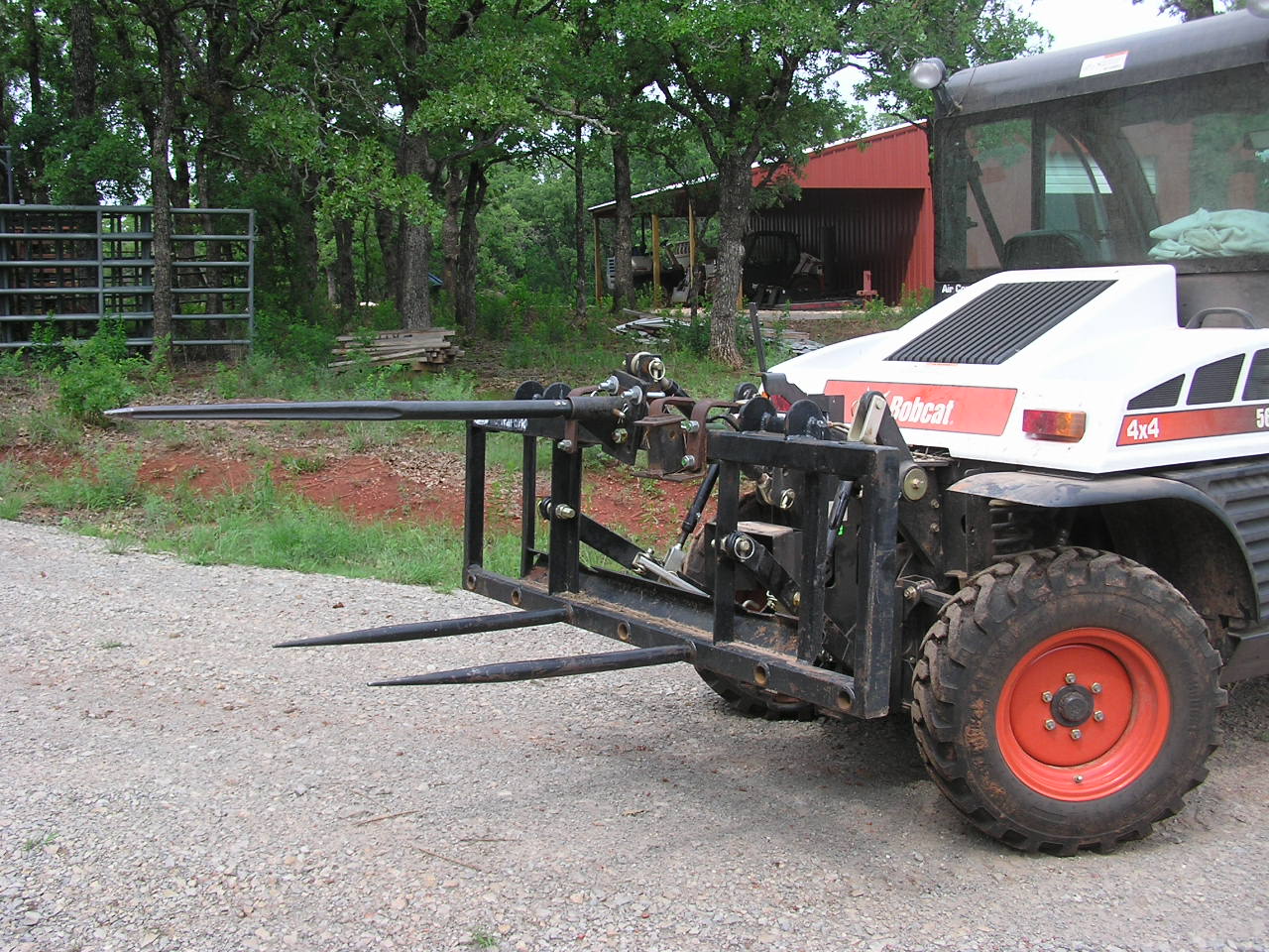

I like it.
I have a set of (claimed to be) Bobcat brand forks. The visibility is AWFUL on them. Beyond that, the guarding is all bent up. I was planning on cutting it off and rebuilding the top guard section to be like EA's or Tomahawk's forks. This could be integrated in pretty easily, I think!
