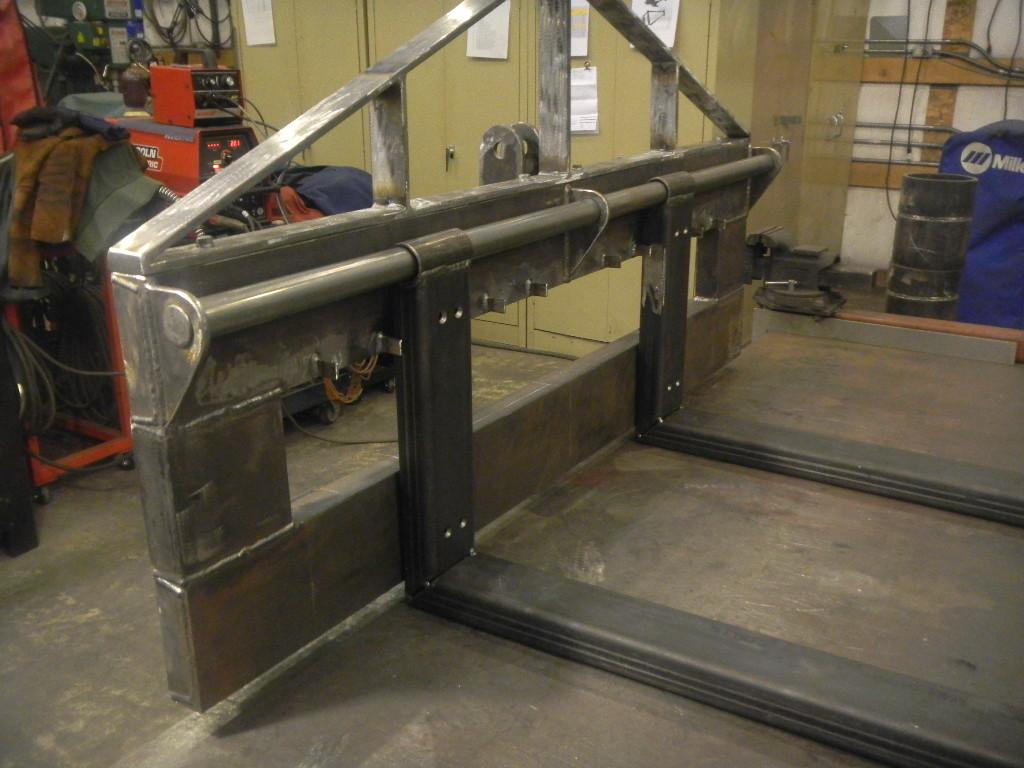

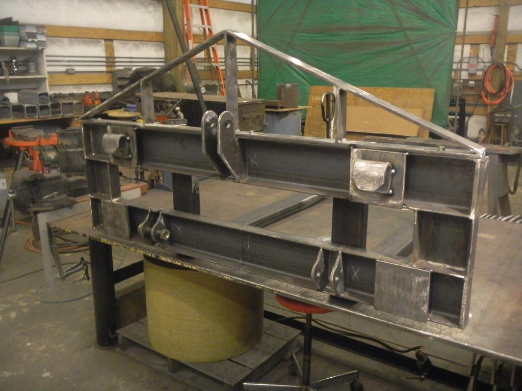

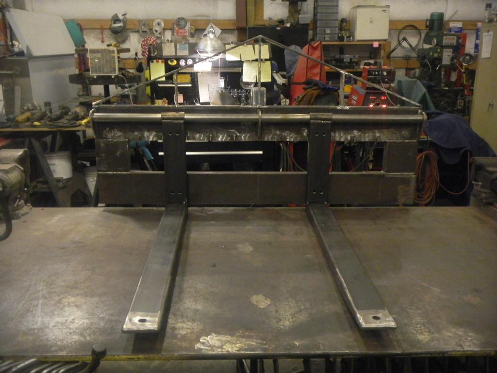

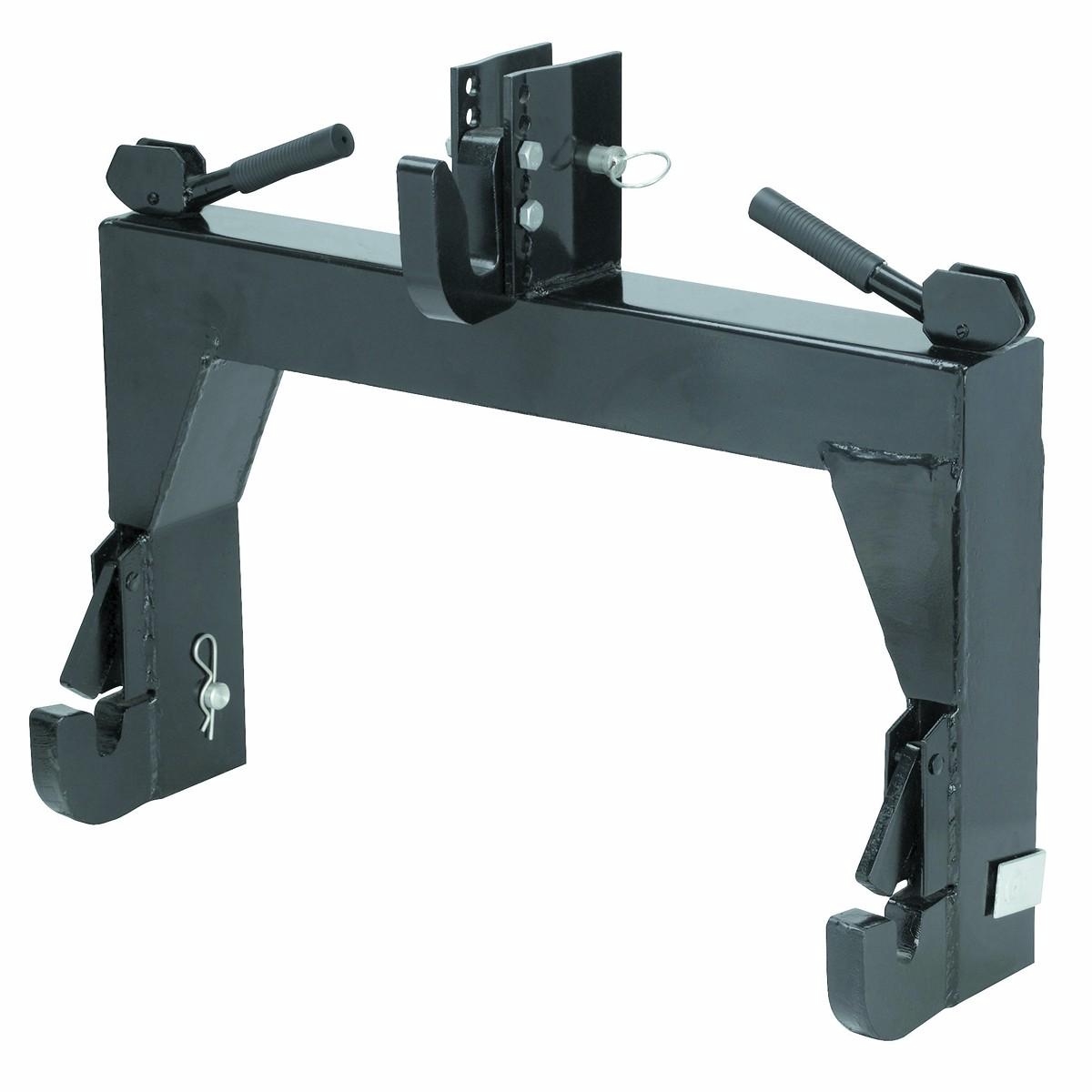

Well, what do you think?
Welded little tabs to the frame so the forks don't bounce all over the place. Had to make new upper pad eyes on the upper back. I forgot he has a quick hitch.:eek:
Pretty much done, just need to do a little clean up. Will weld it all up once I hook it up to his tractor to make sure every thing is going to fit / work.

   / Fork attachment build. #54
Beauty !!!!
Maybe use your existing bridge type bracing to incorporate a full see through backrest?? Using same width flat bar placed vertically?
If you go that route, I like to place the center bars straight (perpendicular to machine) and the ones on each side slightly angled for better see through vision from tractor seat. Terry
Edit: refer to my earlier photo showing ugly primerd 'back rest'.

Terry I'll leave the customization to my brother-n-law. He has forgotten more about welding / fabrication than I'll ever know.

Turned out nice.
The way you did the bar inside to beef up the heel is nice. Not what I was picturing based off what you were describing. I thought it was only going to be inside the horizontal and stop at the heel. What you did should.make that heel area a good bit stronger.
