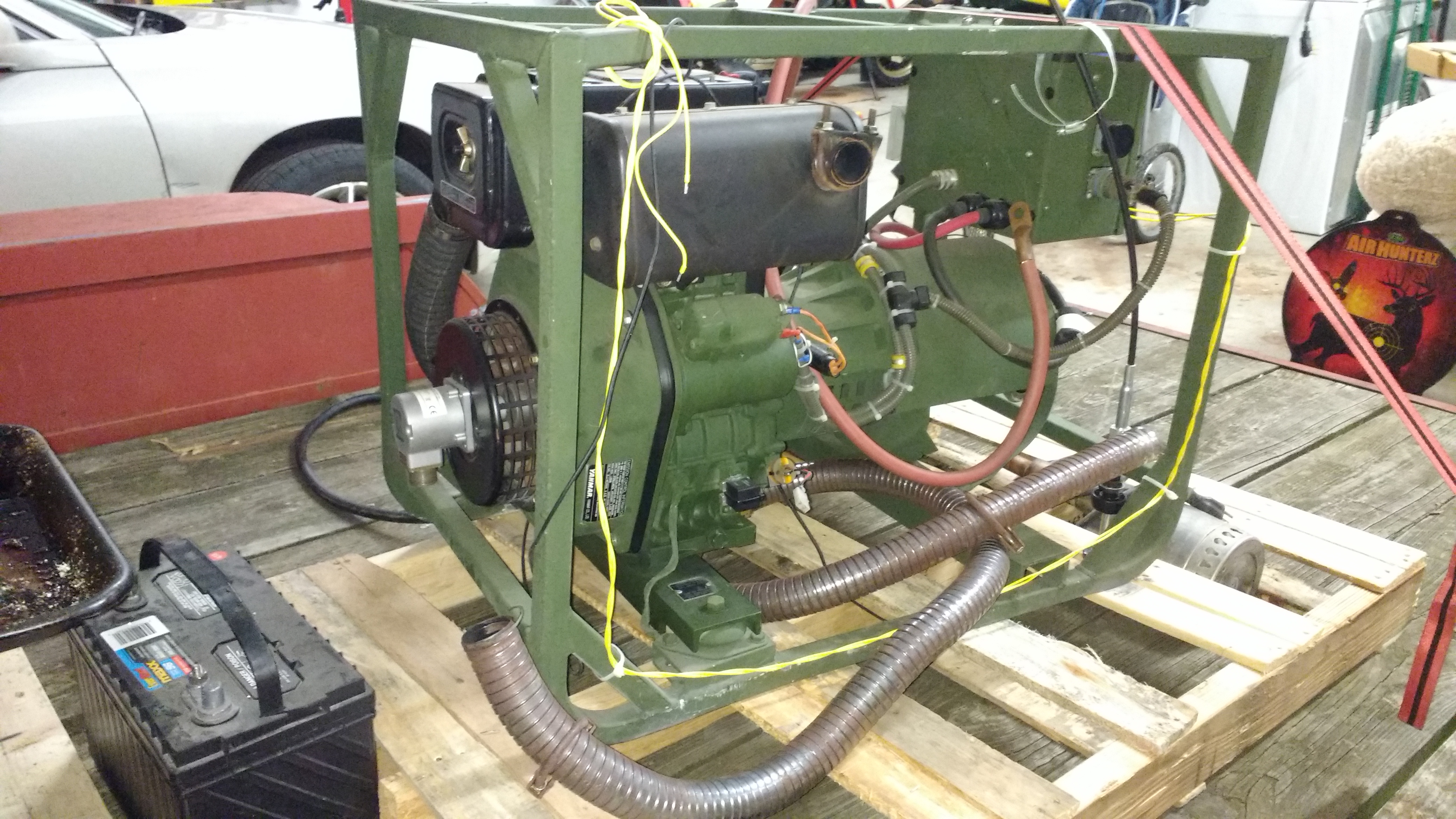

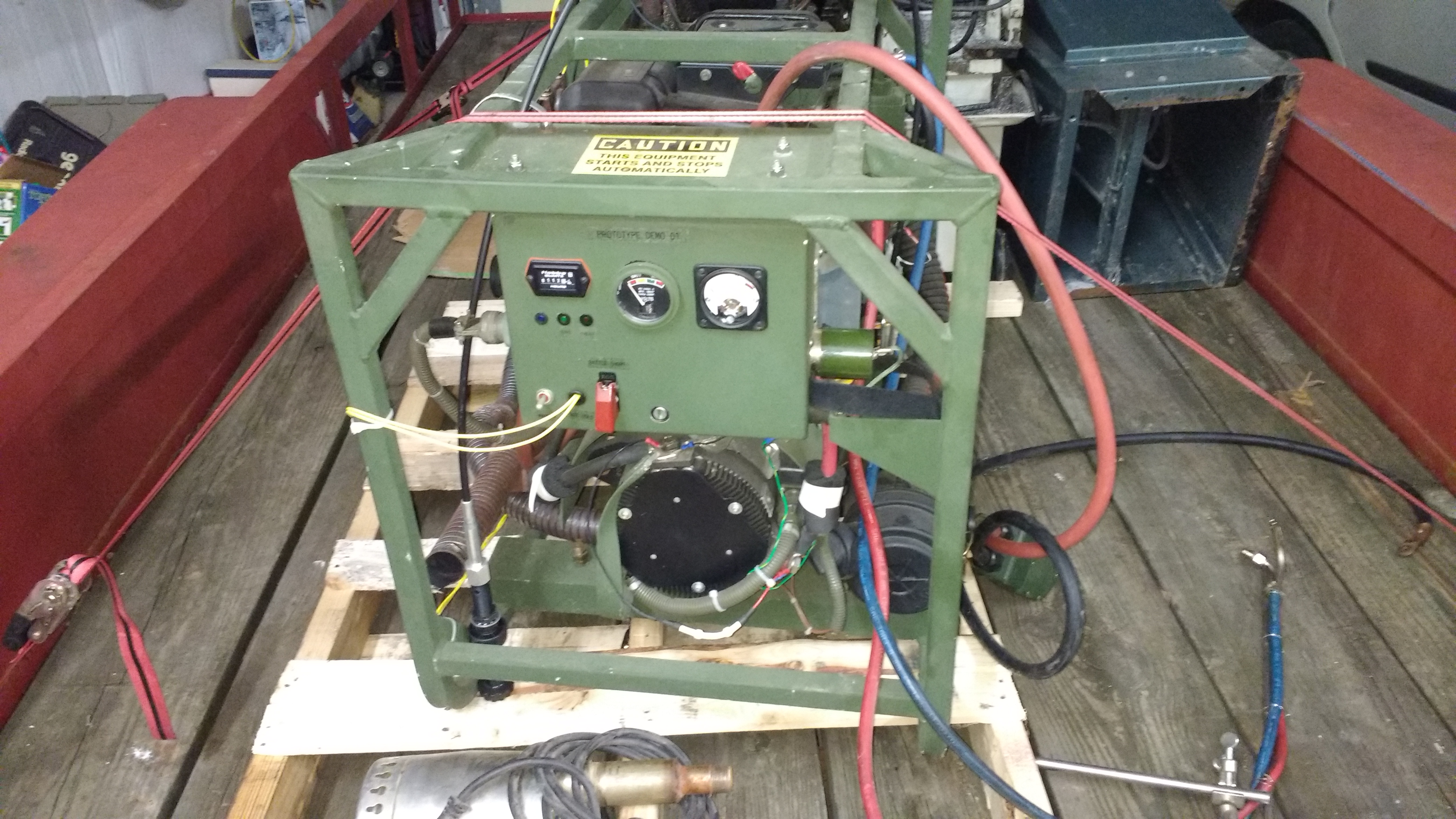

I just acquired a military style Yanmar genset with an L100 engine. It puts out I believe 28volts dc and is designed to charge, and auto start and backup a set of batteries.
Anybody need anything like this?

I just found this thread and wanted to post to subscribe.
Sounds interesting how about some photos & details.

Trying to post pics, but phone is acting up.
