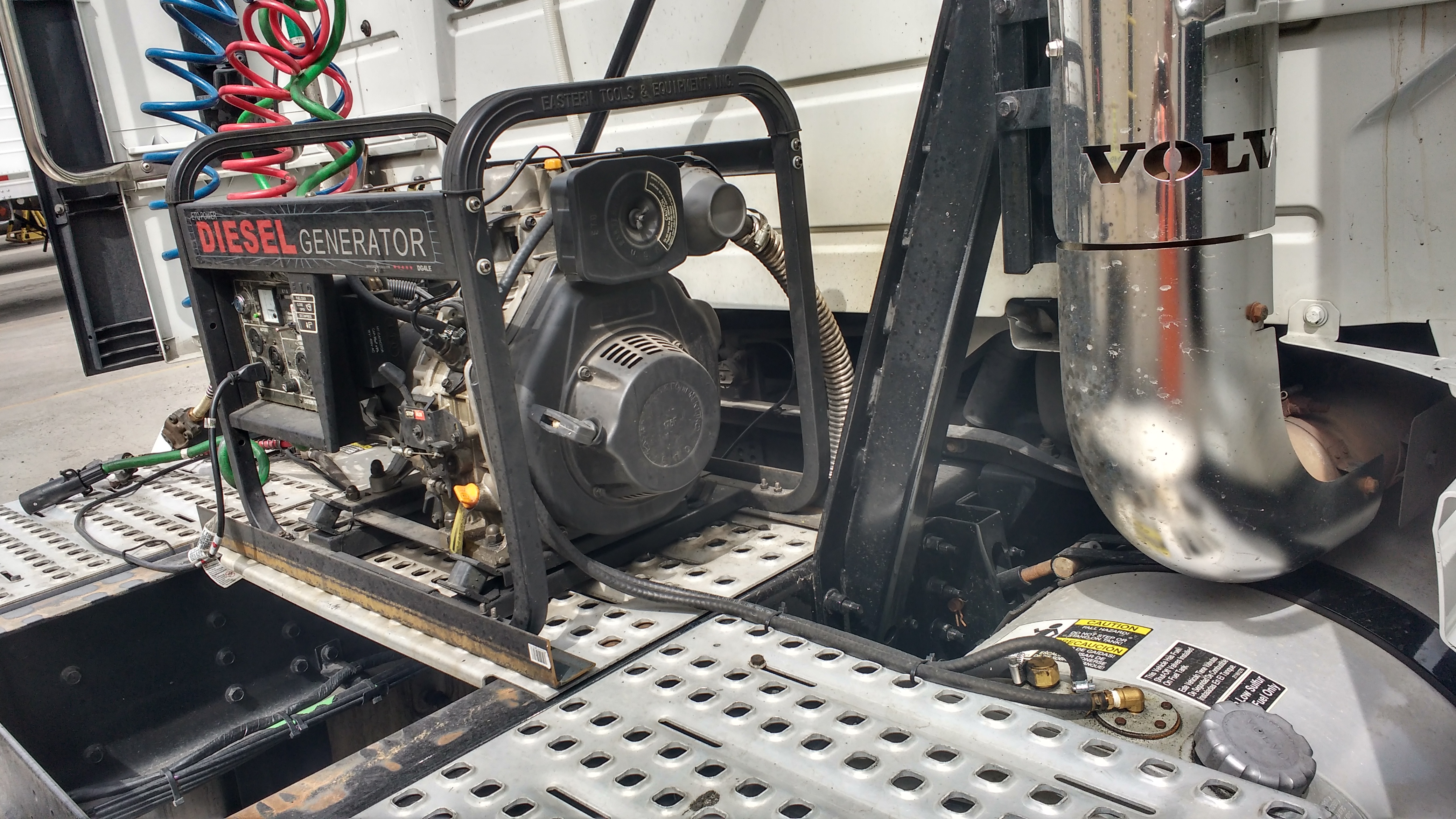

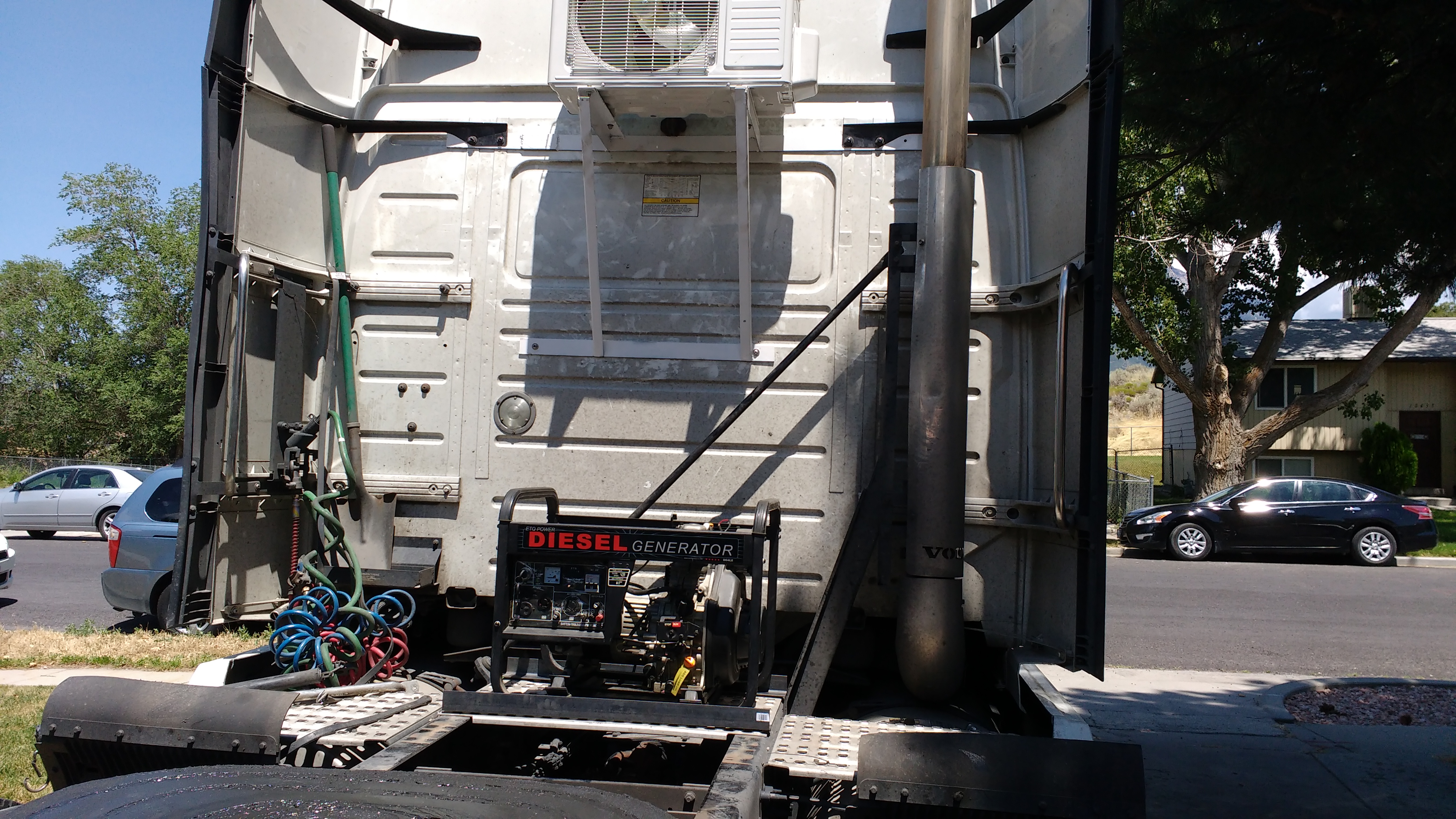

Last summer I started project on my truck to make auxiliary power unit with ETQ diesel generator with 178F engine.
AC unit was installed, the generator was plumbed to the truck fuel tanks and can run continuously long time as a nuclear submarine. Everything was working perfect if not count some problems with wires and 12 volts charging circuit. Engine control board is looks like toast but engine is running. Only one inconvenience was you have to get out to start or stop generator. This year I decide to install new generator control to have engine protected at best( oilpressure, temperature, RPM) and power control to protect the electrical devices from overvoltage or undervoltage. Smartgen MGC 100 is my choice.
First I did install fuel pump with solenoid from 186F engine to be able to start and stop engine remotely. Some timing adjustment was done but now it acting up when power consumption is low. Engine start farting like missfire. No smoke. Voltage is going down to almost zero then pickups by itself. If generator is loaded it running good. Is fuel pump interchangeable 168F with 186F?
Appreciate any advise.
