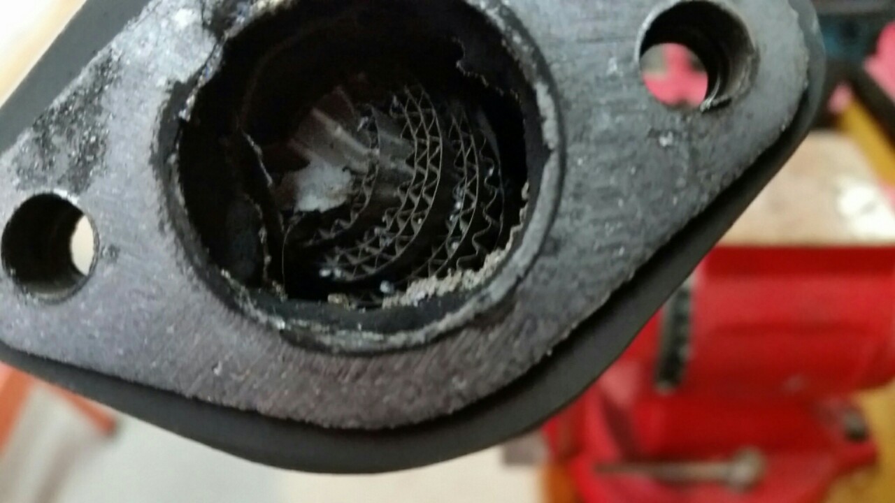

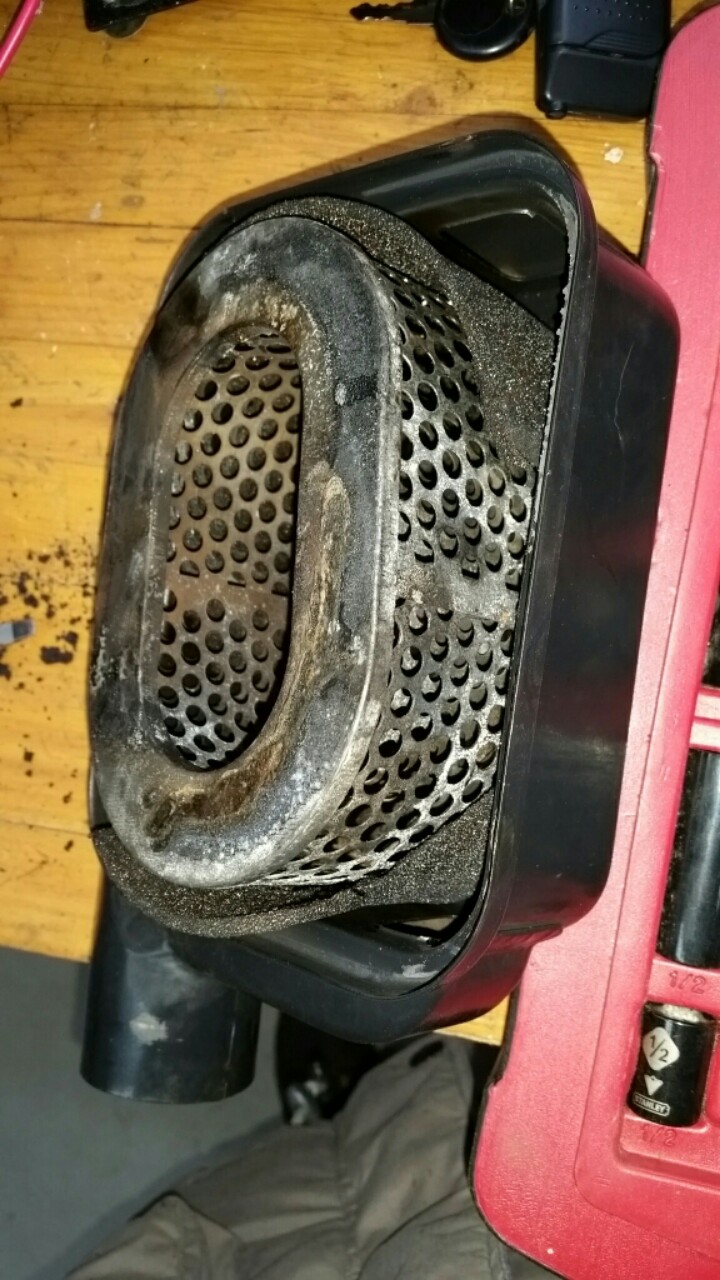

I was sitting here thinking about your air filter being burned up & missing.
These generators have a cat in the exhaust and it may be plugged. I would remove the pipe and check to see if it’s restricted.

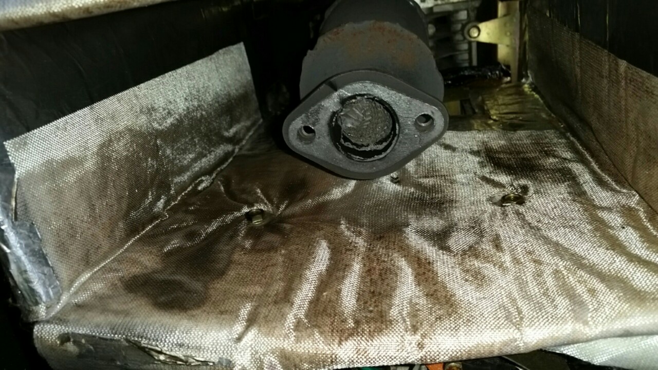

The cat was plugged up. I took the exhaust apart and the baffles in the cat were sideways blocking the outlet. I have a picture of this, I will try to post it up here shortly.
I gutted the cat and removed everything out of it until the path was clear. I will have to double check this in case something broke loose again. Once I verify this, I will proceed with your suggestions and continue troubleshooting. I hope the piston is fine, but I suspect the valves might have an issue as well, hence the backfire and burnt up air filter.

I would reattach the pipe and give it a run without the sheet metal on before you tear into the engine maybe that was the problem.

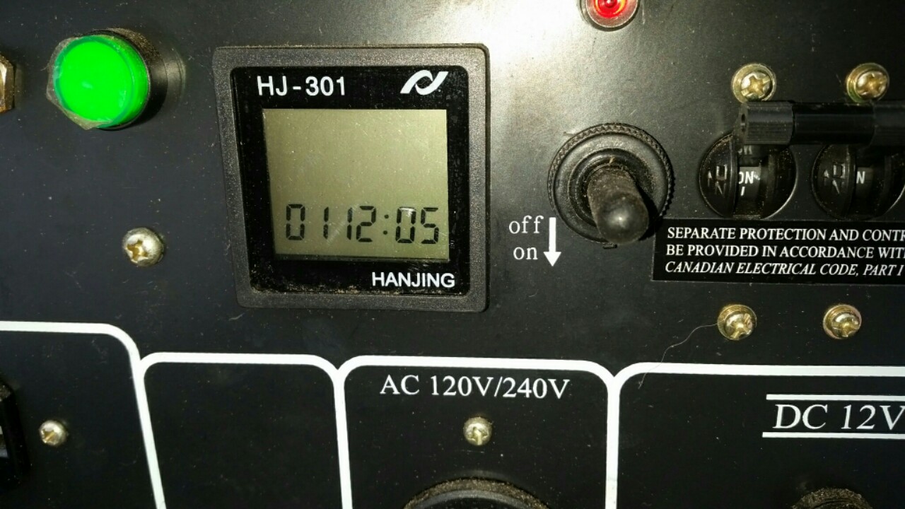

Here are some photos of what I found after the exhaust started glowing:
Current hour count, not even 120 yet...
What was left of the air filter
And what I found the Cat like, it all came apart.
