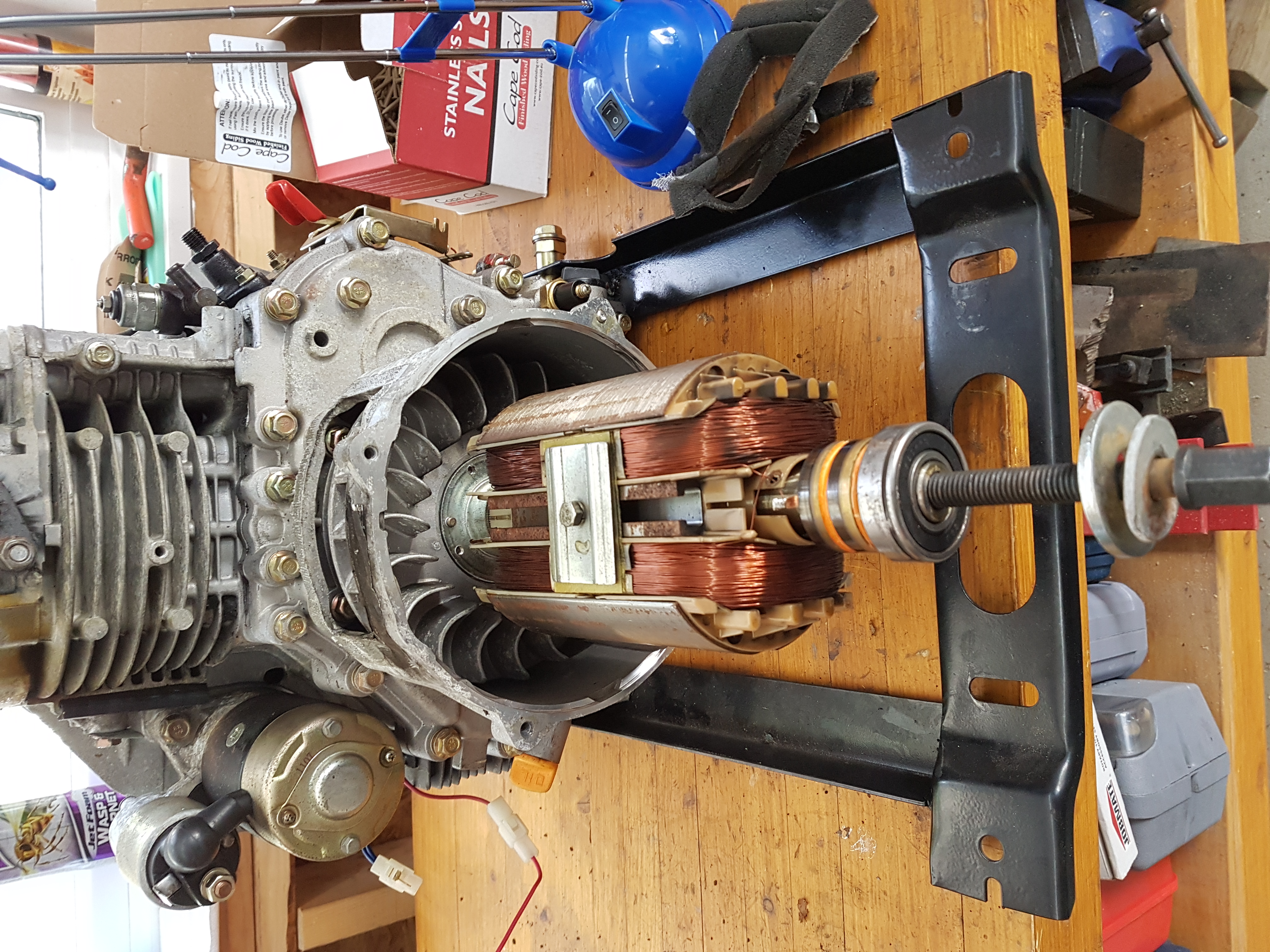

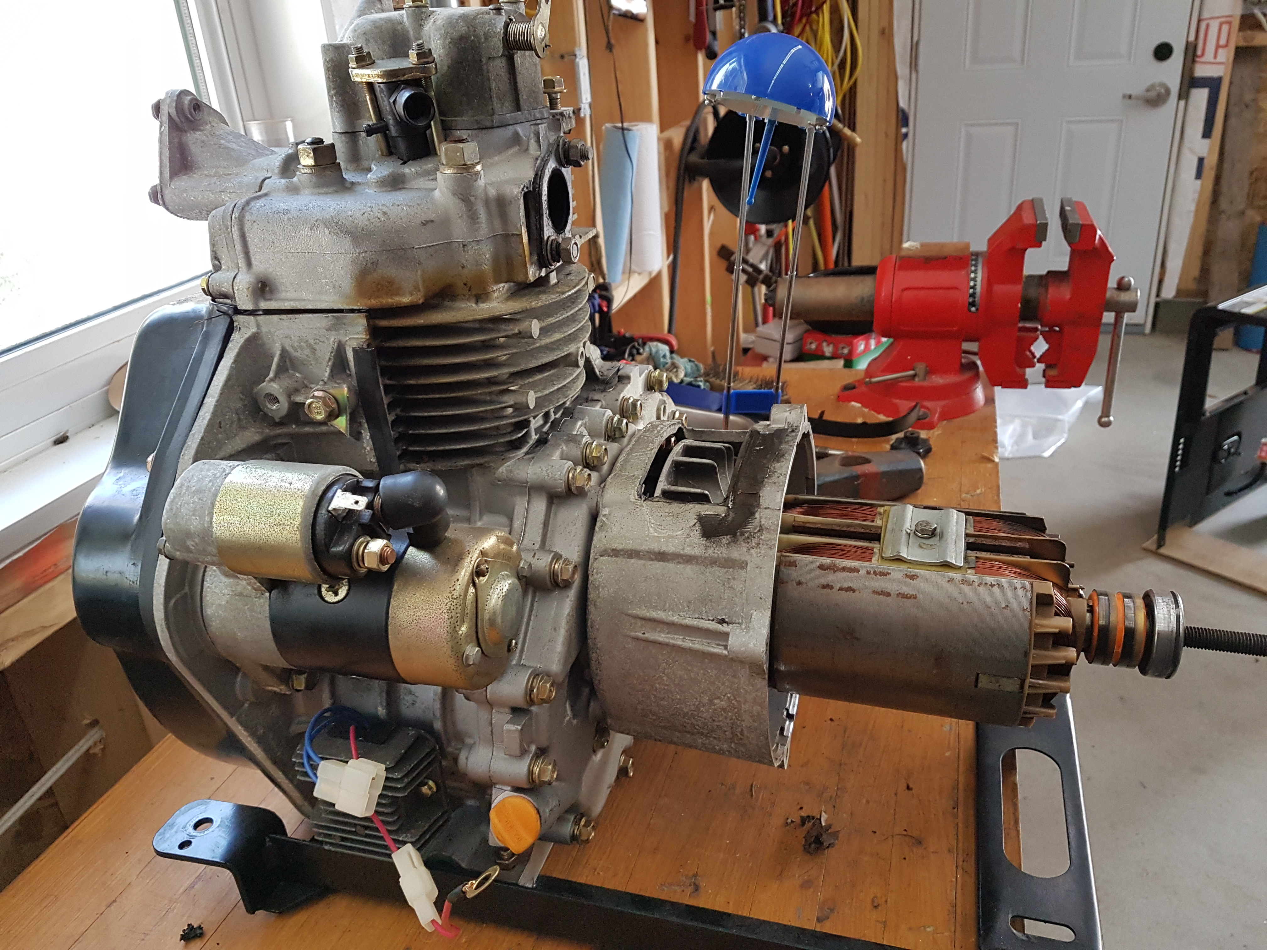

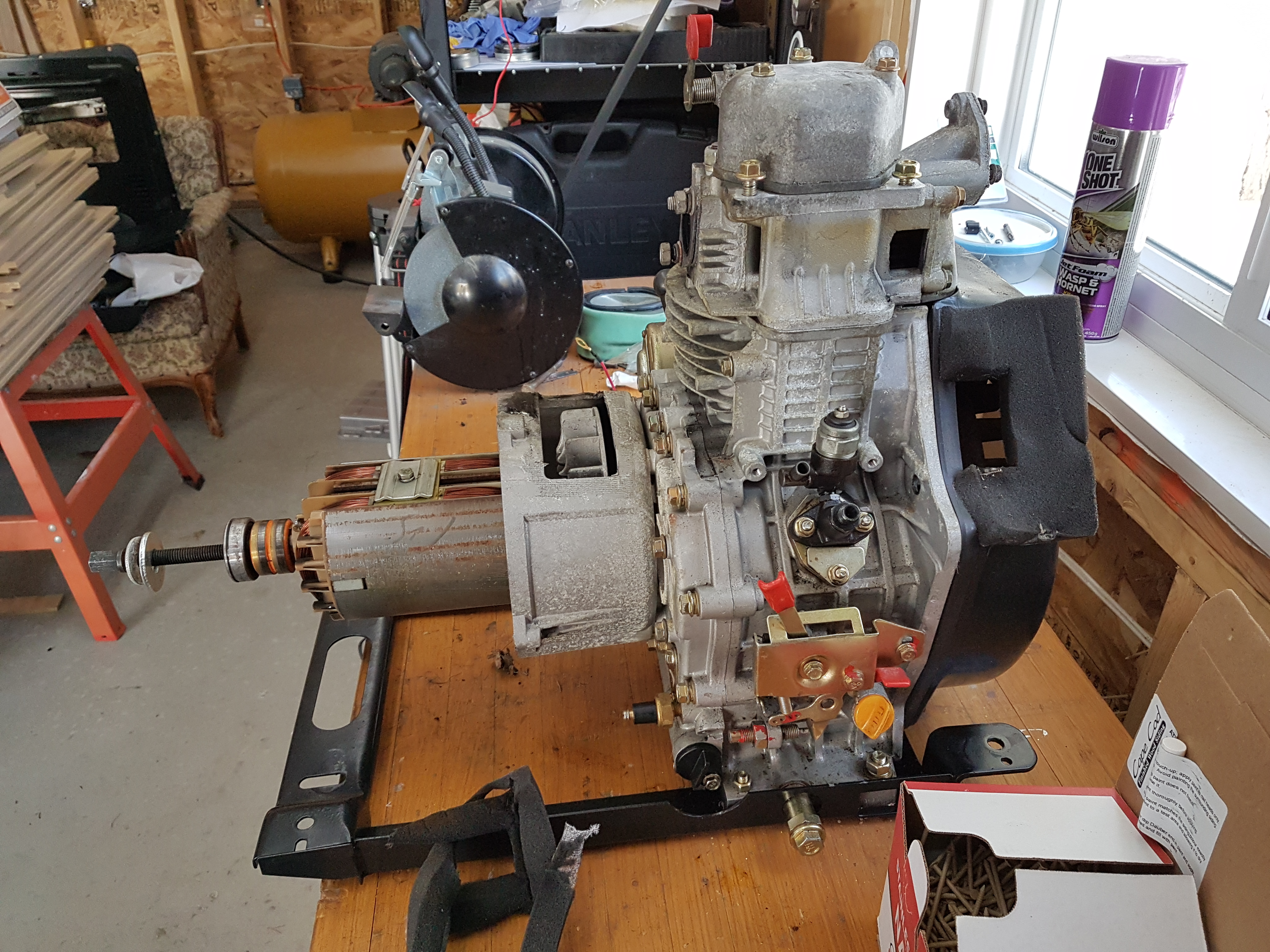

Checked fuel pump rack engagement with forked lever was correct. Loosened throttle plate to properly check govenor springs position and levers. Seems Ok. Bleed system. Unfortunately still same problem.
Edit to add. Checked service manual one spring not in the position suggested. Although I noted that one lever only had one hole to select and changed other end of the spring onto the middle position on the other lever. Will test again tomorrow as I had sikaflexed some fuel hose into position to hold the various electrical wiring harness securely in position and I had to wait for that to set overnight.
I also noticed when I had fuel pump removed I checked the fuel pump cam follower which seemed ok but noticed slight pitting on the low area on one side of the fuel pump cam. Measured pump shim thickness 0.4 mm.
Will order a new pump and a few other bits and pieces. Any leads regarding a reliable quality supply source? I generally use Temu or Aliexpress however open to other suppliers.

I tend to use nylon pull ties (zip ties) to hold things in position; I make too many mistakes for glue.
I would have to go check on the spring position(s). It isn't something I have dealt with in the past. My recollection is that those modulated the governor response.
Here, I order from Amazon/ebay/Yanmar, and I have had occasional low quality parts turn up from the non-Yanmar sources.
Nice set up!

“I tend to use nylon pull ties (zip ties) to hold things in position; I make to many mistakes for glue.”
I usually do the same. However there is a drip tray that the motor and pump sit on/in. Didn’t want to drill through this to secure wiring harness. Using the correct sized fuel hose with a cut that allows me to remove harness if/when I need to. In effect a flexible saddle ! Cheers

Aaaah. I now understand what you did. Brilliant!

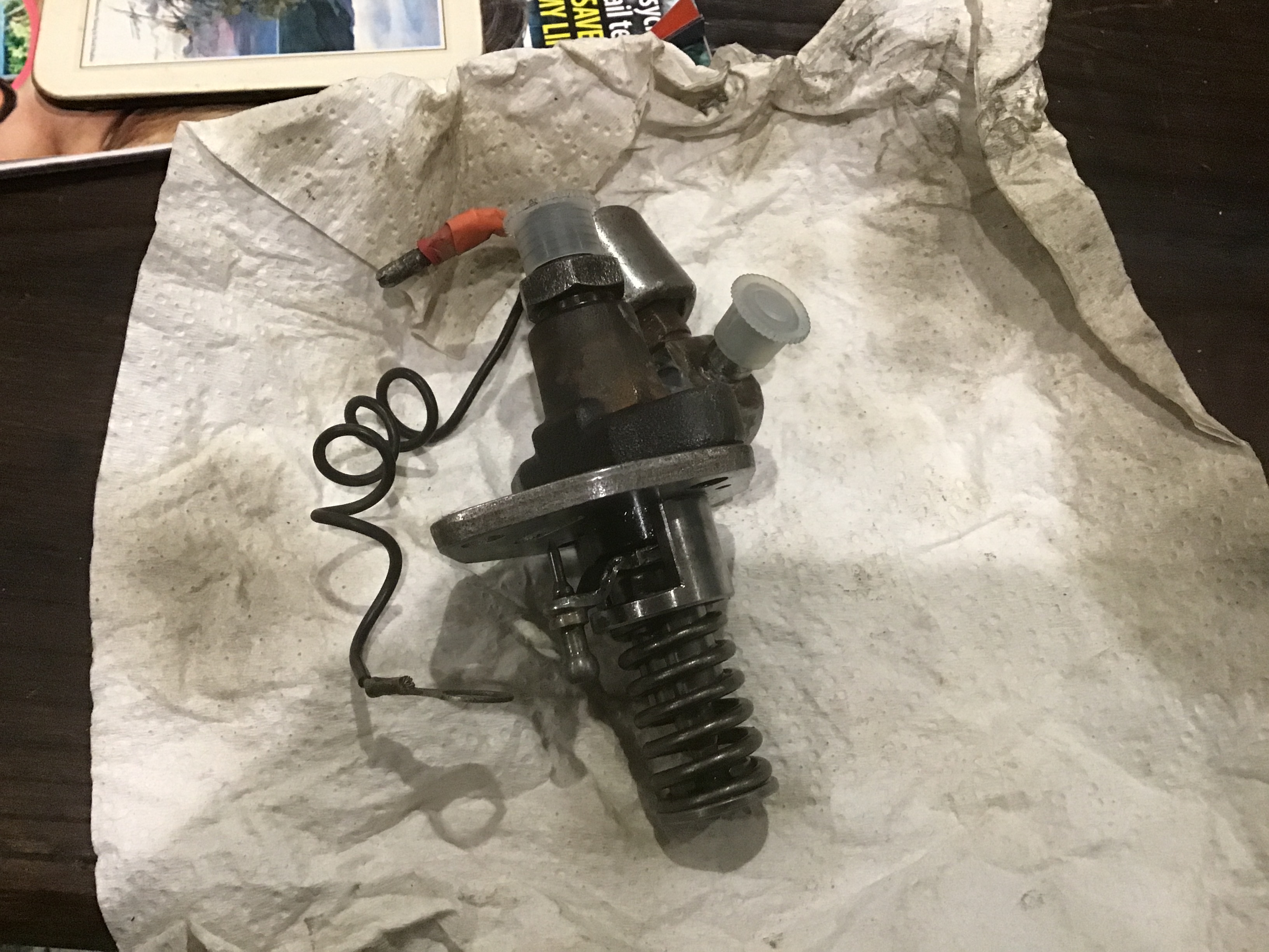

Update on Troubleshooting the starting/running issues with my L48 Yanmar.
Removed the injection pump and dissembled, cleaned and reassembled unfortunately didn’t seem to fix the issue. Borrowed a chinese replacement pump without the stop solenoid and that seems to have fixed the problem. Engine now starts easily and will run up to full speed.
Just spent he last few hours looking for a suitable replacement which has the stop solenoid. Every one I look at seems to have the fuel inlet on the wrong side. While the borrowed pump without the stop solenoid has the fuel inlet on the right similar to the original every aftermarket one with a stop solenoid seems to have the inlet on the left side. Any other members had a similar problem?

I would call that progress!
The handedness of the solenoids seems to be defining design feature of the aftermarket solenoids. I've run into that with other L48 engines.
I think it comes down to buying the Yanmar OEM version, or changing the fuel line to the solenoid a bit.
Again, upthread, once I had mine running with a replacement, I carefully unscrewed the solenoid out off the pump (be careful as the actual threads need to be gripped, not the solenoid housing), cleaned the threads, and used a non-hardening diesel thread sealant to put it back together, and magically, the issue went away with the old pump.
N.B. If you do try to repair the solenoid on the old pump, the solenoids are usually constructed in such a way that the outer portion (the shell) of the solenoid housing is not strongly attached to the threaded portion that goes into the pump. So applying torque to the outer shell can shear the solenoid wires inside.

Thanks ponytug.Still have to complete order for new pump and will try to buy a new solenoid to adapt to the old pump as suggested. Well worth a try considering what the Yanmar OEM pump costs over here.

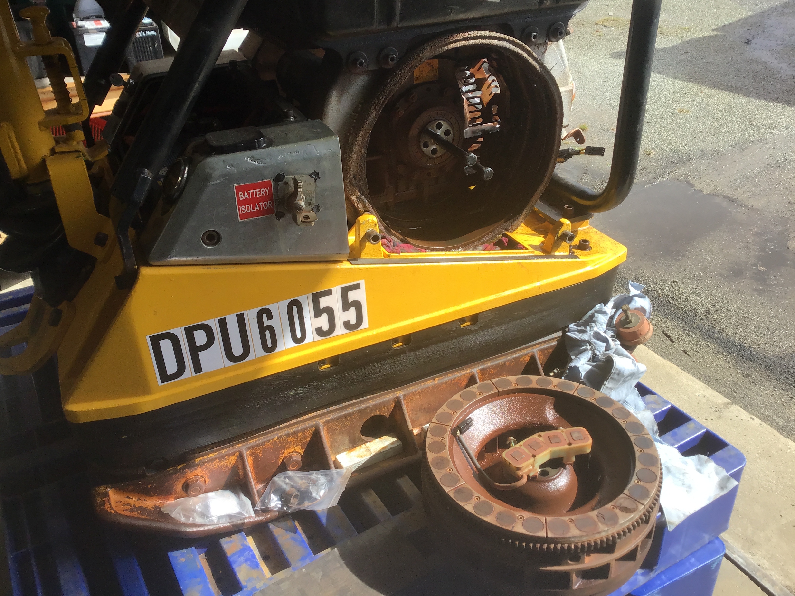

I have been distracted and busy with another similar project Hatz powered Wacker plate compactor. Similar problem here with both maintenance repair information and parts availability.

Image of other project in progress. Alternator fault light. No ~AC output from coil. PITA to remove flywheel. Flange for clutch difficult to remove!
Now just looking up price and availability of coil to suit
Also inquiring if any forum member have experience upgrading how the engine shuts down on a Hatz 1D81S from reducing throttle to an electric solenoid shut down?
