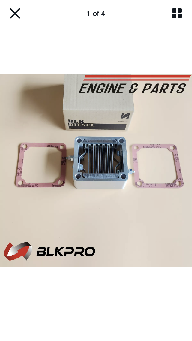

The Intake grid heater on the Dodge Cummins diesel would work.
You may need to use an automotive size battery because of the amperage it draws but that would most certainly work.
It is virtually identical to yanmars L70 but much larger

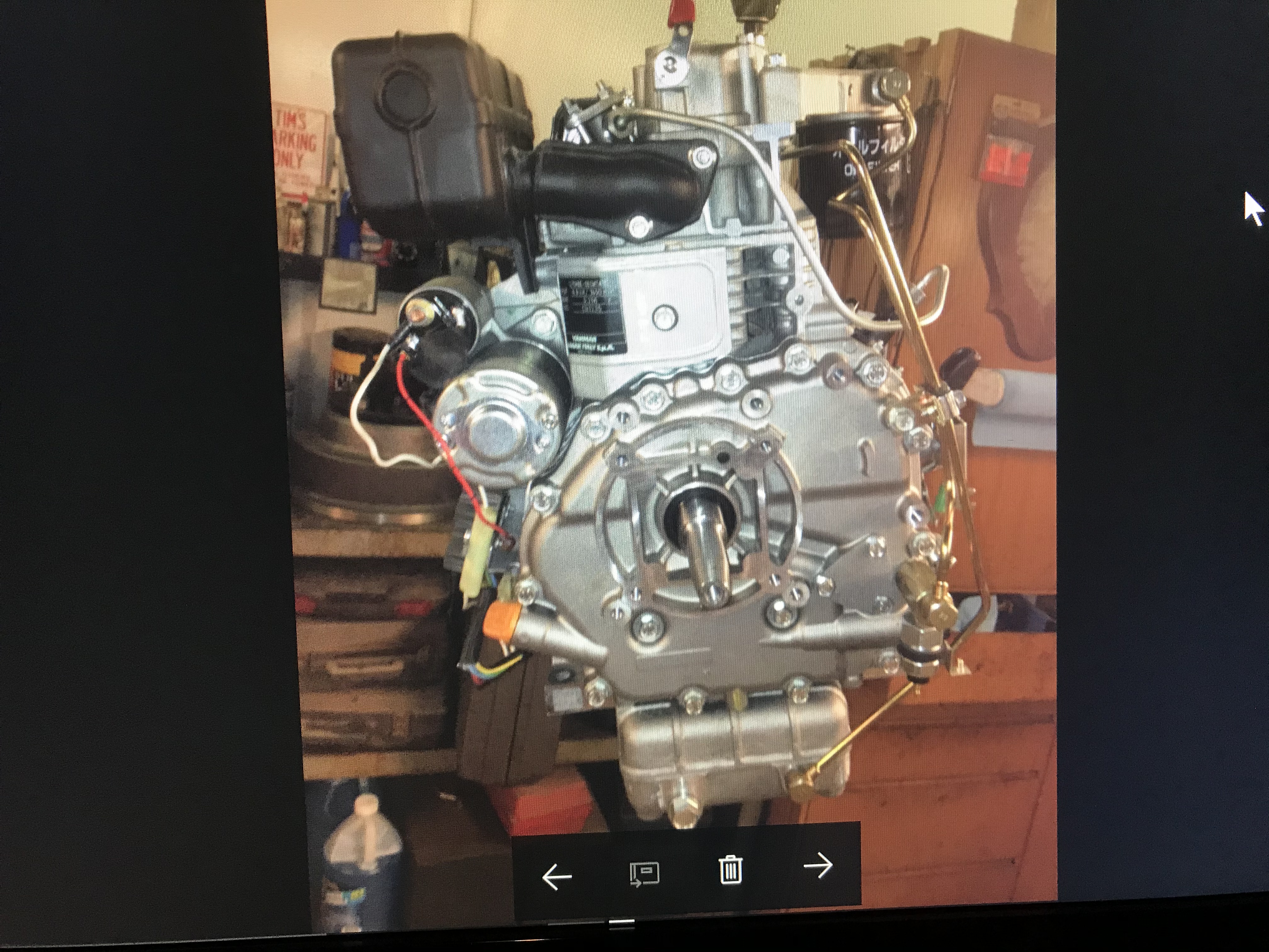

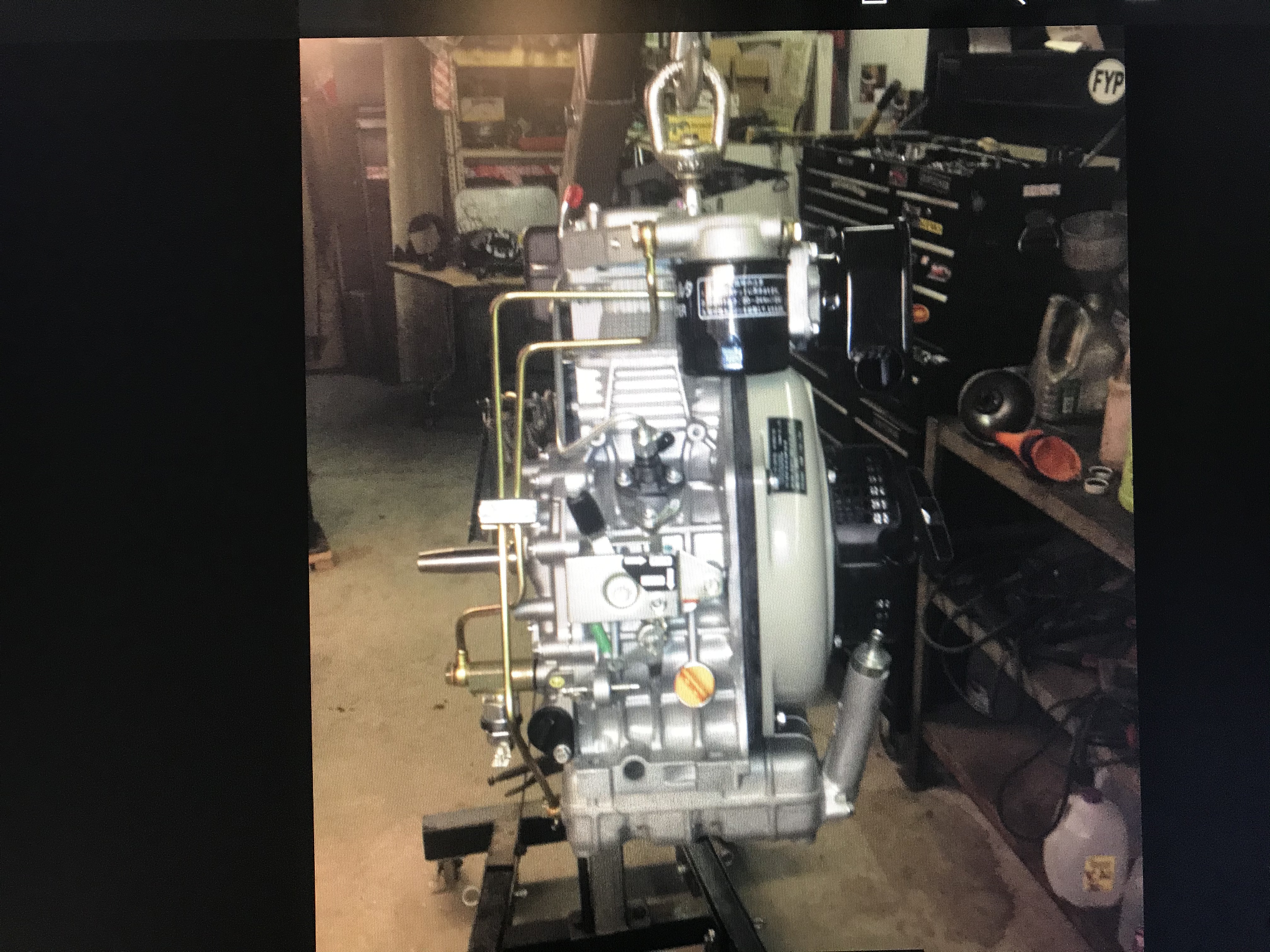

I have a L70 with a factory installed spin on bypass filter and an extended 2 quart oil sump which increases the oil Capacity to 3 quarts. It also came with a grid heater.
It was designed to operate 500 hours unattended in remote applications.

I can't see a way of adding a bypass filter without dropping the oil pressure, and I imagine the floating "bearing" relies on good pressure. I guess a second pinhole oil restrictor could be added before the remote oil filter, for arguments sake lets say the original pinhole relief is 1mm, if I added a 0.25mm restrictor before the oil filter, I would be dropping the oil pressure (to the bearing) by.. 12.5 percent. Sine the engine would now have 1.25mm of hole to return to sump. Not sure on numbers but if the engine runs at 100psi warm I'd be dropping to 87.5psi instead. Not too sure if a 0.25mm restricter would allow a good enough flow of oil for a standard oil filter? Suppose it doesn't matter too much as long as it flows enough. How is your spinny oil filter plumbed? Suction side or high pressure side? Any info would be appreciated or pics.
As for the grid heater, I've seen those Cummins air intake heaters on US eBay, but wasn't quite sure where one would put it, I assume it would have to be fitted before the air filter which figured it might get clogged up?

The grid heater should be on the engine after the air filter.
Placed before the air filter Could cause the filter to burn up.
Still looking for photos of my L70 bypass oil filter.

I suppose it would be a job of making some sort of custom intake manifold adapter to be able to bolt one of those intake heaters in. I assume the l48 intake is different to accept the genuine heater over the l100 which doesn't appear to have any fixings for one. But in all fairness to it, 15 secs on the car type glow plug this morning at 1 degrees and it started on the first stroke.

As I mentioned some time ago I have an L70 Yanmar with a Factory option extra deep sump with a bypass filter.
The sump holds approximately 3 quarts. This engine was designed for remote applications requiring extended run times unattended. It also has an intake grid heater for extremely cold starts and is designed to run 500 hours between services.
There is a utube video of me starting it during a subzero cold stretch under username 90cummins.
I purchased it specifically to replace the 9hp L90 originally mounted to a 5000 watt generator head.
This was done to minimize fuel consumption with a short term capacity of 4kw with excellent surge capacity and voltage stability while still meeting my electrical requirements.
This works very nicely with my 4kw Xantrex hybrid off grid battery backup system.
During an outage if the load exceeds 3.2kw the inverter is programmed to assist the generator by pulling power from the batteries.
