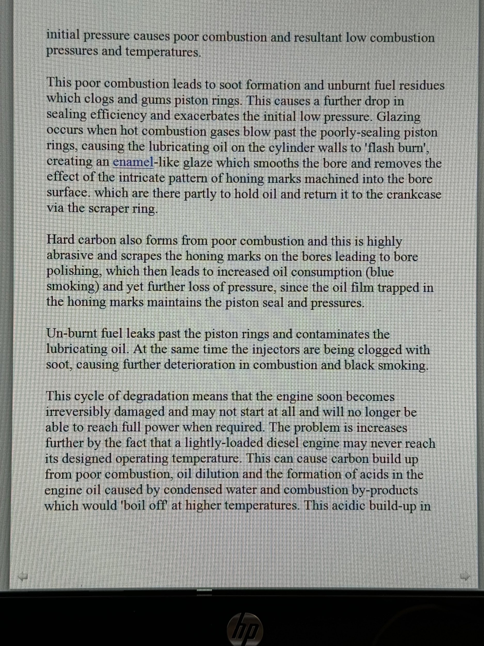

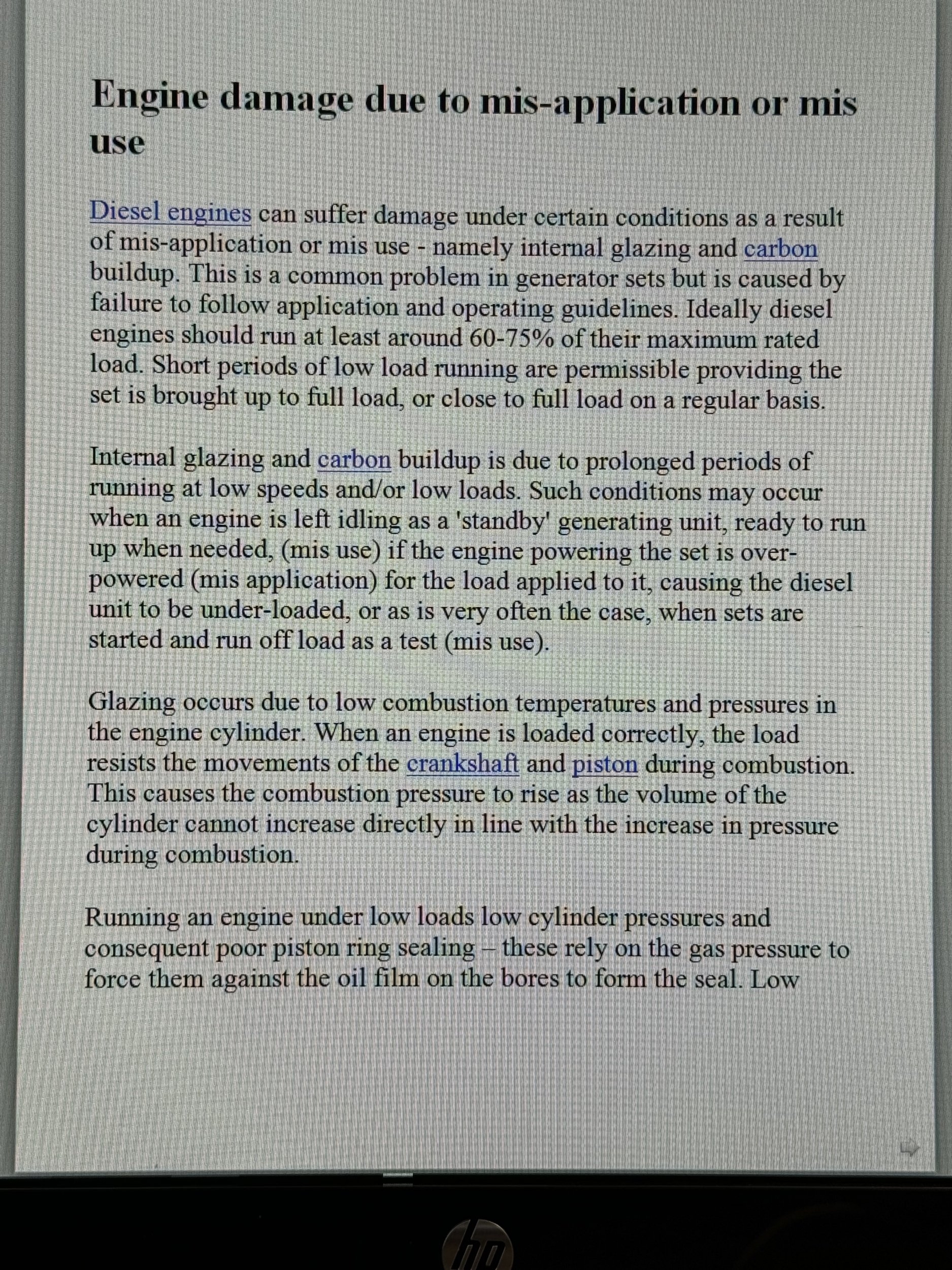

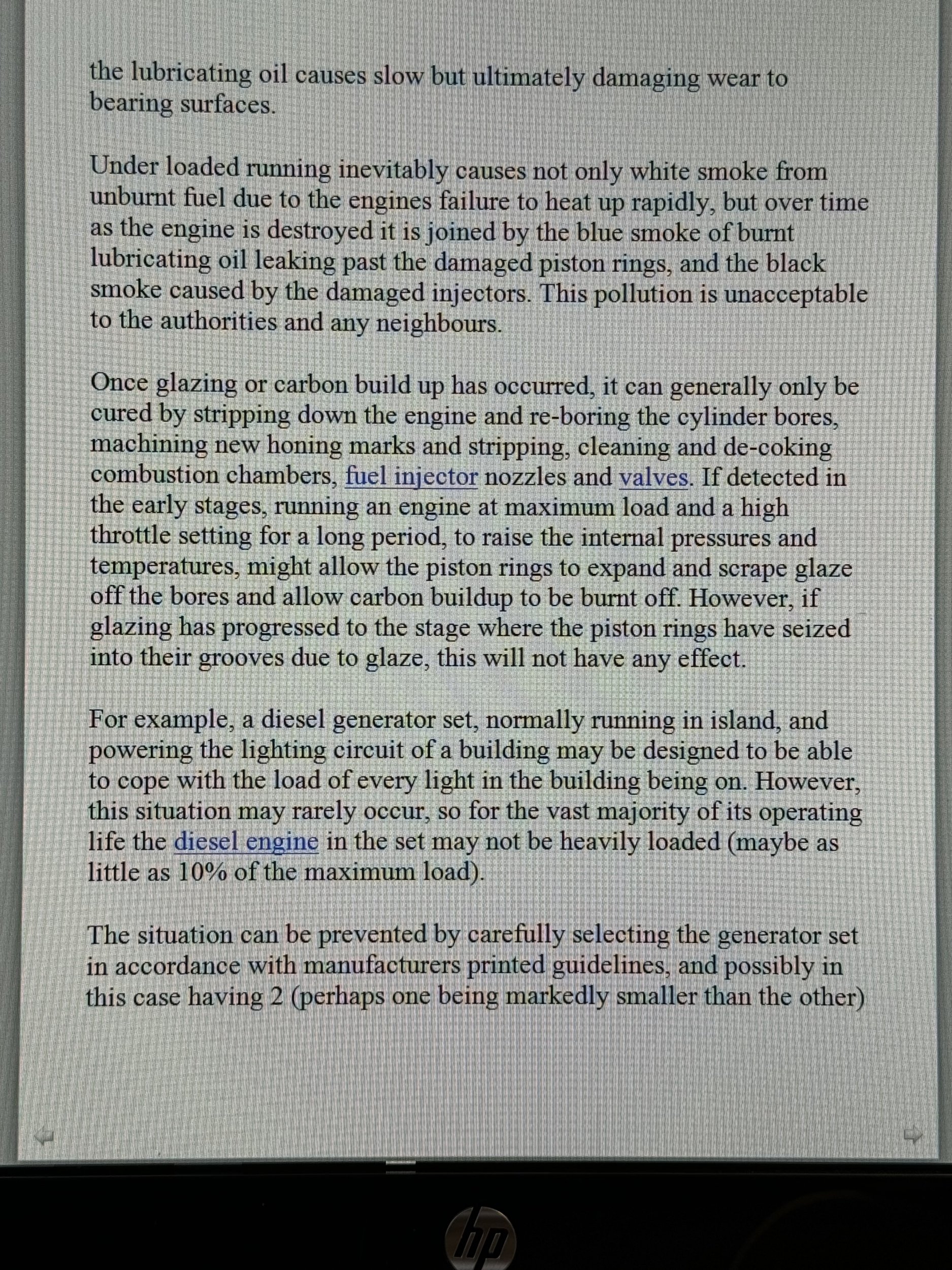

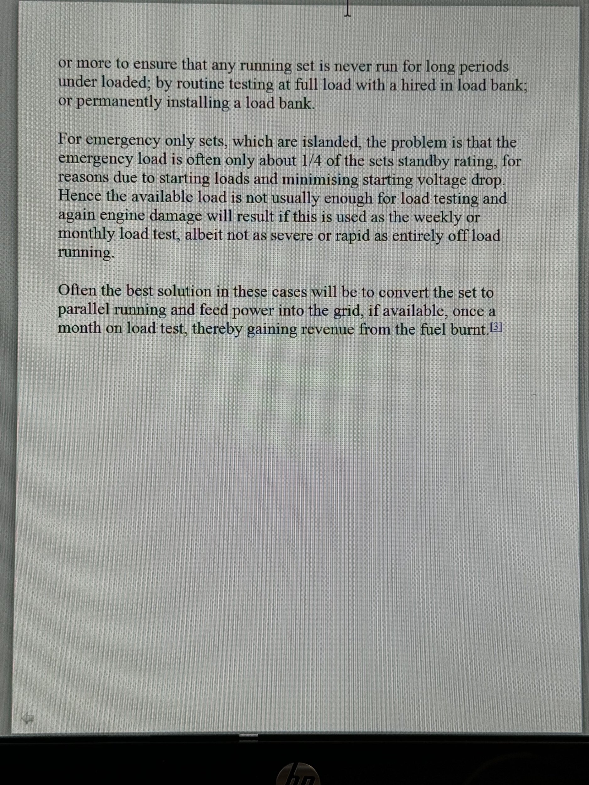

I’m thinking the compression is low because of extended operation with very light load and/or cold temperatures.
If you squirt some oil into cylinder if rings are the problem it may allow you to get the engine started. If you have 2 preferably 3 or more 1500 watt heaters to load the generator if it starts you may be able to avoid a teardown by running it close to full load for a couple hours.
Cylinder bore glazing is a real problem for diesels large & small if run lightly loaded or cold.

I found an article about diesel cylinder glazing years ago it is not my article unknown source. IMG_8423.jpegIMG_8424.jpegIMG_8425.jpegIMG_8426.jpeg
