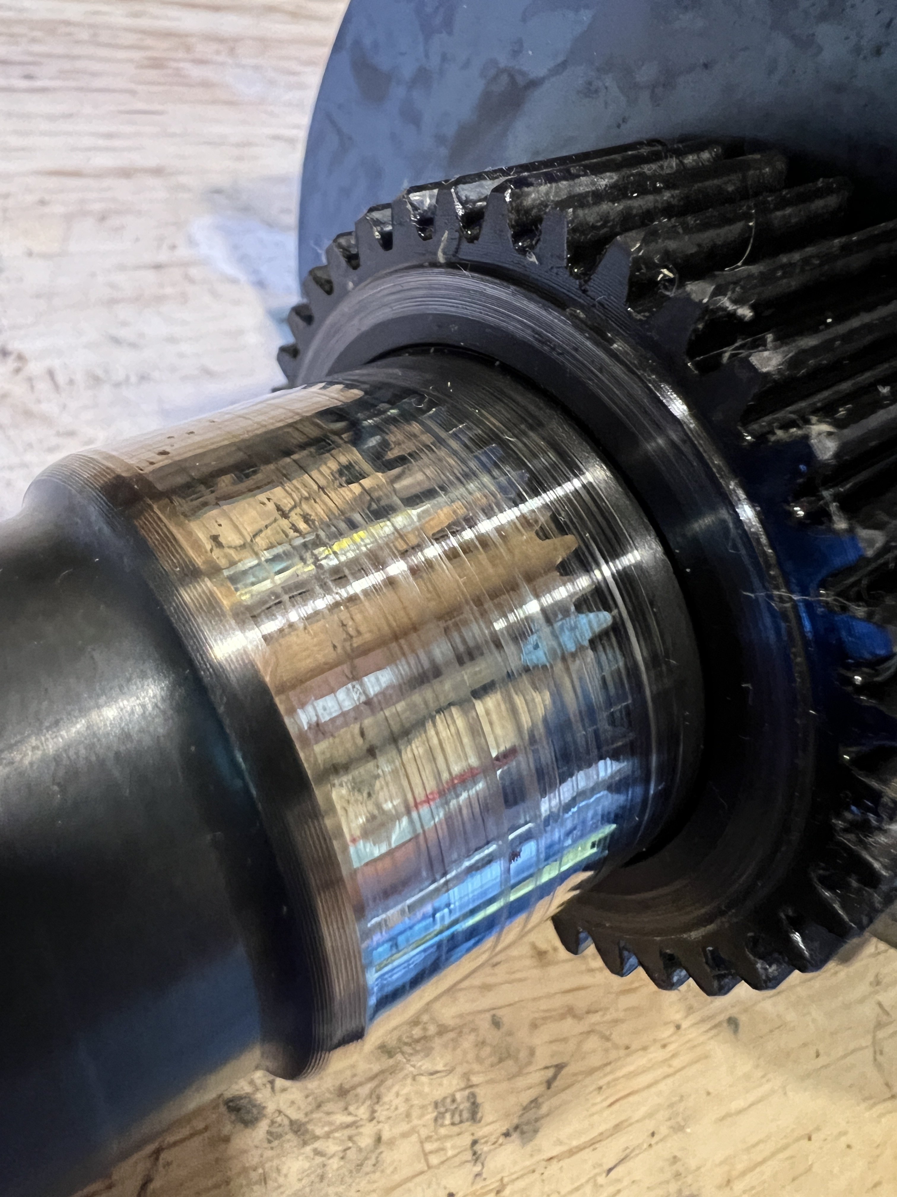

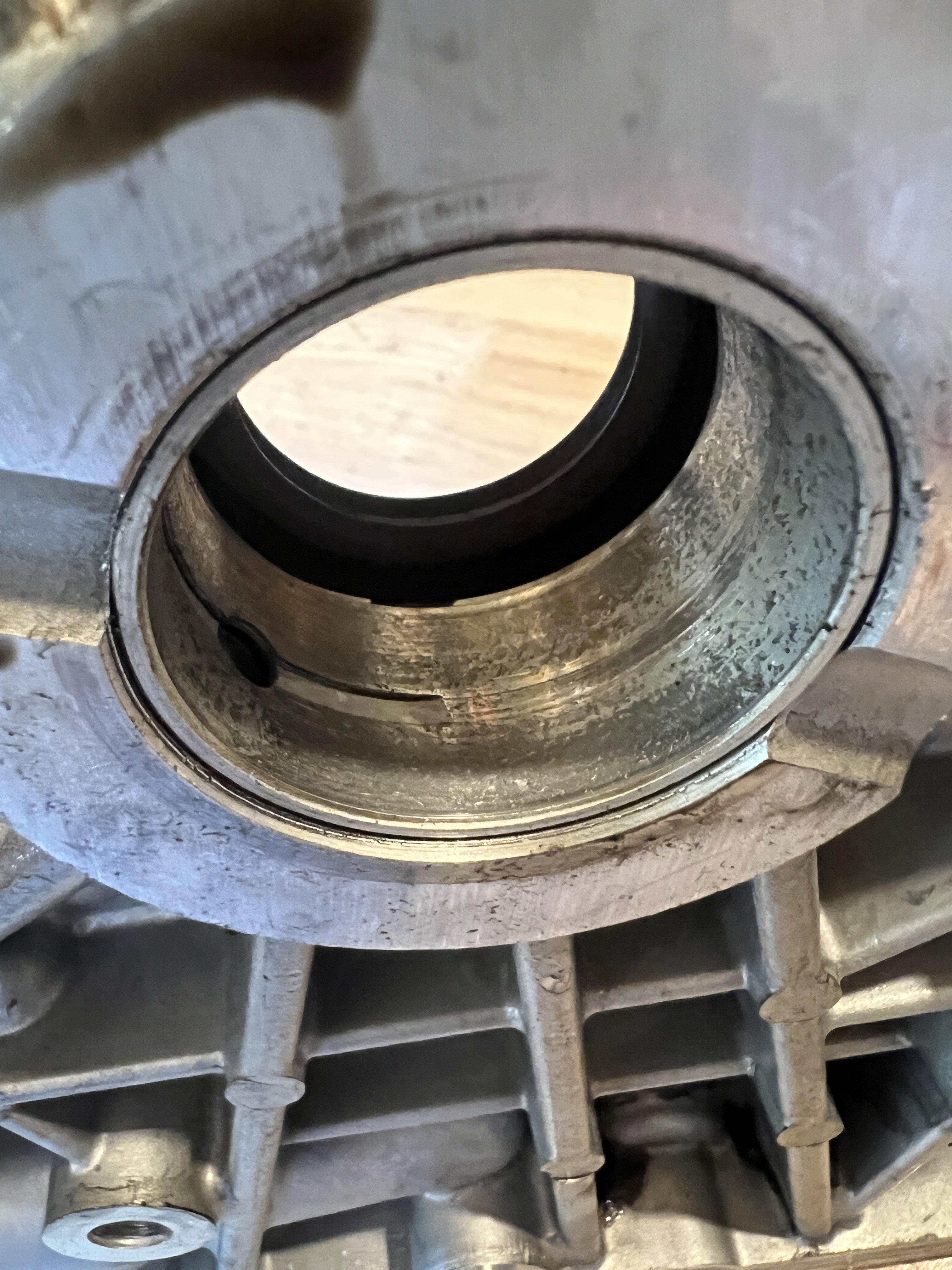

Are you saying the crankshaft PTO and rod bearings are wearing also?
90cummins
Thanks! That's what I figured when I read through this topic, I just wanted to check if I missed something.

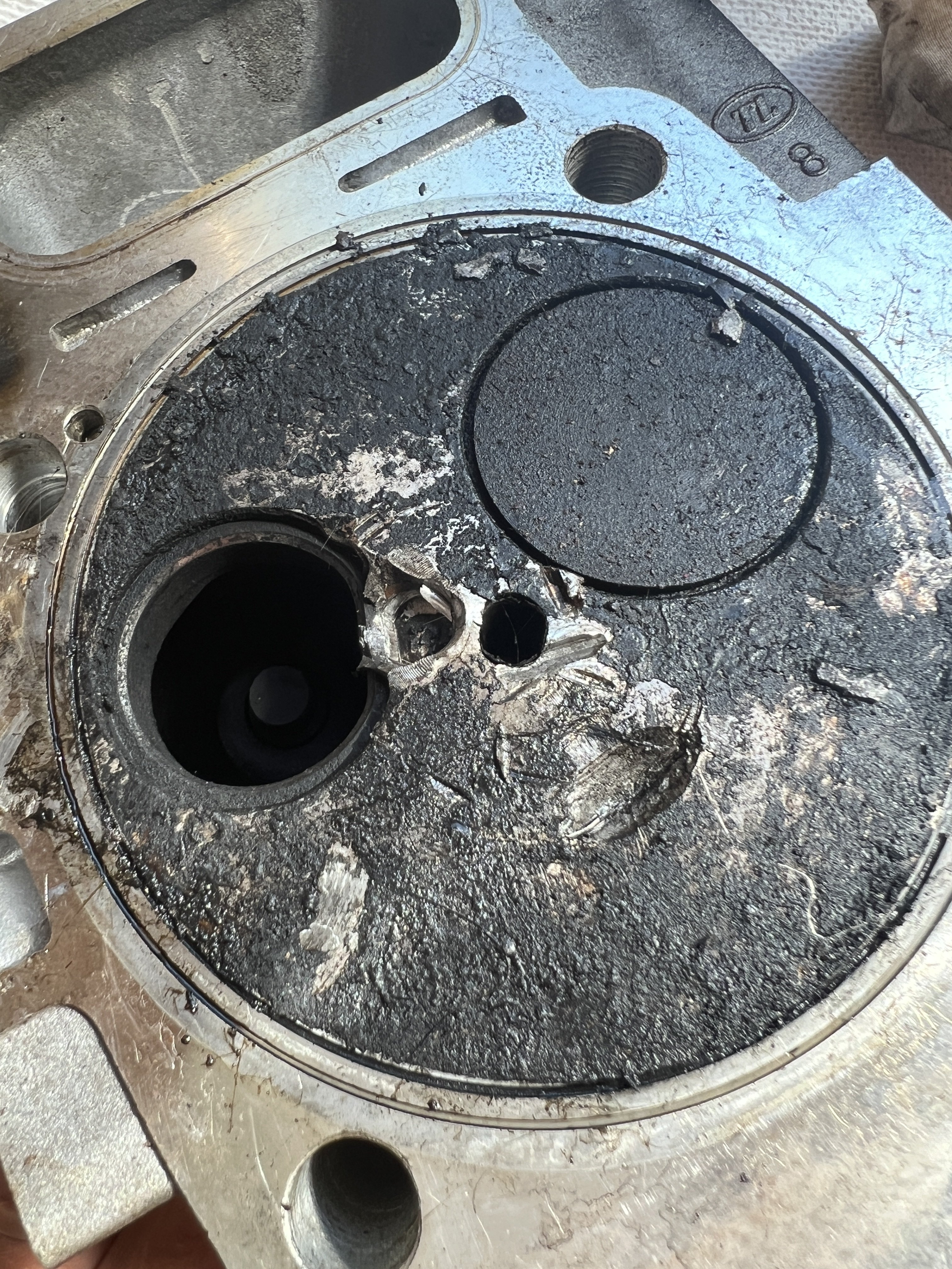

I actually have a running "8.5Kw" Chinese diesel, and an original Winco 5.5Kw with a Yanmar L100 with unknown hours. This unit I just stripped down was one that did not get enough or probably any oil changes. Thus it has PTO end bearing wear and big end crank bearing wear, also cam fallow wear as well! This all probably caused the poor running, hot exhaust and in turn the dropped valve.

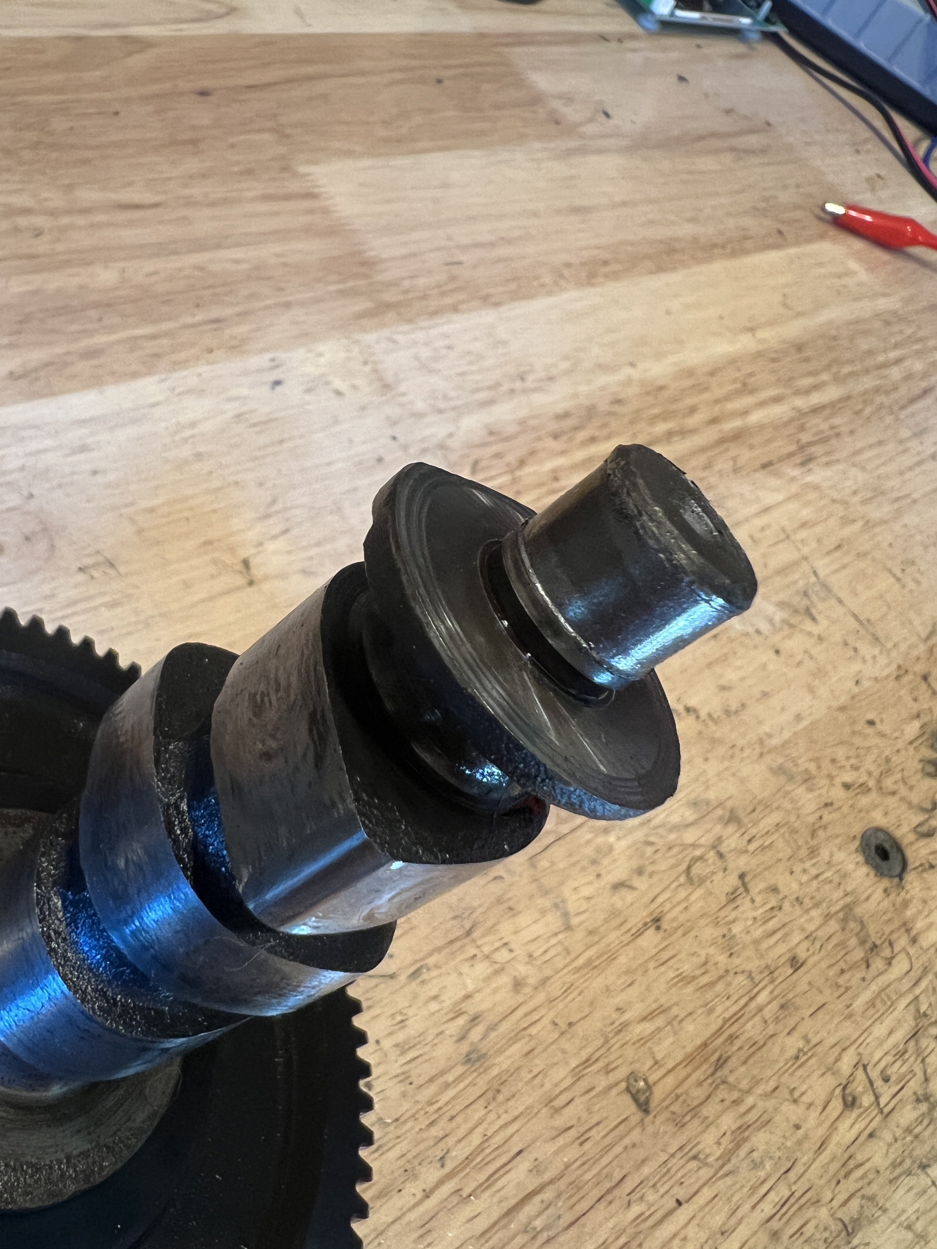

Could you take a photo of cam & bearings.

It's a needle bearing, the big end is the ball bearing, yet the Yanmar original has a bushing. My thought was to replace the needle bearing with either one with an inner race, or a complete ball bearing. The RPM rating only has to be 1800RPM, thus, its more about the pressure applied to that end.
The movement that I am concerned about caused by the big end bearing is radial, due to it be unbalanced on the small end bearing side. The bushing style on the original Yanmar might mitigate this issue.
I will post photos when back home in a few days.
   / Forum for air cooled diesel engines and clones #645
Here is the damage: 350hrs, dropped valve.
