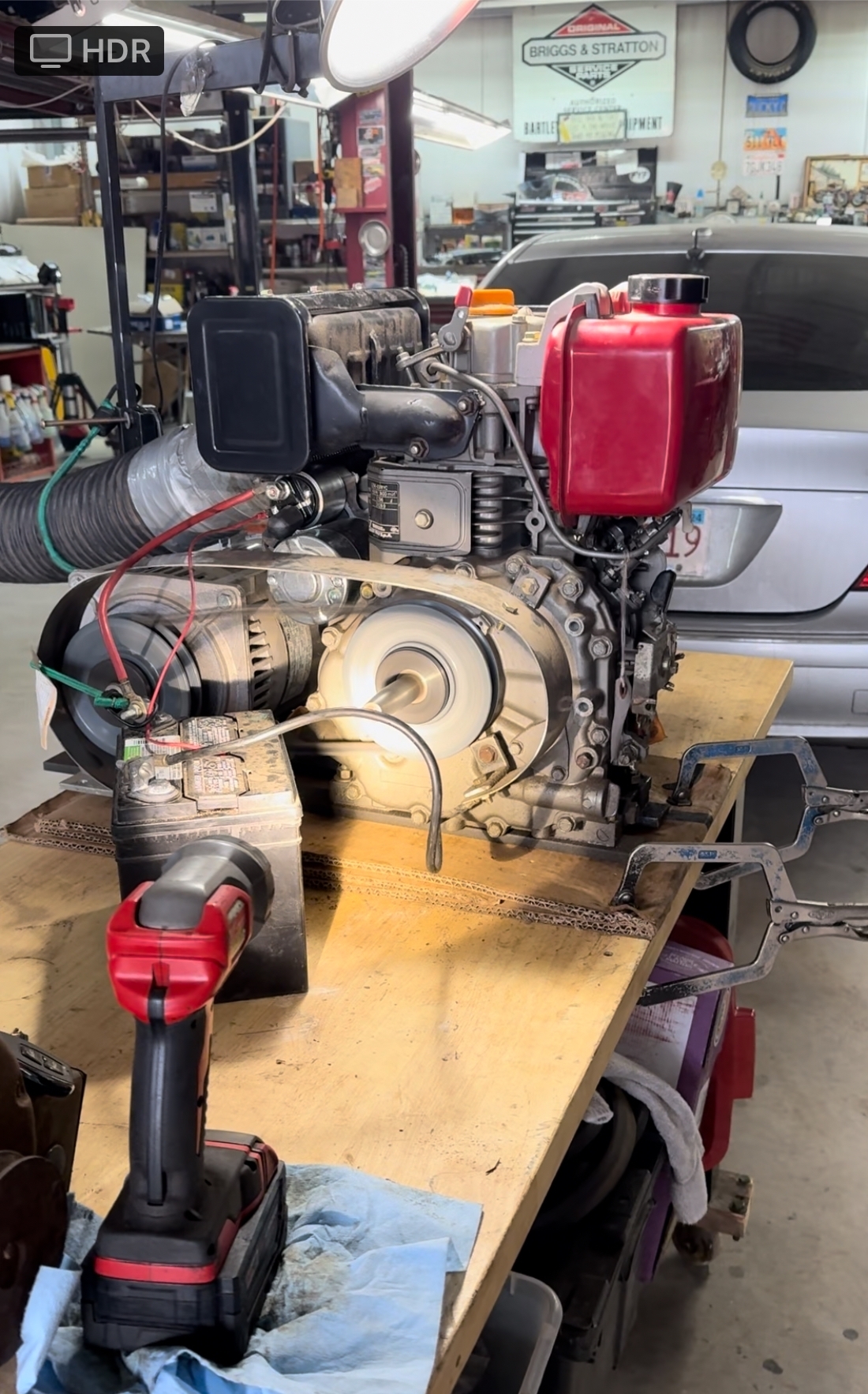

I built my nephew a generator several + years ago using a Yanmar L70 diesel from eBay which needed rebuilding. New rings, camshaft lifter & rod bearing plus seals & gaskets. A belt drive 5kw generator was purchased also along with taper-loc bushings so I could mount a pulley on the shoulder of the crankshaft which was tapered for a direct drive generator.
Belt drive was chosen because of the ability to use any motor source to run it. It also allowed us to overdrive it with the appropriate pulley to reduce engine rpm.
It was sitting in the corner of my shop since it was first built & tested & I thought it is time to pull it out & check it.
There was fuel in it so I connected the battery & it cranked & cranked🤨
Very unusual to not start within 1 or 2 revolutions.
Found the injector rack was stuck closed, fortunately.
Removed injection pump hit it with some blaster worked it until it was free then reinstalled it. Cranked it & she started up nicely.
I put 2 heaters on it for a load of 2.9kw & ran it for over an hour.
Tested engine rpm unloaded 3720rpm, 1.5kw load 3600 rpm 2.9 kw load 3530rpm. Ran excellent. I put 2oz of marine 2 stroke oil in fuel & ran another 1/2 hr.

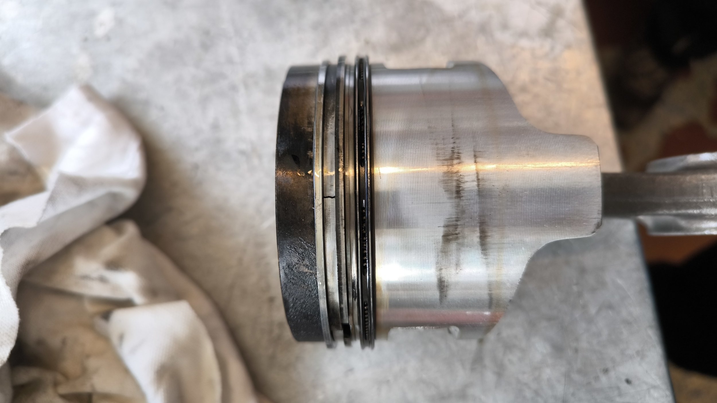

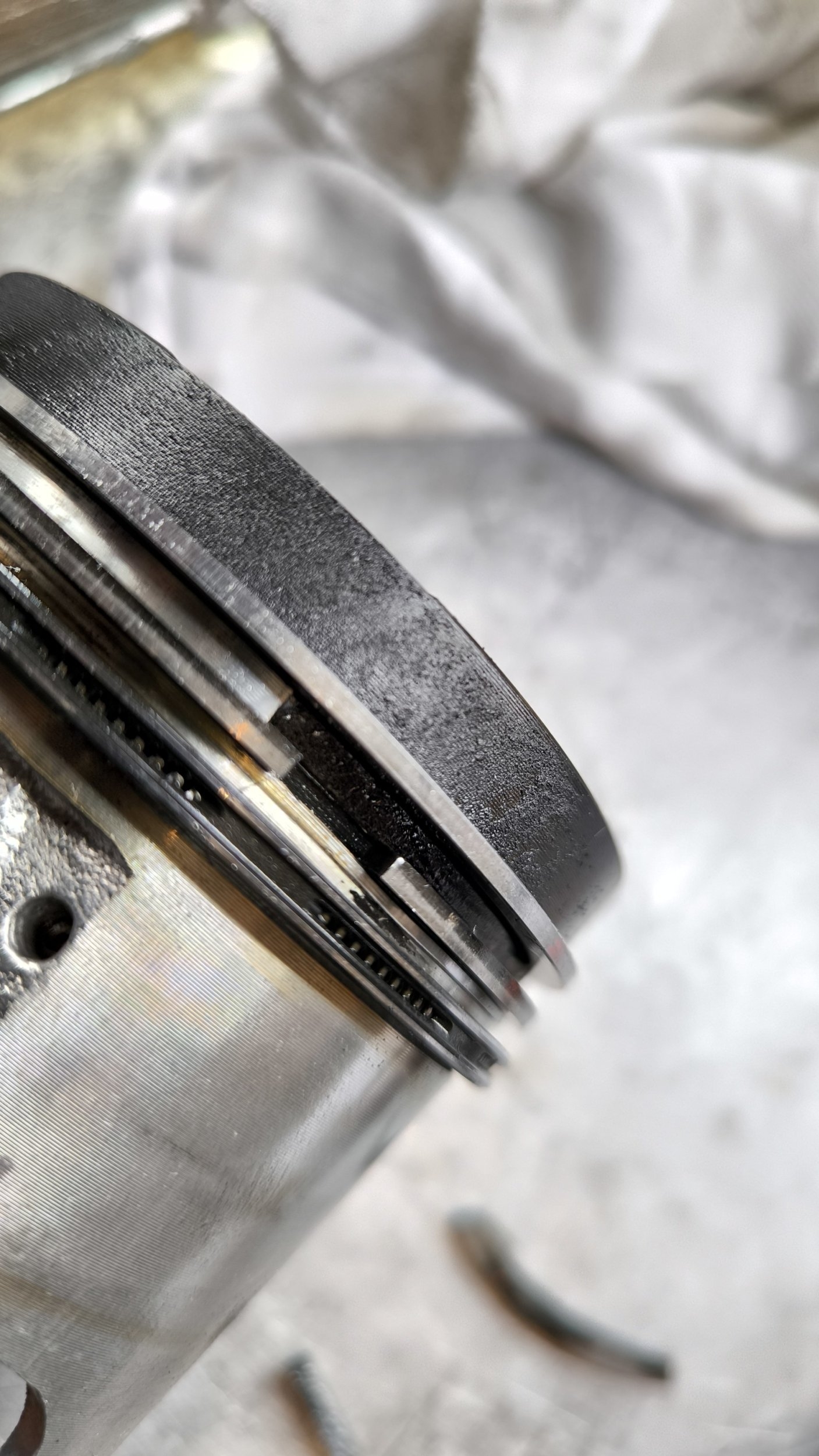

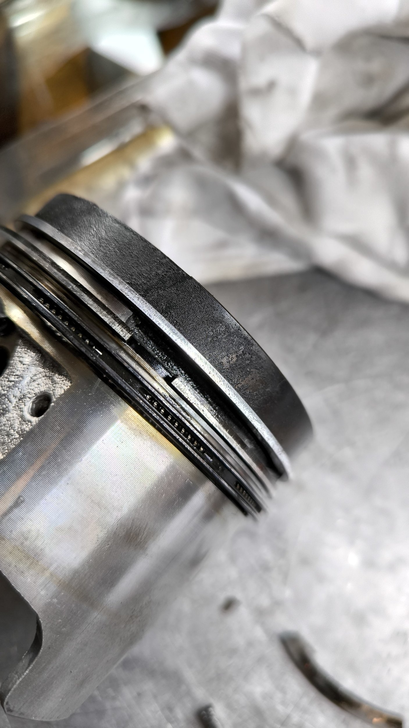

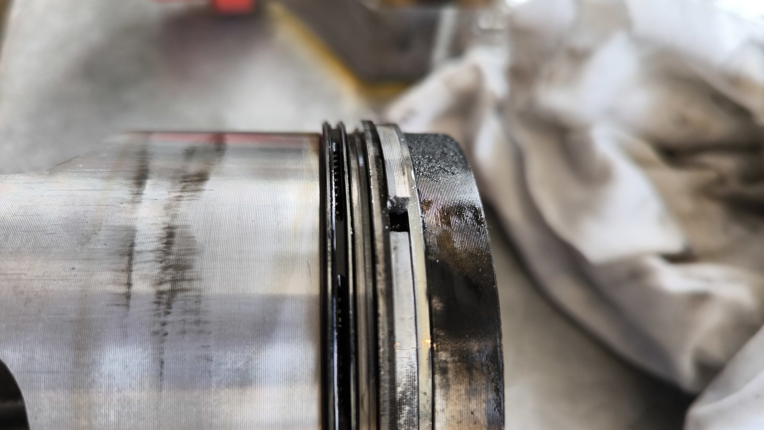

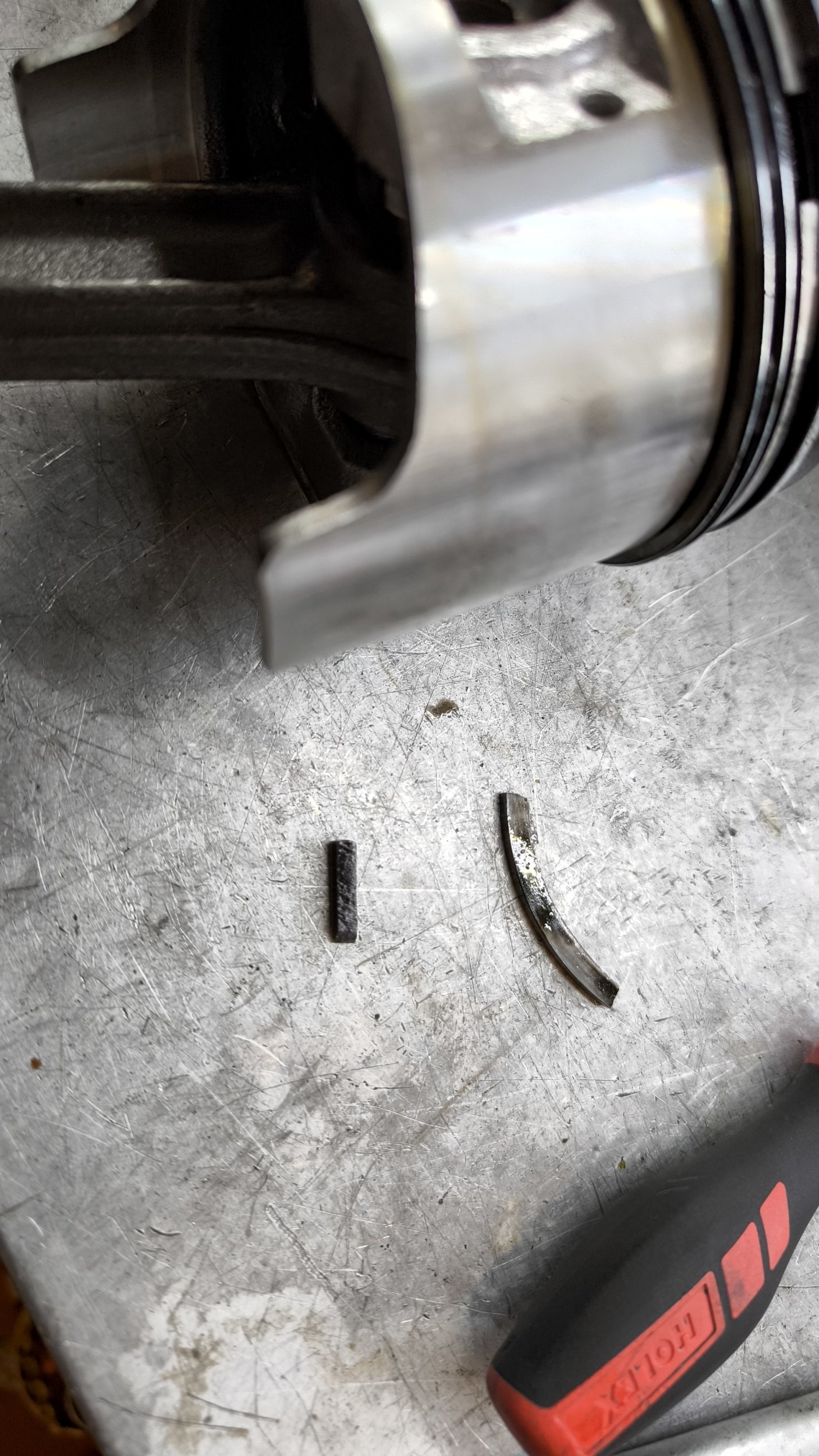

Hello my friends and helpers, finally i found time to dissasemble the engine.
Here are the results

Congratulations on finding the cause! I hope that the rebuild goes quickly and smoothly.
All the best,
Peter

I can’t say what caused your piston to break but starting fluid can certainly cause that.
Give it a quick hone & a new piston & rings and you’ll be good.
Is that a Yanmar or clone?
