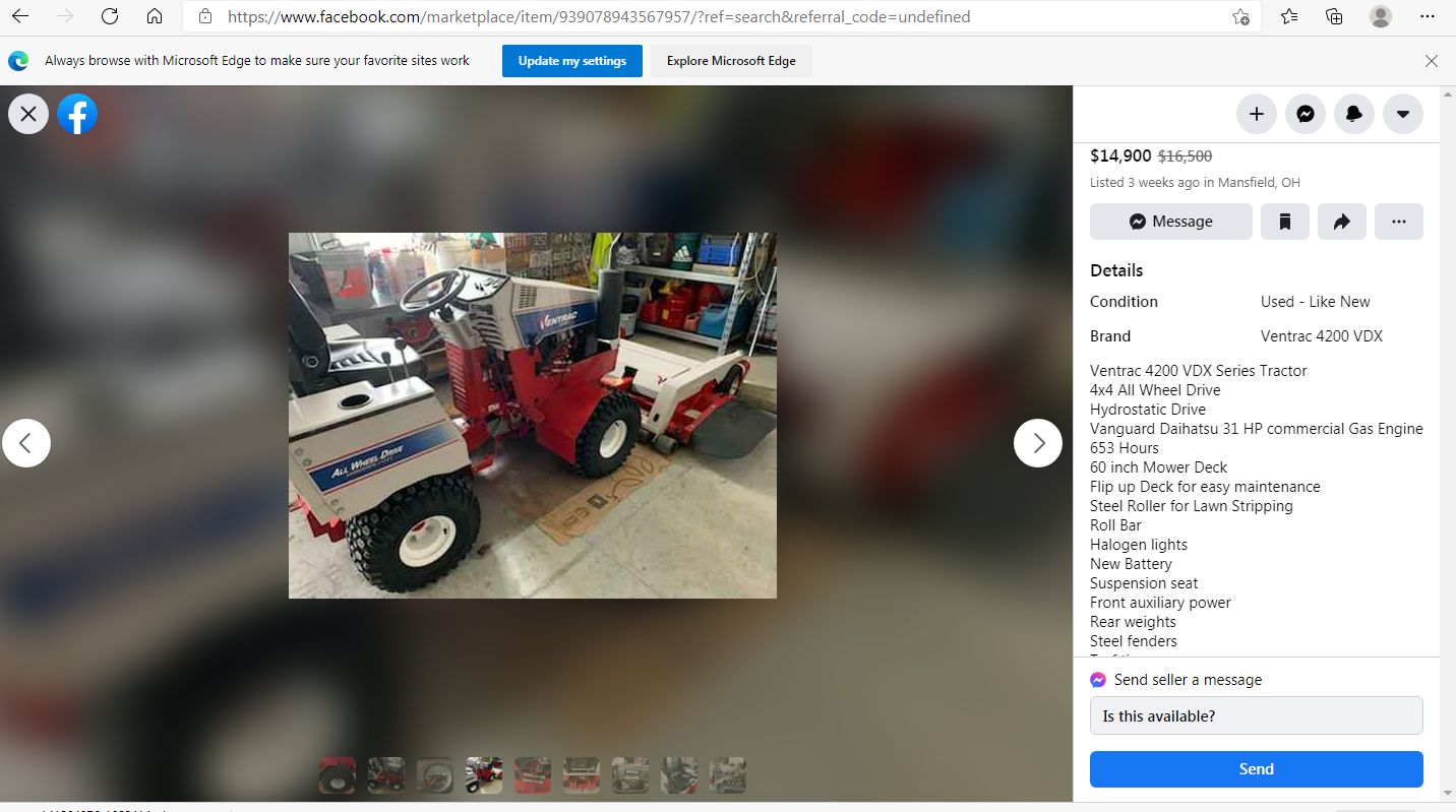

how about this one?
/ Found ;2014 Ventrac 4500Y #17
Looks nice, but like I said, the engine model would be of importance to me. And I wouldn't particularly want one with a turbo either.
