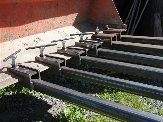

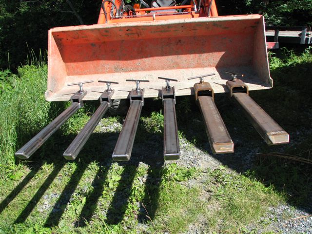

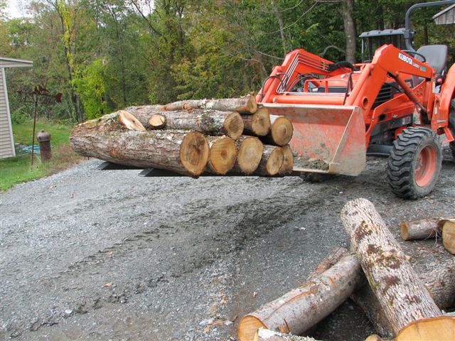

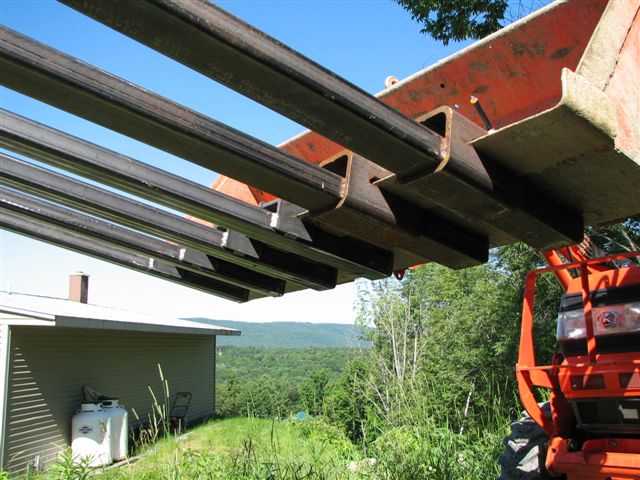

Theres a guy on NH Craigslist that makes very nicely built clamp on forks from 800lb rating to 2000lb, prices are the lowest I have seen. He uses a cnc plasma to custom cut the slot on the clamp assembly so that it fits the bucket, cantilevering the load between the slot and the underside of the bucket. The clamp screw is only there to hold the fork on, no load is on it. The lightest ones are made with 2 x 2 x 3/16" wall, 800lb rating, and only weigh 23 lbs each. Heaviest are 2 x 4 x 1/4" wall, rated for 2000lb, and are fairly heavy! Here are some pictures:
