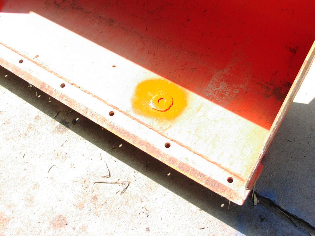

You can try welding a large thick washer on the bottom inside of the bucket to catch the clamp screw. Careful though, you can hit the forks hard enough to bend the screw. I have the forks from atvxpress on ebay http://cgi.ebay.com/Clamp-Loader-Bucket-Skid-Tractor-Pallet-Fork-chain-/290480699612?pt=LH_DefaultDomain_0&hash=item43a1ffb8dc
I also welded little vertical "wings" on the sides of the forks that hit against the bucket lip to keep the forks aligned. I can take a picture and post it tomorrow.
