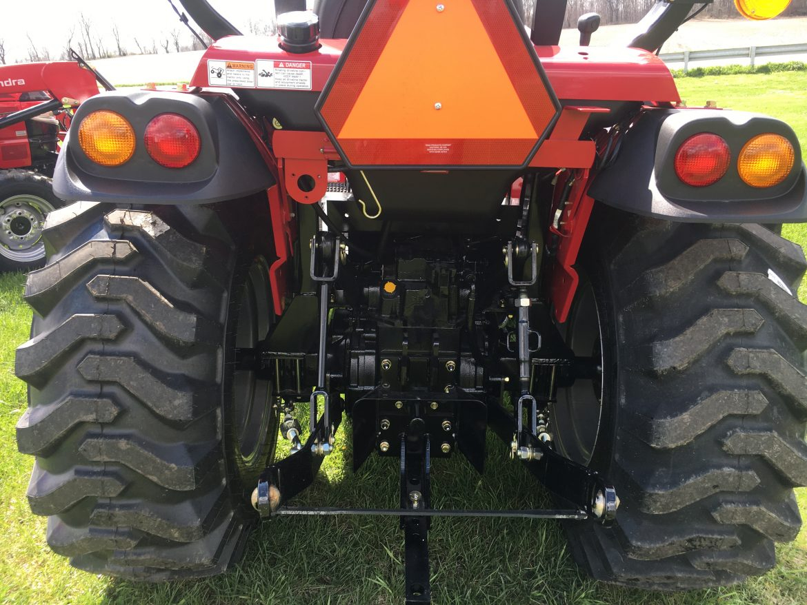

Thanks everyone for the warm welcome. I think the rest of this is still connected to the tractor or at least, it looks that way to me.
If something still looks wrong, please let me know. thanks!

Some people are just lucky, problem is, I'm not one of them. You still have the issue of the pins and clips that hold the piece on the lift arm. So was the lift arm dragging or was it not on because the backhoe is on?

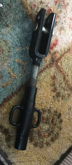

You got lucky , you seem to have all the major parts, be sure when reassembling to safety wire upper section to lower section (across adjustable center section) so it can not unscrew again (my preferred method if adjuster is not connected on one end) ....

Yes, that is the upper part of what you found on the ground. You even still have the jam nut on the upper portion.
Personally, I would remove this and the Left side one (most likely a fixed length). I suspect the lower lift arms were removed with the backhoe install.

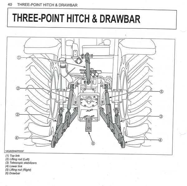

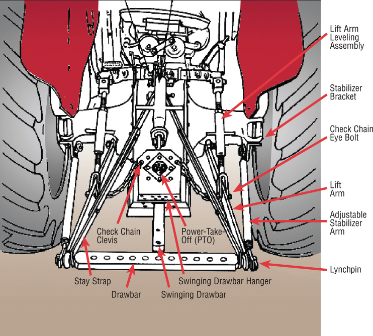

Everyone here has been great. Thanks all for the diagrams.
I have taken about 30 pictures all over the tractor and I think you are all correct, I think it is all there.
I will remove these items in the morning before heading back home for the weekend.

Greetings everyone,
My first post and of course, it comes with a question.
I just bought a used tractor with 80 hours on the clock.
(Mehindra 2638 with FEL and backhoe)
After adding 4 hours on it, I found this on the ground and hoping someone will know what it is.
It's about 10" long. Opposite end has internal threads and hoping it is something for the 3 pont hitch.

That is the top adjustable link on my John Deere, When I'm not using the 3 point connection, I secure all components so that they will not come off.

Welcome to TBN. Couldn't tell from the picture. Check to see if there is a grease zerk on it. Keep it greased an screwed in more - It should stay on. Glad you found it. Larry
