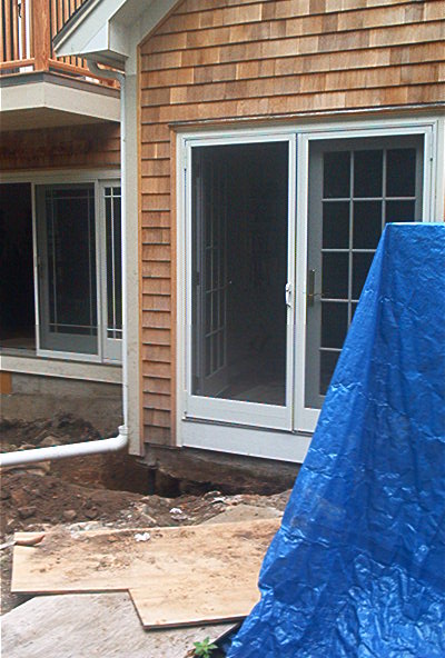

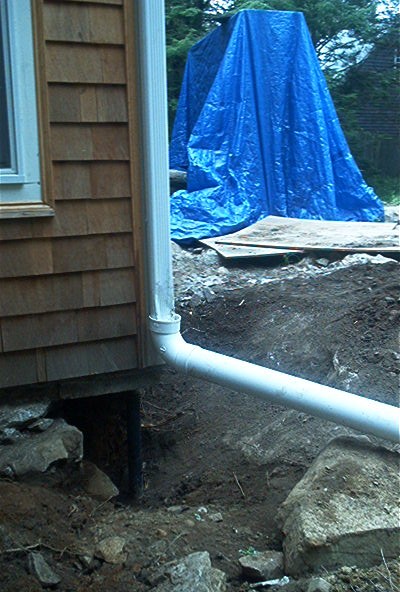

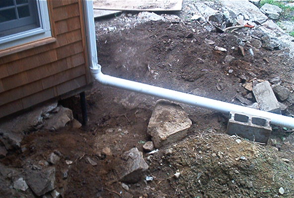

Pictures: I decided to support the corner myself. It only took about 1/2 hour. You can not really see the support post, but you can see the rock wall sloping under the house. I cut a slot in the slope uner the corner of the house and put a steel adjustable post under it and cranked it up. Worked like a charm! Everything back to level!

another

one more
