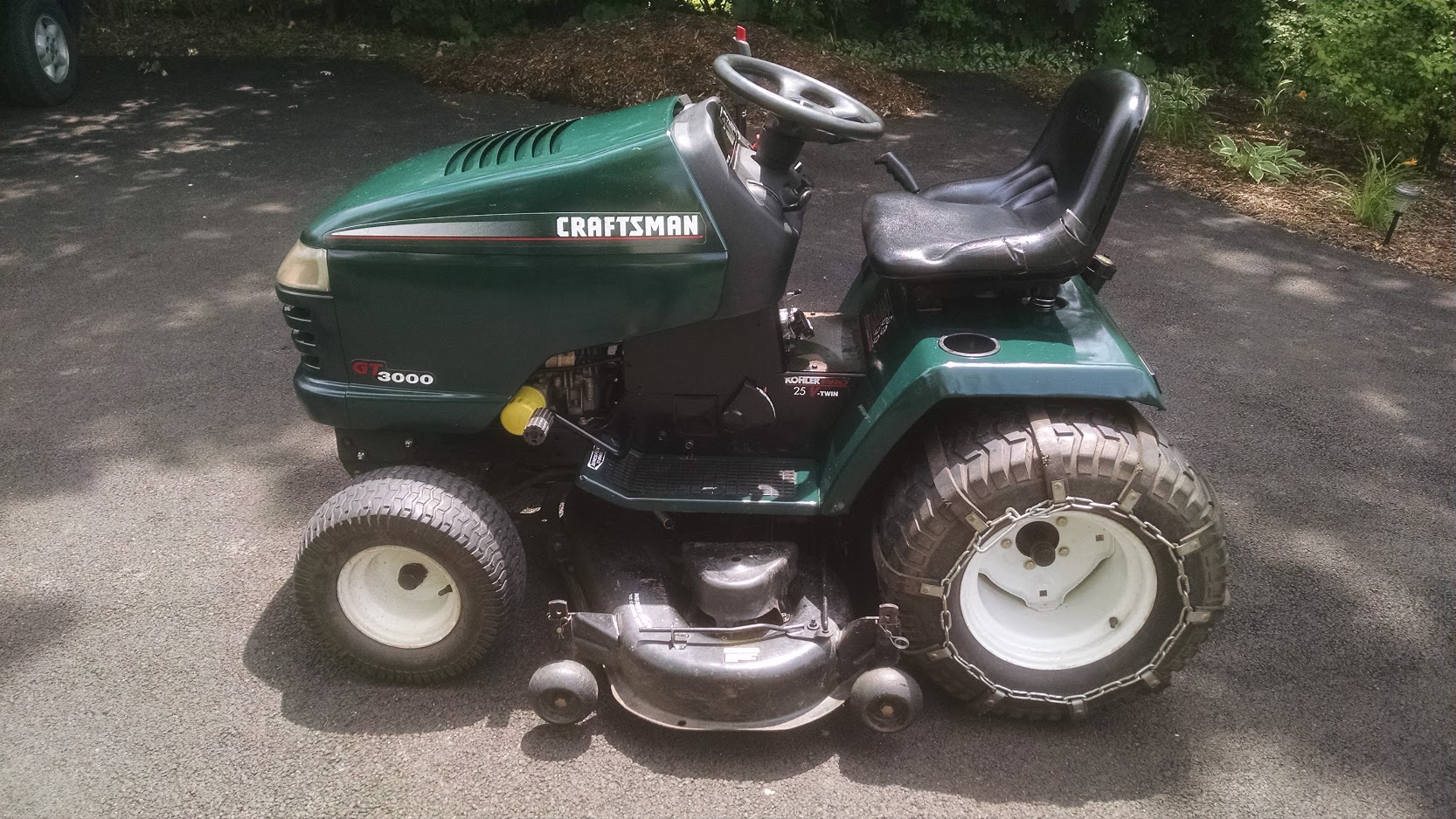

I got them instead of regular chains because I got an asphalt drive, and that tractor was doing plowing duty in winter. Mine stayed on no problem, and I had them on year round. When I first put them on, I deflated the tire somewhat, got them on snug as I could, and then they were real snug when I reinflated the tire. The only downside is that the ride is pretty rough with them on when going on paved areas, but that's to be expected.
To kthompson, I think you could maybe do well with a garden tractor with locking differential, that feature made all the difference in the world to me. My house is on a hill and then the property slopes down into wetland which I do mow (when it's not flooded). And then there's the pond down there with muskrats tunneling into the banks. So yeh, very uneven ground, with lots of moisture in it.
This was my first tractor here:
I'd get stuck with it all the time before I got the terragrip chains. I wouldn't even risk mowing if my wife wasn't home, pretty regular I had to call her to come out and help me dig the sucker out lol. Getting the terragrips helped for sure but I'd still get stuck sometimes.
Now I mow with a new craftsman gt with locking differential, it's like night and day. I still occasionally get stuck (barely ever), but every time it happens now I have myself to blame. I see the ground is wet there, I know it's soggy, and then I still plow into it...and then I'm like no sh^1, sherlock! And then I go call my wife. :D

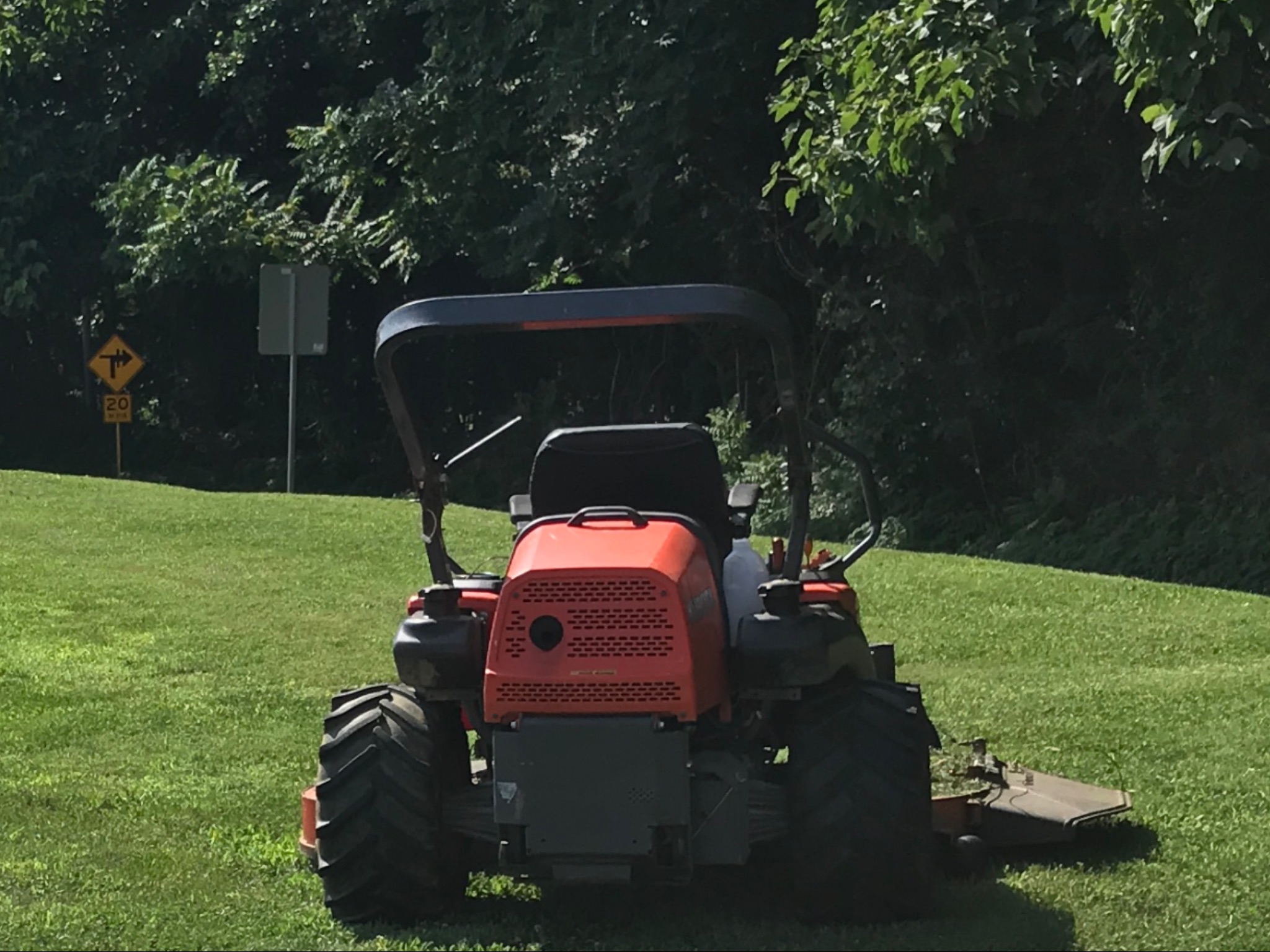

Kevin I added these to my zero turn. I can cut anywhere now. The only issue is you have to have a light touch on the steering, or they will shred your turf.
