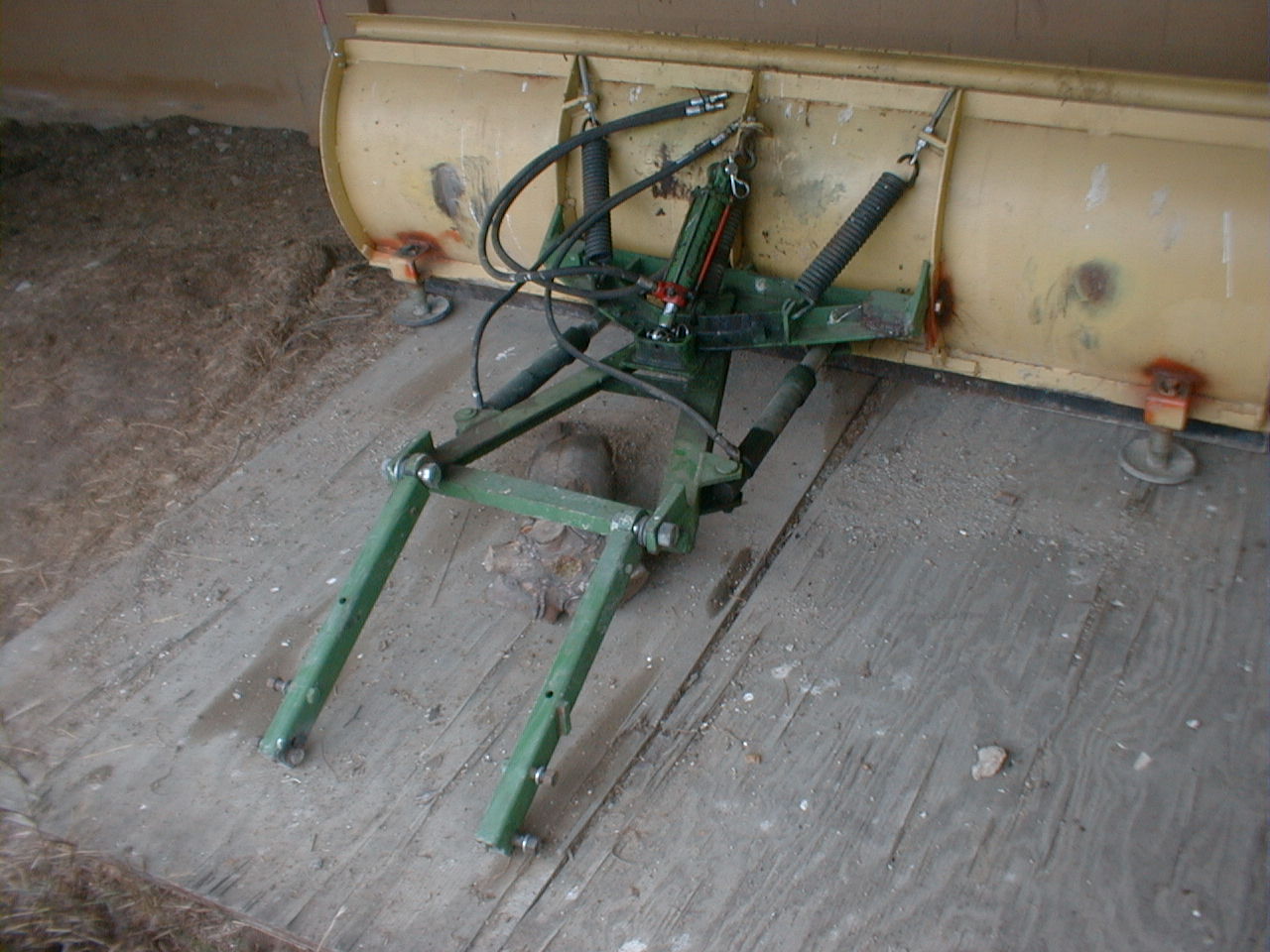

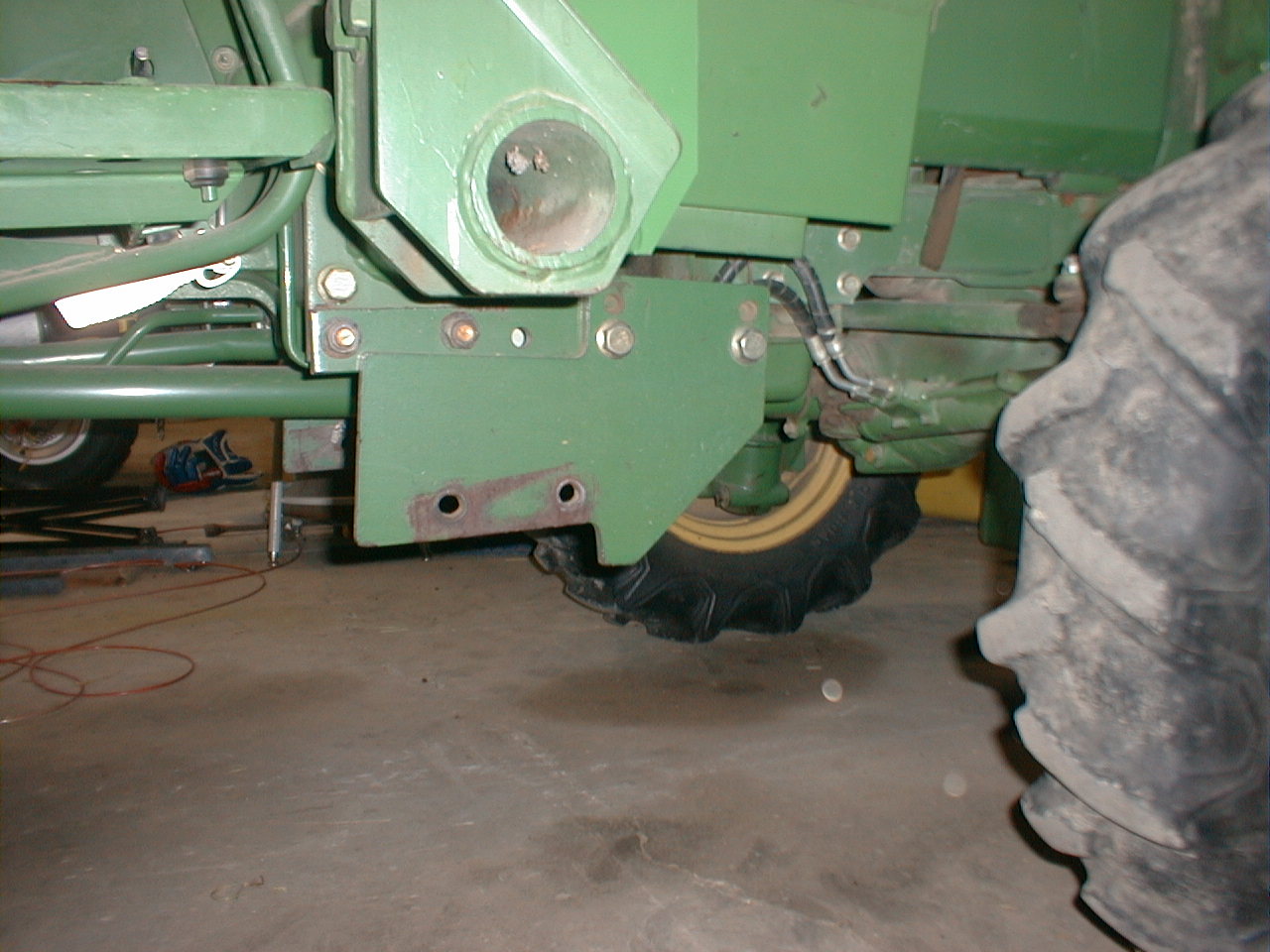

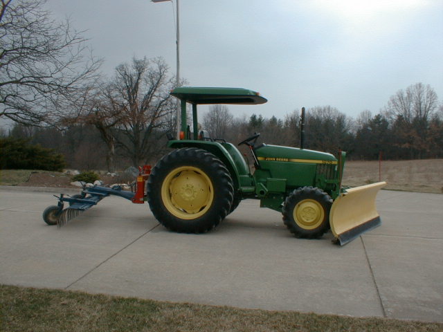

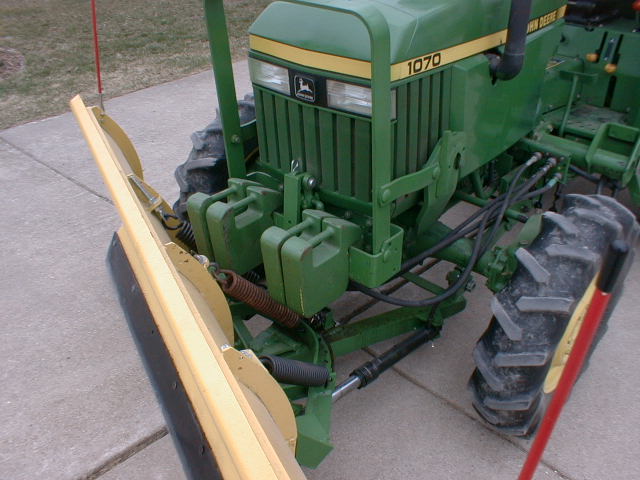

I didn't find it to be a big deal. Just some simple drop arms to locate the truck pickup points and a lift cylinder off the front weight bar. I run the stock plow cylinders via brake hose sized lines to the loader connections. I like downforce on the plow. The plow usually floats along as the valve stalk has a float position. I can run in top gear down the driveway and onto and beyond the road if necessary. I've even outrun following cars a few times. I also use it to move gravel around on the driveway as necessary. This is not rocket science. I set the shoes abou 3/4 inches below the blade to keep from scalping the gravel. With the plow at 45 degrees, deep, wet snow runs away from this setup. A little hard on the mailbox, though...
I put the york rake on the back for gravel maintenance. Comb it inward with the plow, spread it out and crown it with the rake.

Hey, the whole build was posted way back with appropriate comments.
I even welded up the blade a la DIY for about $200. or so.
My installation calls for removing the FEL bucket and the lift is generated with a short length of chain from the loader cross bar to the plow frame.
The whole seasonal change over represents about10-20 mins. and truthfully I would not change anything except I did add a side plate to one side of the blade to control spillover when I cleared large surfaces.
