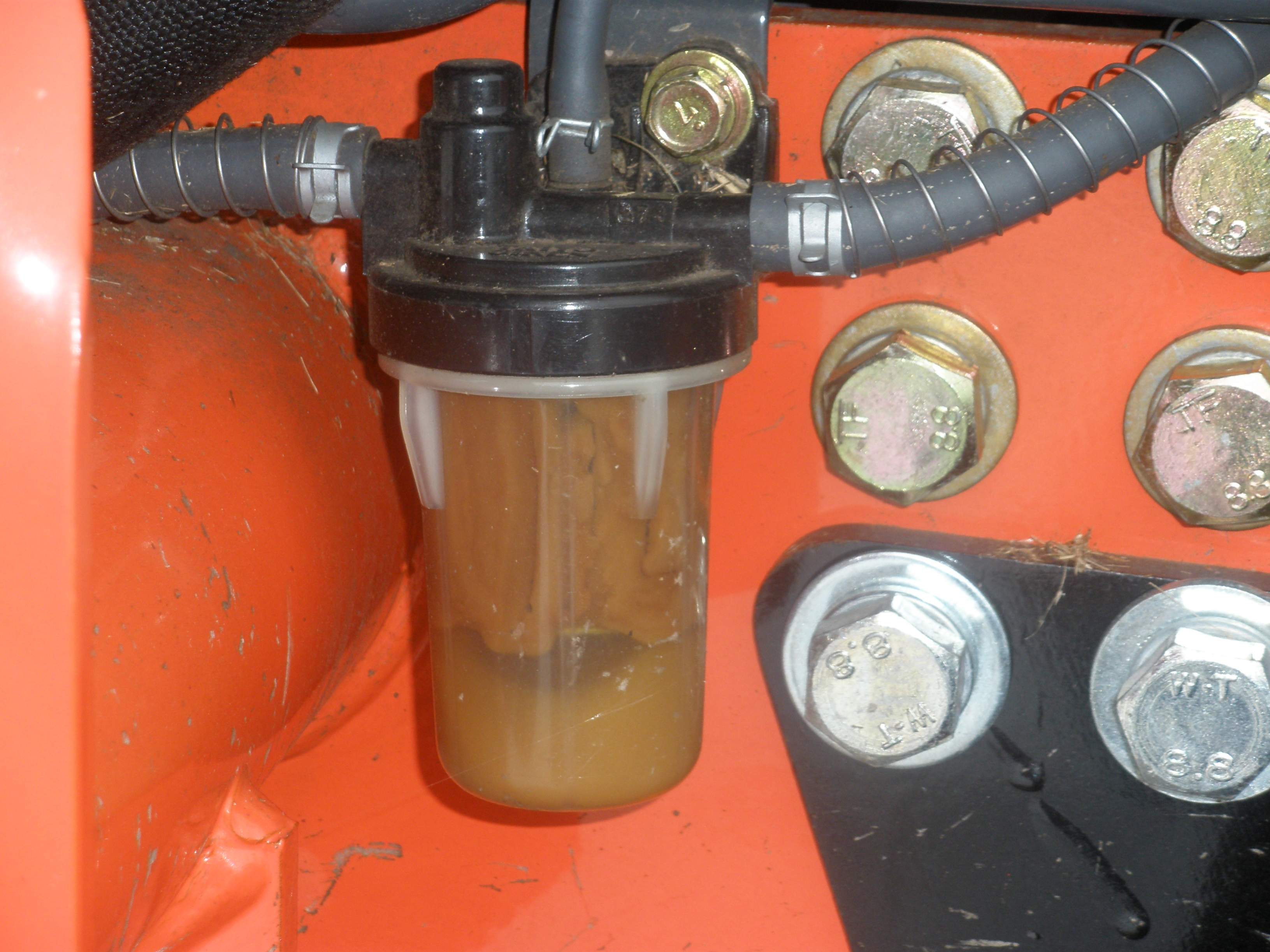

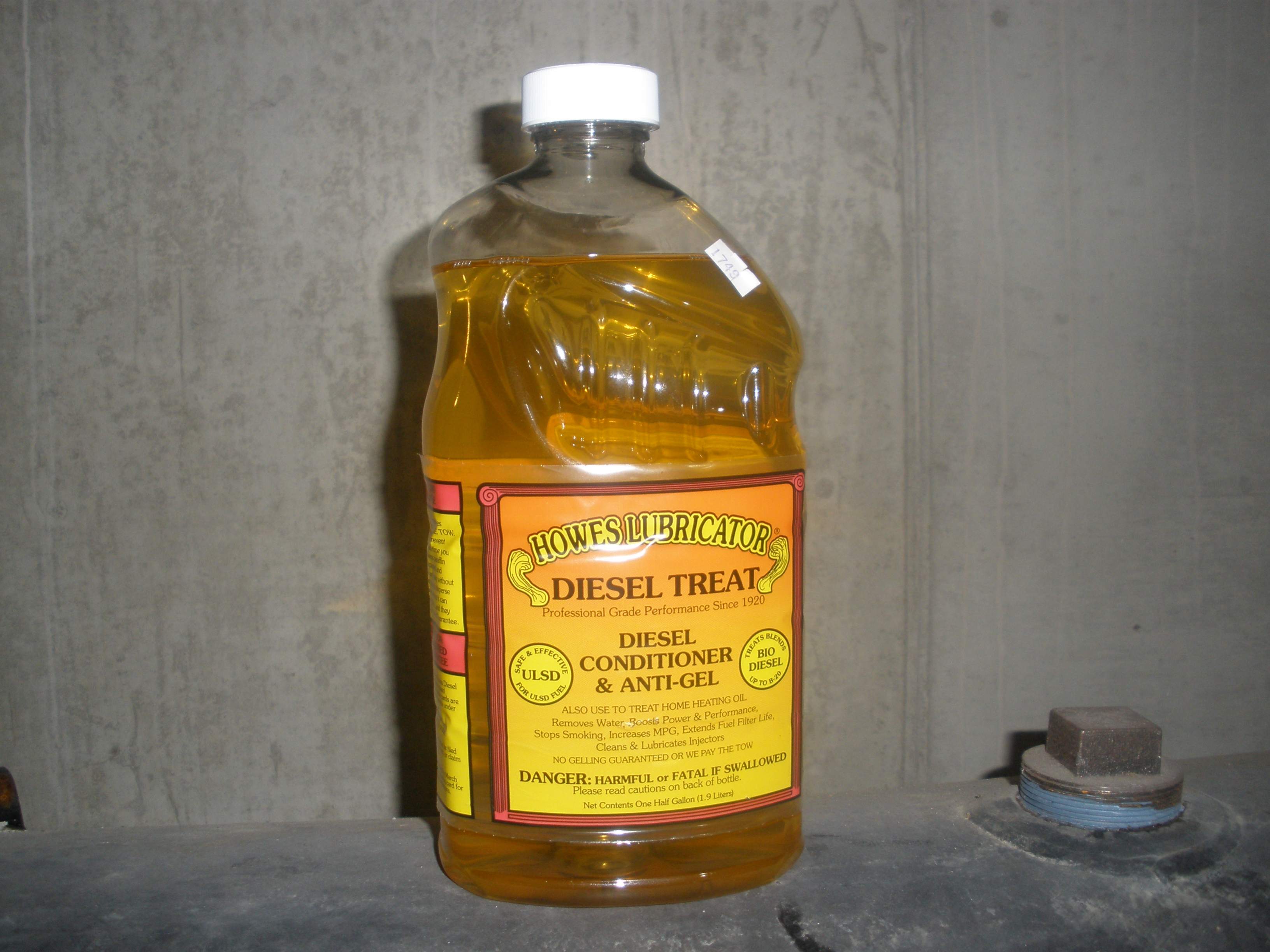

Howes diesel worked for me. Last winter my Kubota was kept stalling out due to gelled fuel in 32 degree weather. i bought Howes and added a small amount as per the directions. After circulating in the engine for only a couple of minutes the engine stopped hesitating and stalling out. Ran perfectly after that and did not have to change any filters or fuel. here is a picture of the fuel bowl before adding howes.

That one picture is worth thousands and thousands of words. It's the "poster child" for adding diesel additives for cold weather. Thanks for posting.:)
Diesel additives aren't going to do much for that. That is frozen water, not gelled fuel. That is far more water than any trteatment will cure, and at any rate, even dispersed, treated water must be jammed through injectors and pumps to be eliminated from the system. Due to the size of water molecules, this is very hard on equipment. When I was farming ( and actually to this day), every diesel I own got a fresh fuel filter sometime between Halloween and Thanksgiving. That way, any collected water residing in the filter or filter bowl is disposed of. Fuel gelling may also be a problem in this instance, and treated fuel is also a part of the answer. I don't mean to suggest clean summer fuel would work in these conditions. It would likely gel even without the water problem.

I also agree that your photo looks a lot more like solid ice than merely diesel wax. Cause? Stored outside. Condensation. Watery diesel in the first place. Take your pick.

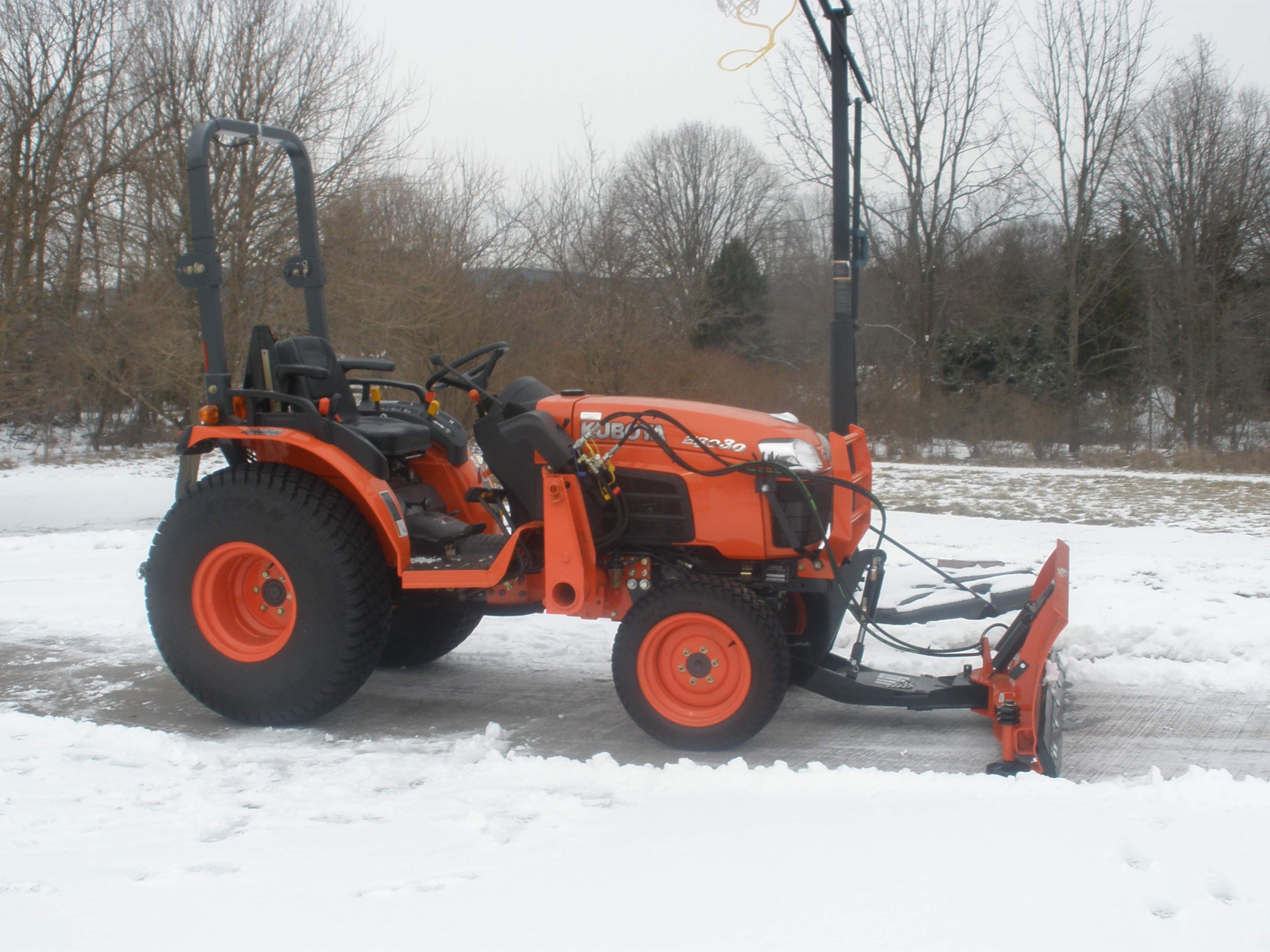

After I added the Amsoil stuff I got the hairdryer out and warmed up the fuel lines, bled them and it started but was running crappy and eventually stalled. so I got some fresh fuel and topped off the tank and proceeded to clear my drive for a couple of hours with out any problems. Now the TC24 is tightly parked in the barn :).

It was time for the 50 hour service 450 hours. and the fuel was probably 6months old, so definitely summer fuel. and sat for quite a while at 1/2 tank. 20/20 my problem was obvious.
