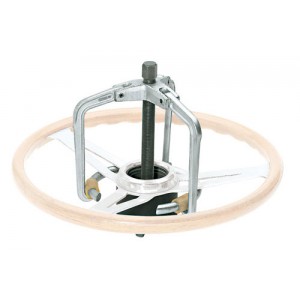

I have an old puller I inherited from my dad that has 2 different sized split rings which could be placed behind the steering wheel then the arms of the puller would hook on the ring to pull with. You put tension on the ring then tapped the center bolt to pop the steering wheel loose. Again pre-treating it with penetrating fluid would be wise.

Well I tried the heat-n-hammer approach, to the point of almost melting the darn wheel. So I decided to drill holes in it. Next I got some 5/16" bolts washers and nuts. I got a piece of 1/4" flat steel I had laying around. Drilled and tapped a 3/8" hole in the center, and ground the end of a 3/8" bolt to a point, and threaded it into the steel. Next I drilled a 3/8" hole about 1 1/4" from center of threaded hole, one on each side. Then I run the bolts through the plate and steering wheel, and backed them up with washers and nuts, run up tight to the wheel.
I started cranking the threaded bolt into the steering shaft, and got to the point I thought the wheel was going to warp badly or break, and POP off it came. When I got the wheel off I looked underneath, and realized just how close it was to breaking. But it's off!

That split ring puller would have done the trick. I tried to figure out how to rig one of those up but couldn't do it with what I had around here.
