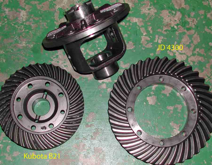

Note that neither tractors nor cars/trucks use this kind of gear in their differentials. At least as far as I have seen. If anyone has pix of a differential ring or pinion gear made like the OP's hub gear, please post it. Whether it is my Kubota or my Toyota pickup, you are going to find machined ring/pinion in the diffs, and careful attention to tooth contact patch will be necessary in any repair.
That's what we're trying to say for a couple posts now.
Those sintered gears are only used on the final drives of the front axles on tractors that don't use planetary drives.
