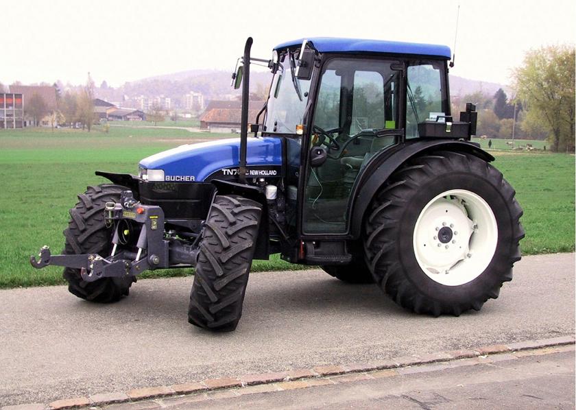

TN has mechanical front lift, produced by SAUTER.
Front PTO, electrohydraulic engaged, is mechanically driven from front side of crank.
