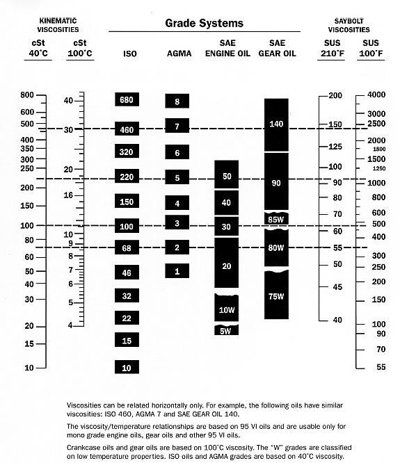

Many people have trouble accepting this. Sorry, it is not opinion, It is fact. Test them for yourself.
80-90w is not dark, and does not have the familiar burnt smell. Those are the heavy gear oils.
You must not have worked with much 80-90W. It is clear, and thin.
Here is a chart that shows what I am talking about:

I've worked with 80-90 and the heavy gear oils in the past, as I've had many Model T's and A's. They all took 600w gear oil but sometime in the 1980's it was decided that the 80-90w was just as good and I've been using that.
Granted I haven't done much work on them in the past 20 years or so, so maybe the 80-90w stuff has changed, but back then it was much thicker and darker than what is called hydraulic tractor fluid (30w) today.
The UTF stuff I just put in my tractor is a clear light yellow color, almost the color of urine and that's not the way I remember the 80-90 stuff I used before...it being very dark and thick...and smelly...not as dark, thick, and smelly as the old 600w but sufficiently so that it's easily recognizable as gear oil.
Perhaps the stuff has changed as I haven't used any 80-90 for a while. My restoring old car days went away as I tore off more and more pages of the calendar.
Your chart does show that the 80-90 stuff starts at the very top of the 30w range and goes up to the 50w range. I would have expected it to be much higher up the scale based on my past experience.
I bow to your knowledge of current oils.

Your chart is proving you somewhat differently. Viscosity testing is normally rated in kinematic centistokes (cSt) at either 100'C or 40'C on the left (more common) or Saybolt Viscosities on the right. What you are trying to show (which is correct) is representing SAE engine oils with other ratings(ISO, AGMA, SAE Gear oils,) within the different rating standards at those given temperature ratings. You are right in that ENGINE Oil ratings are not the same as GEAR oil ratings, however, you are ill advised in making the assumption that Tractor Hydraulic Fluid is an SAE ENGINE oil and comparing it to an SAE GEAR oil. Tractor Hydraulic Fluid is not represented in the chart.
So, to be fair lets look at what brand X rates their viscosities are at 40'C and 100' cSt. ... I did a quick internet search and found:
http://www.sinclairoil.com/pdfs/pds/universal_tractor_hydraulic_fluid.pdf
Mobilfluid 424
The specs for Sinclair brand shows 63.53 @ 40'C cSt and 9.76 @100'C cSt. The Mobile 424 shows 55 @ 40'C cSt and 9.3 @100'C cStwhich puts it closer to an AGMA 2 or ISO 68.
Conversely an SAE multiweight gear oil such as specified 80W- 90 is rated higher at 147.7 @ 40’ cSt and 14.7 @ 100’ cSt- closer to an AGMA 4 or ISO150 (needless to say 85W-140 is even higher at 371.1/26.96 @ 40/100’ cSt)
http://www.sinclairoil.com/pdfs/pds/automotive_gear_oils.pdf
https://mobiloil.com/en/gear-lubricants/mobilube-hd-plus
Conclusion: Universal Tractor Fluid is indeed a lighter weight oil than 80W-90. You are right however, in what I think you are trying to convey in that SAE Engine and SAE Gear oils are in fact rated different.

As I said, viscosity varies dramatically. If you pick the right two products they will be closer. Compare the same product from different manufacturers, and they can be widely different. That is another thing people don't realize. Two 30w oils can have a fairly different viscosity.
For all intent and purpose, they are similar enough to be considered the same, in most cases.
I said, they are BASICALLY the same, and that is true.
And, as I said, if you do a timed pour test, you will not see significant differences. It's been done, to try and prove this wrong in the past.
Most people's conception of 80-90w is incorrect.
The technical aspects, and splitting of hairs are not important, as to the fact that either is completely interchangeable in this instance, as a front axle lubricant. All I am trying to convey is, the reason why is, they really aren't different.
Some refuse to accept it. I'm fine with that. Only trying to help those who are interested.
