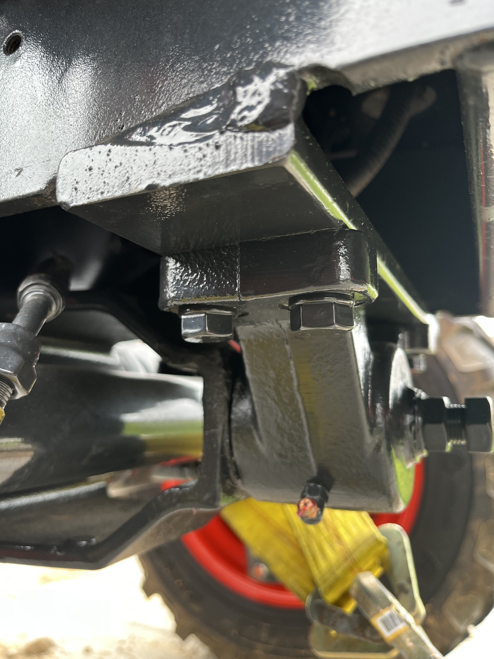

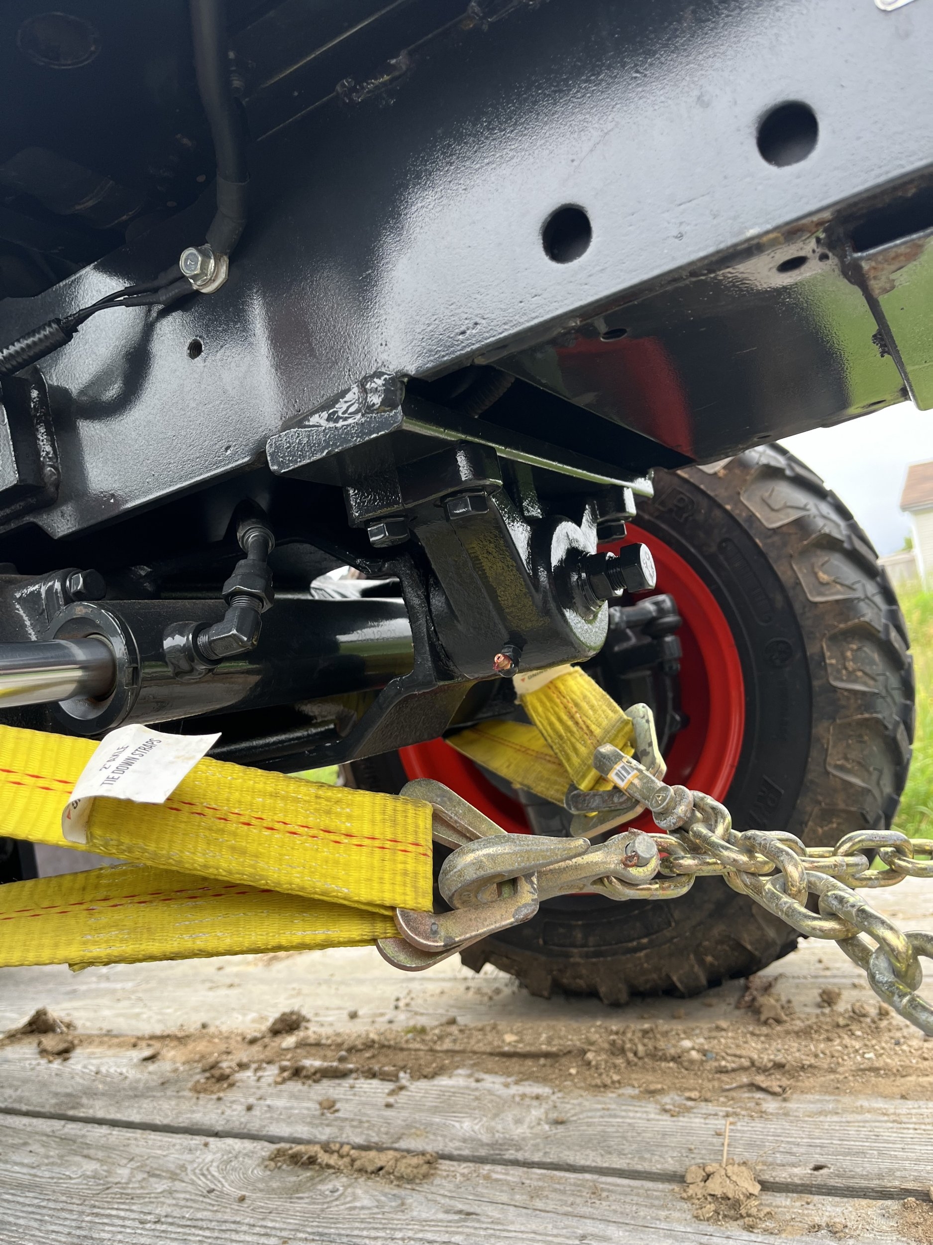

Ok thanks for the reply. After a closer look out side on my trailer, it looks as if the pivot unit may just unbolt with 4 bolts from the top and come right off. If that’s the case I may fix it anyways. I’ll post a picture so it is easier to see.

Oh it's the front one, yeah that is definitely easier than the other one and shouldn't take too long. You should be able to reuse the same o-ring. It usually doesn't damage it when it pops out.

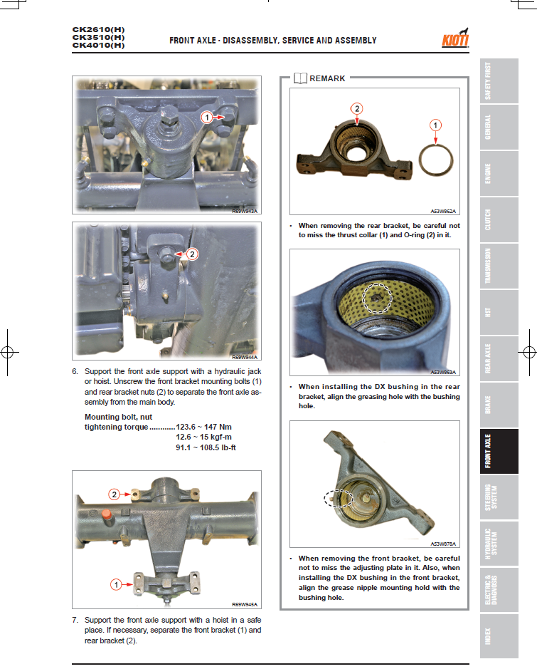

dfkrug's post kinda reminded me to take some screenshots from the service manual. Maybe it will help the OP as well.
It actually has 3 o-rings just in the front trunnion.
/ Front axle pivot o ring
#9
Thank you for the information and the pictures. I’m sure they will help. Much appreciated!
