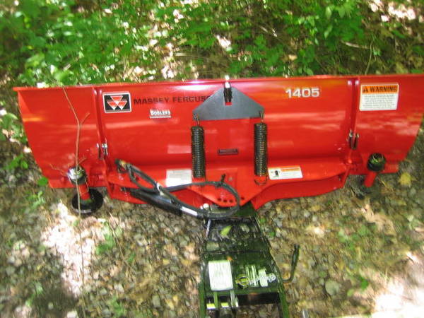

I have a 60" power angle blade on a 22 HP Honda, with Turf's and no chains. Depending on the weight of the snow it is good for most local storms. The last major storm left 20" - 24" in my drive. There was not enough power to push through for the first run. Given enough time and patience I probably could have shoved it off to the side bit by bit, but chose to use the FEL on the JD instead. Most normal storms are handled very easily.
Eventually pushing back the edges can become a problem due to sheer weight and the other thing with the front QA type mount is when lifted up to push back a high bank the blade, mount and front axle can ride up on the snow and it's quite easy to get stuck and have to dig the snow out from under the blade / mount / axle to get out. This can be sepecially annoying if it's blowing and snowing at the same time. I'd highly recomment the power angle feature.
