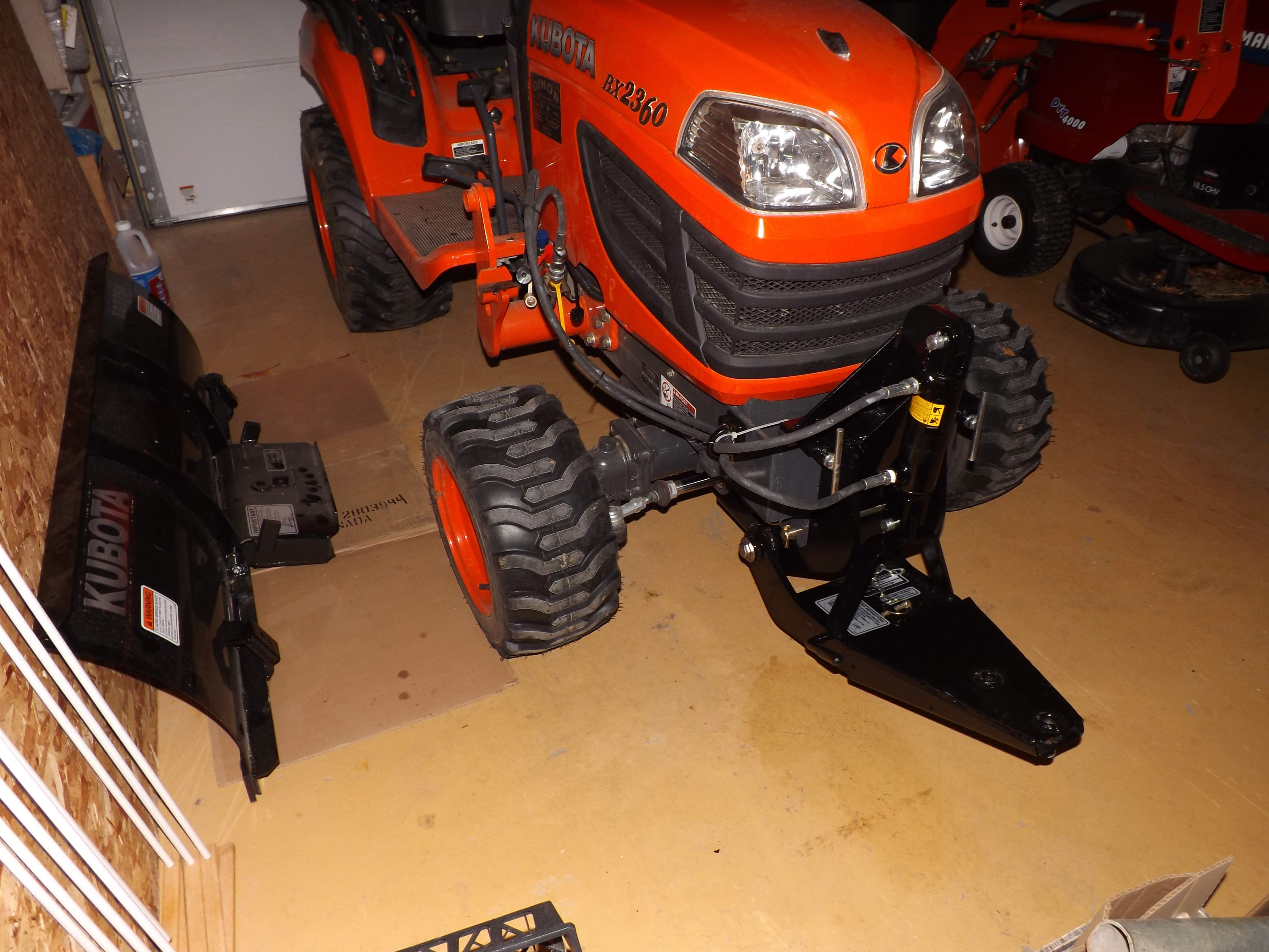

The QH is installed and the plumbing connected. All is operational with the quick hitch moving up and down correctly. Checked for leaks and sure, I had one. Got that fixed. So, that much is done and ready.

Update: Dealer called Monday and said the parts were all in, finally. UPS to my place, to save me the drive down. :thumbsup:
That Brown truck should be pulling up my drive this afternoon and we can get this thread, and more importantly, that blade project back on line. Neighbor asked if I was ready to order that second function hydraulic piston and get going on that. Soon, I said. Soon.
