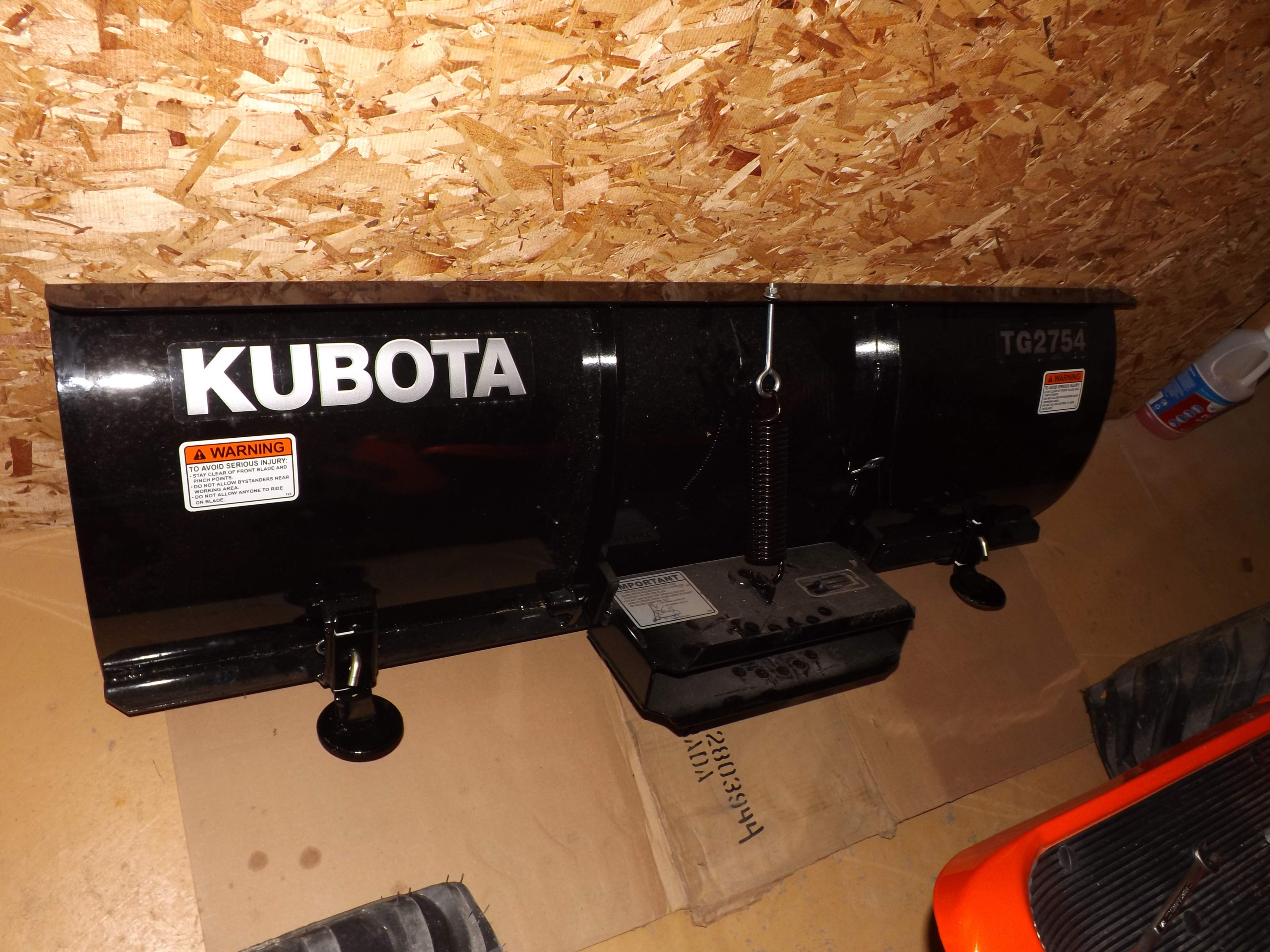

Parts have arrived!!! Not too much really, mostly the skid shoes, the trip spring assembly and the main pivot pins. Time to mount this on the tractor.

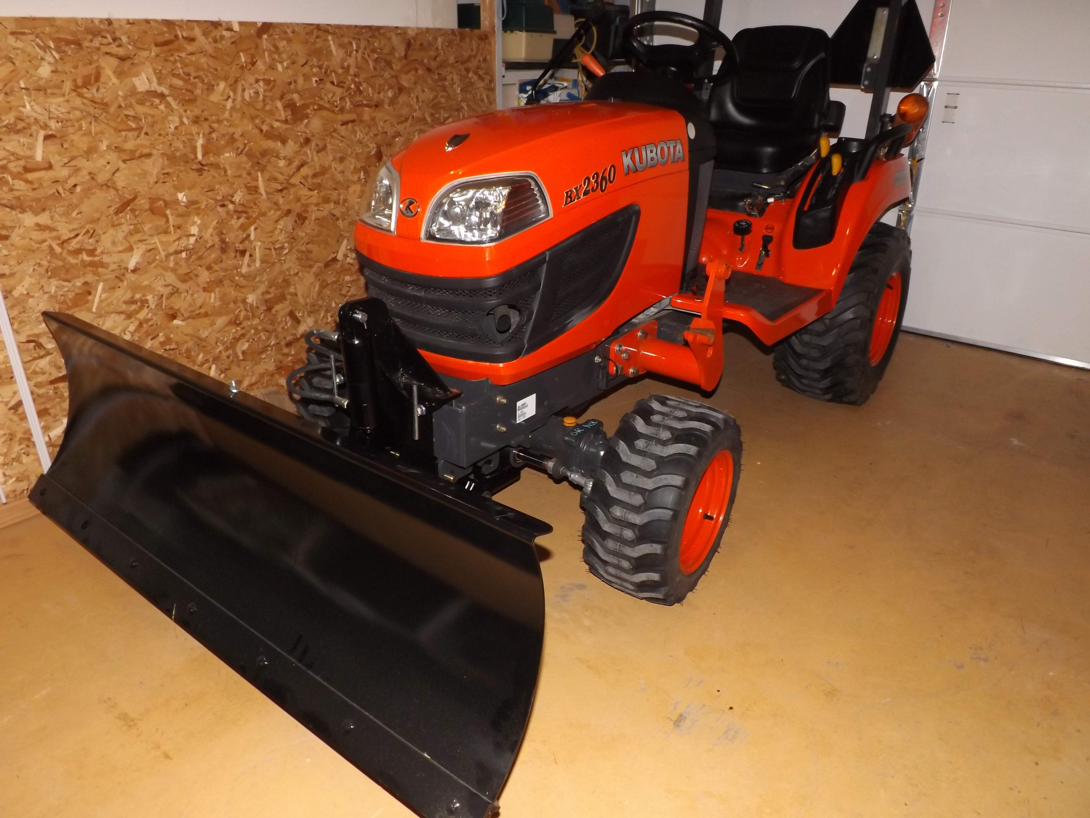

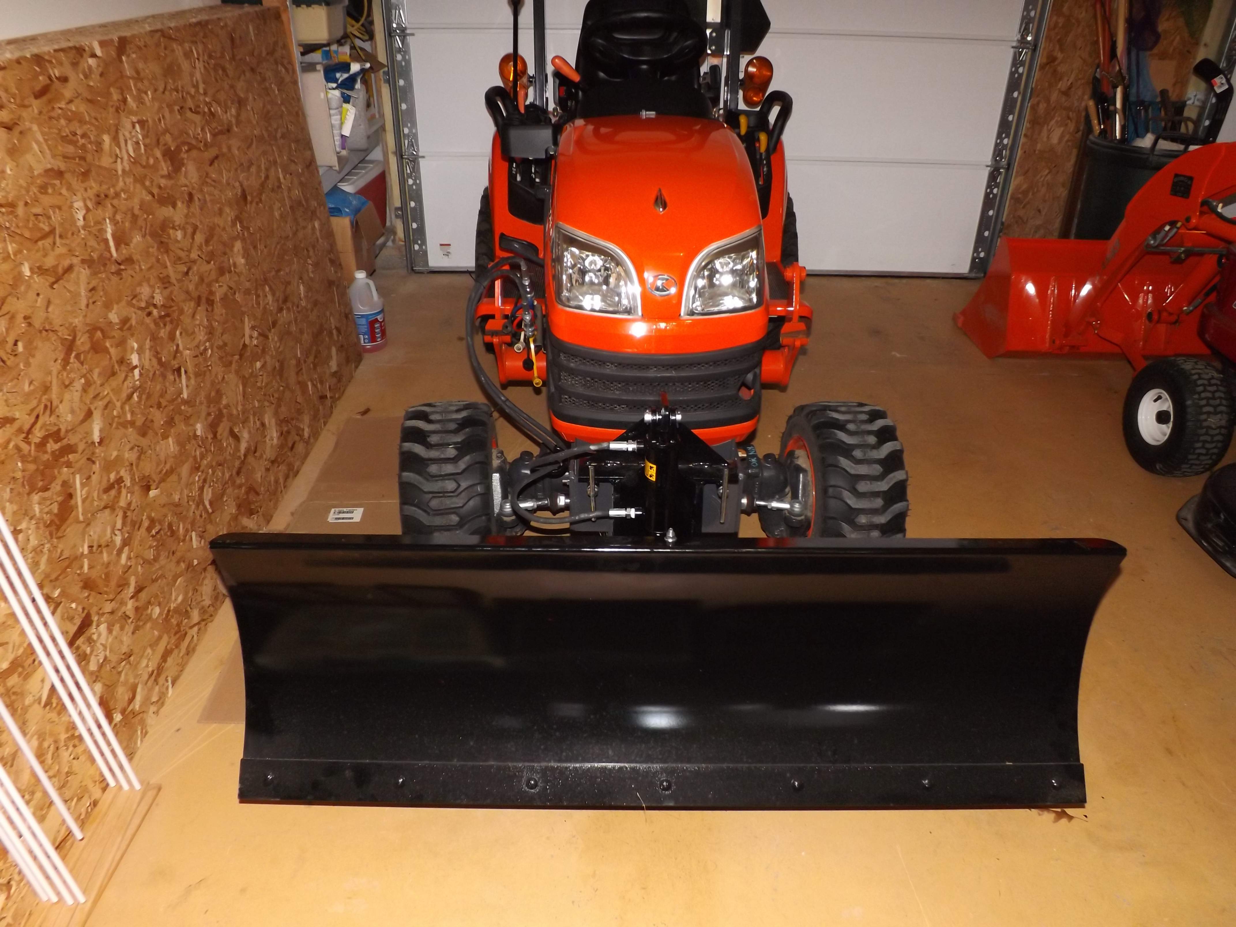

And there it is!!! Feeling ready.
Right now, the east-west is manual, but we'll get that hydraulic cylinder welded on and functional, but for now, it's just good to have this put together and ready to go. I still have to mount my wheel weights. Not today.

Exactly. While the unit is completely useable "as is", I do look forward to the adaptation. I did find the couplings, so now it is a simple matter of ordering a cylinder, probably from Surplus Center, and have some hoses made up, probably locally.
I'm sure the missing hardware package was not Kubota's issue. I suspect it got removed from this kit to supply some other kit, best I can figure, somewhere along the line. We'll never know. It's all good now and the dealer handled the matter well, if not with warp speed, but got the parts to me within two weeks of my calling them, so all in all, kudos.
