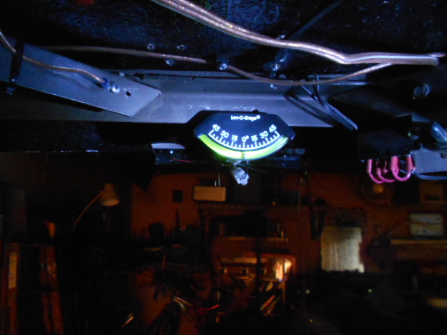

It looks like it lights up, do you have a web link? or do you have your own light shinning on it?
   / Front Bucket Cam, Gauges and Central Vacuum system installed on my Grand L 3240 #46
Wow been a long time ago. It came from a boat supply type in (Lev-O-Gage) think $10 or $12.. I supply the light
