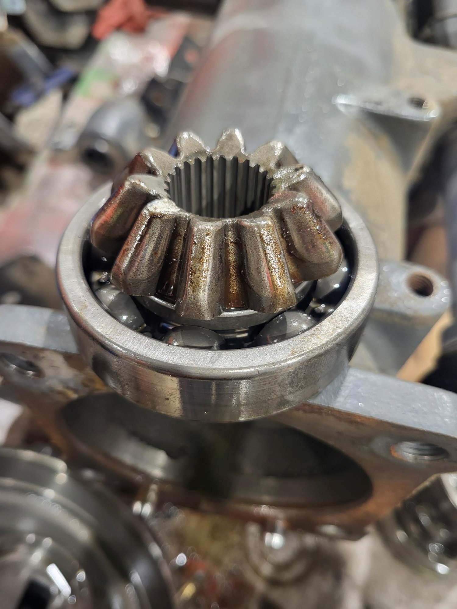

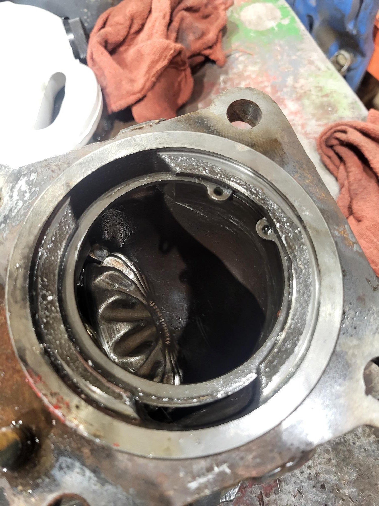

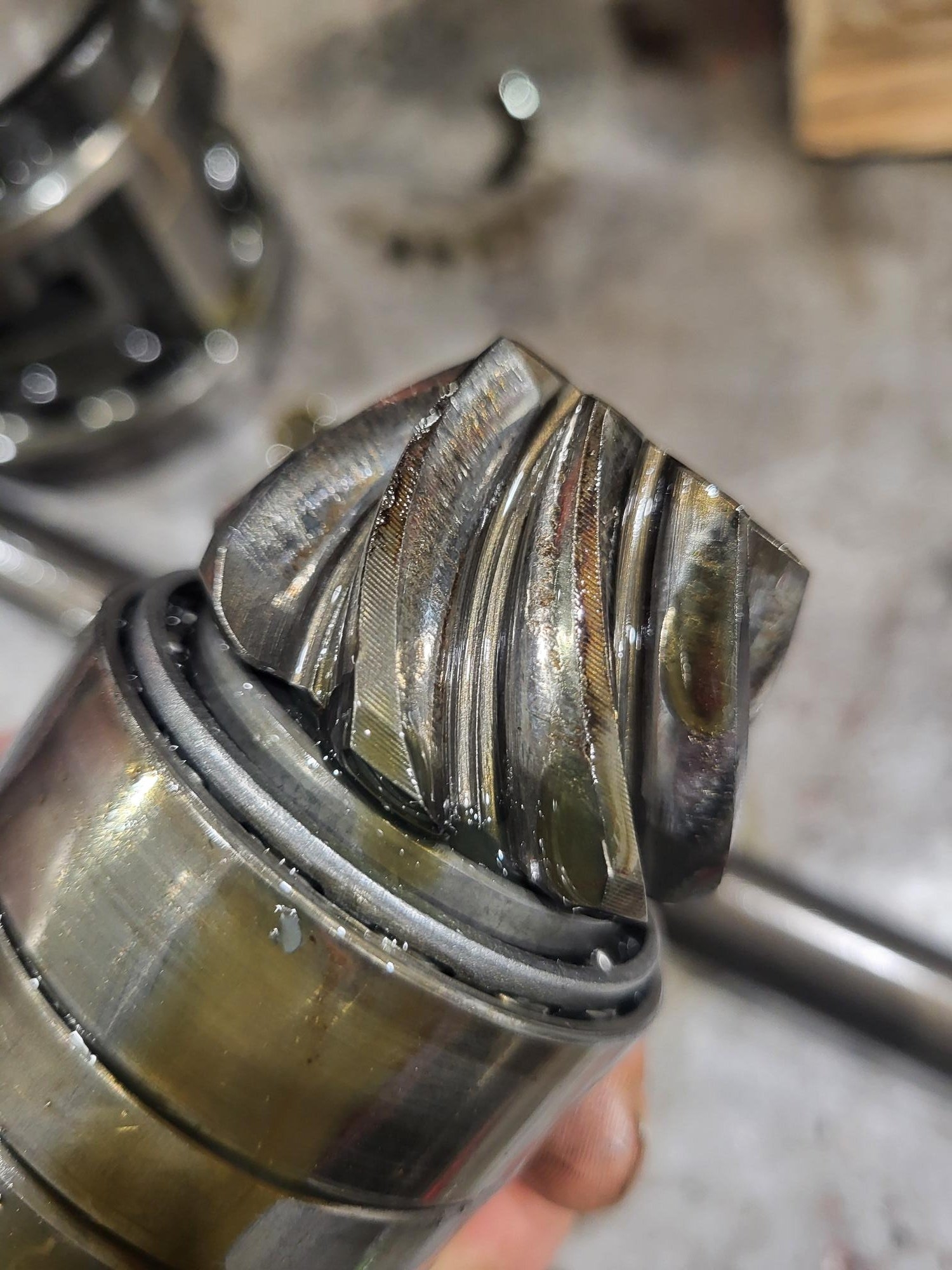

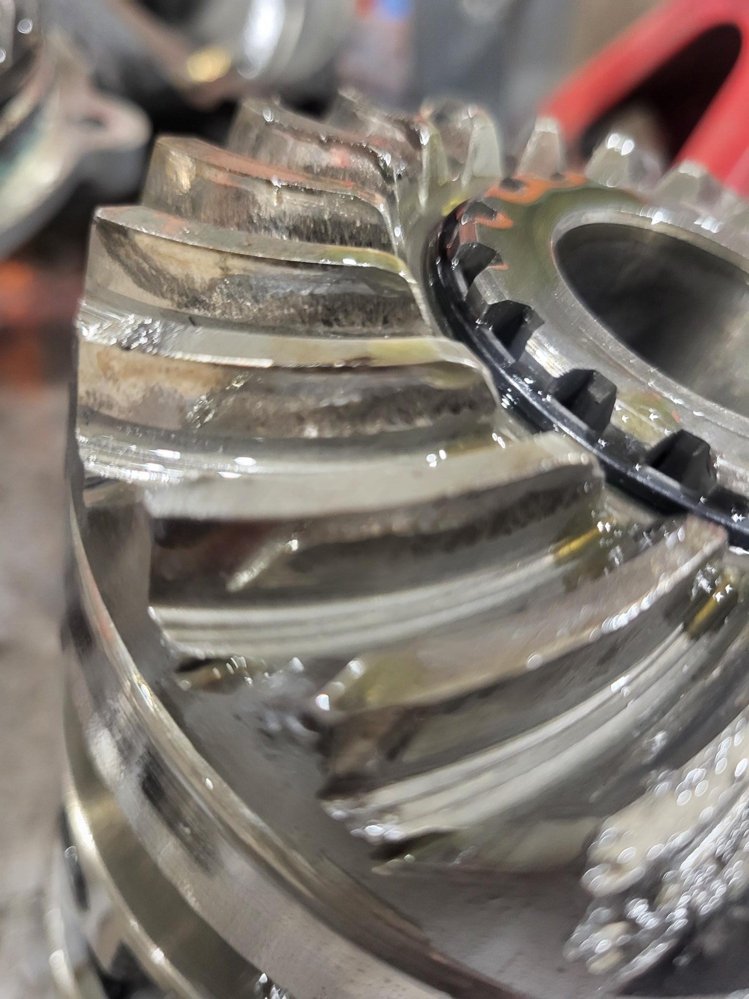

Some pictures

that looks bad. Sorry for your loss. I did notice when I changed my front axle oil that the level dropped quite a bit after just running it a little so it is important to check the fluid level fairly often and keep an eye out for leaks. I didn't see any broken housings in the pictures so a good cleaning out and replacing the gears and bearings should get you back up and running but it will be expensive. just compare the cost of fixing to the cost of a new tractor. If the rest of the tractor is in good shape I would fix it. you don't mention how many hours are on the tractor but a 40 series without regen is worth a couple bucks. It may be cheaper to find an axle assembly from a tractor scrap yard.

do you road your tractor alot, the gear teeth look worn out. obviously a bearing has failed but the gears seem quite worn as well, perhaps lots of use coupled with a too low oil level. I don't think the front blower caused it specifically but do you run a counterweight while the blower is hooked up? It is a lot of weight up front.

Kubota front axle assemblies don't contain a lot of fluid to begin with so it's imperative to check and maintain the fluid levels regularly. Looks pretty euchered to me but the housing looks ok. Surprised you didn't feel or hear it actually. Easy to check anyway, the center level plug and a single level plug on each outboard. Takes about 5 minutes total.

My 02 cents and I think this common across several brands of CUT's, that is that heavy loading of the front axle in 4x4 is causing stub axle inner or outer ball bearing stamped steel cage to wear / distort just enough to release ball bearing(s) at that point it is just a matter of time till the hard, high carbon chromium steel ball bearings find their way between gear teeth.
Then it gets ugly because the ball bearing is so much tougher than the average cast iron gear teeth, something has to give, so the real carnage begins.
In one of the pics a loose ball bearing is visible. If they look through the destroyed parts I would wager at least one mangled bearing cage will be found.
It sure seems like there should be ball bearings made with stronger tougher cages / larger shafts / larger bearings in general or the manufacturers should/could possibly be using roller bearings.
Not much a guy can do beyond checking/changing the oil often. I like to lift the front tires of the ground occasionally and check each side for any "New" play.
Op, I hope you are able to find a complete front axle at a reasonable price and for no further front axle problems in the future.
One thing is for sure you are not alone on this, it has happened to quite a few CUT owners of several different makes over the years.
4WD engaged, heavy front end loads, and sharp turns is all it takes to break a ring and pinion gear
I learned this expensive lesson on my old CUT. Ag equipment ISN'T construction equipment due to the lighter and less robust design
/ Front Differntial failure L3940 #17
That is another CUT design difference Very small diameter front 3rd member ring and pinion dimensions.
Some housings aren't even any larger in the center section than the outer axle tubes to house the center differential ring and pinion and spider gear. 50 HP running through very much miniaturized gear sets.
As you said, in 4x4, heavy FEL load, and a turn puts a lot of stress into the front drive and tractors do not have a transfer case (with differential action) in between the front and rear axle, so at least one front tire has to slip during a turn.
