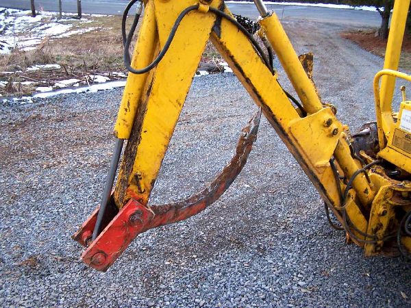

I was going to have something like this fabricated for the FEL/backhoe unit for stump removal... thoughts? or something larger out of T1 steel for an excavator...

Speaking from experience here. You do not even want to consider driving 14k pound rubber tire hoe on any ground that either currently has or recently had standing water on it. Even a 4x4 unit will get bogged down fast in those conditions.
I would suggest a tracked excavator of some sort. My 3.5 ton machine will make reasonably quick work of stumps and will go in wet areas well but I would think it a bit small for 86 acres of stumps. In your case I would suggest something larger. Get a thumb and use it for your stumps, your digging, and for any heavy clearing. Back it up with a large wheeled skid with over the tire tracks(if you will be spending time in the mud with it) and rent a dozer as needed (dozers are hugely expensive to maintain.) Honestly I would forgo the tractor in your case and just get the head for the skid for now. Having the mower out front makes them more suited for clearing heavy brush than a tractor.
Once the initial work is done you might look into a tractor in the utility sizes for general upkeep but for now I personally would go for the skid and ex combo until the reclamation work is done.
Having owned every style of machine mentioned in this post thats what I would go for anyway.
