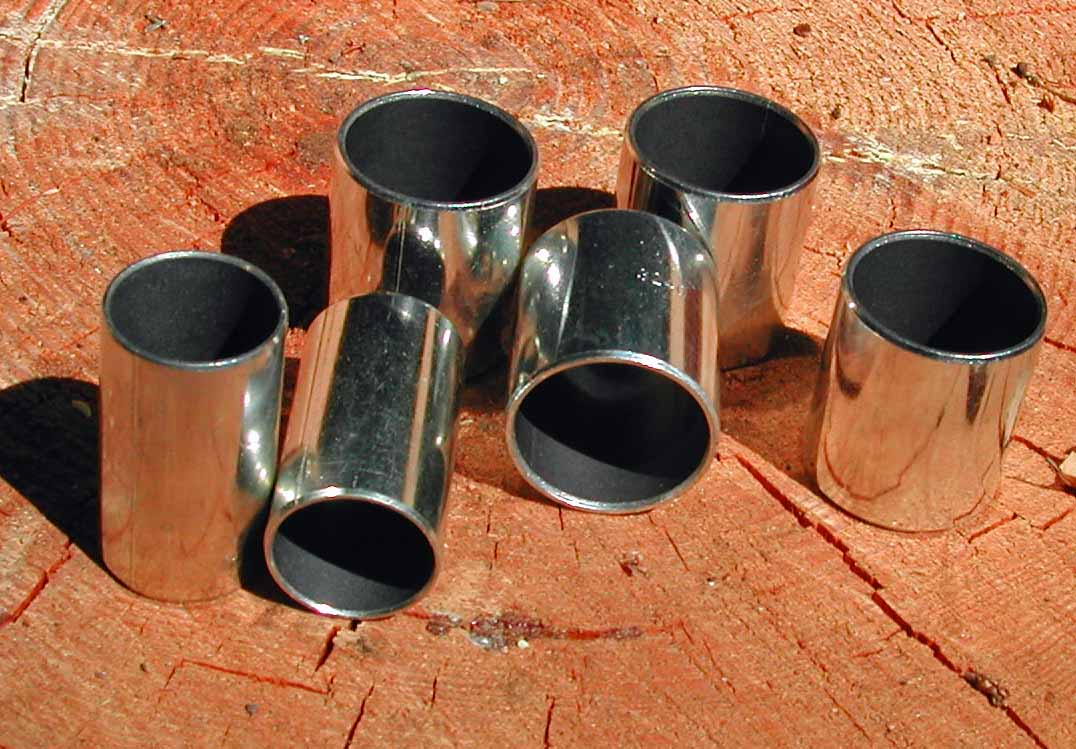

Nice that the industrial Kubota loader has replaceable bearing inserts, which are not expensive at all from a bearing supplier. I don't know of any non-industrial CUT loader that has these inserts. They are usually made of some amalgam of steel and bronze, and sometimes, teflon.
My aftermarket backhoe attachment does have them, and I have replaced them on the main boom pivot. Not easy, but it saves the pin, and boring/reaming in the field is much harder to do.
When I bought my tractor, there was no available QA for my loader, so I undergo the tedious effort of FEL implement change-over 2x/yr, and that forces me to clean out each pivot before re-inserting pins. Tho I grease plenty, cleaning them out keeps my wear minimal at nearly 1000 hours.
