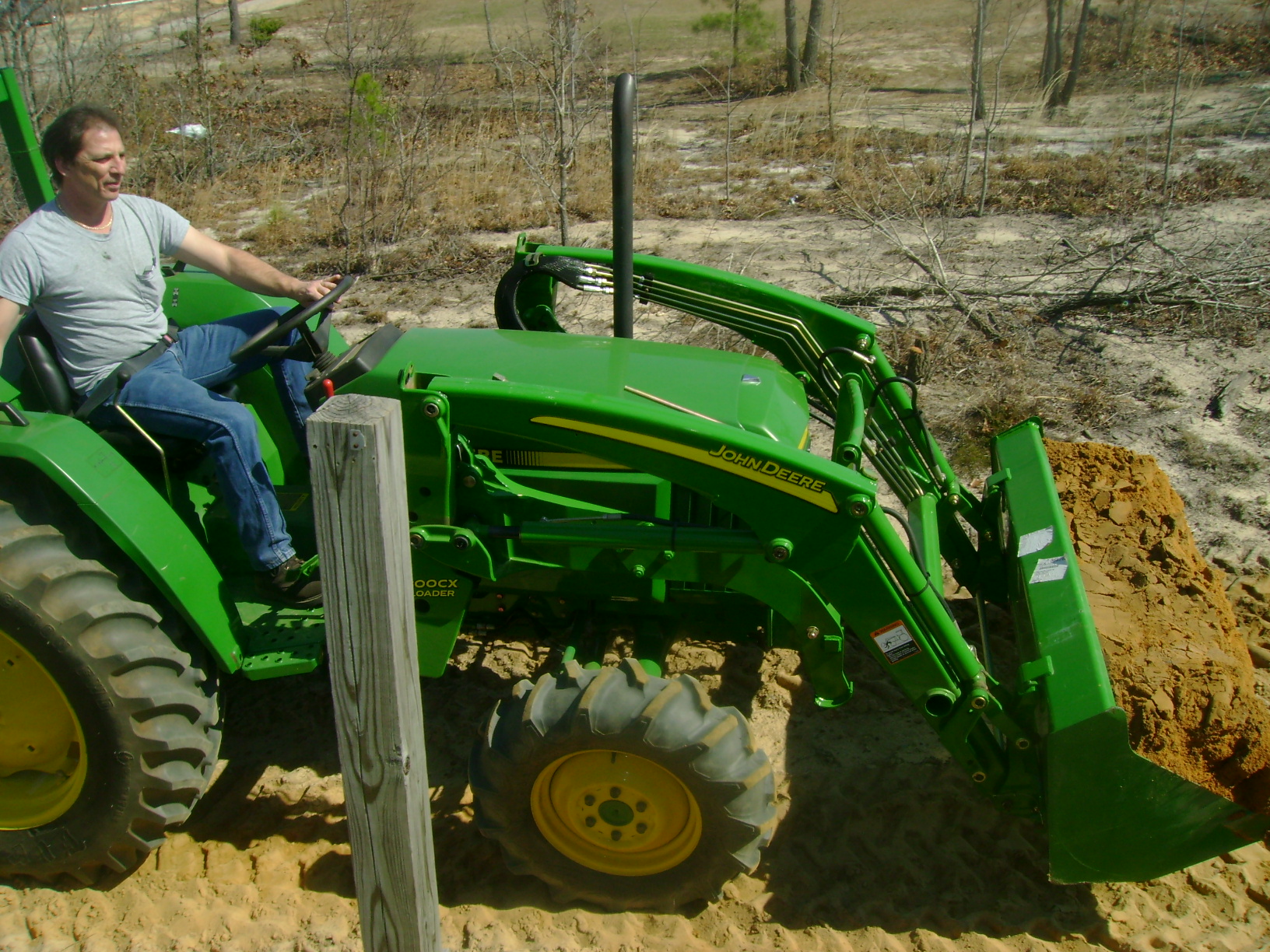

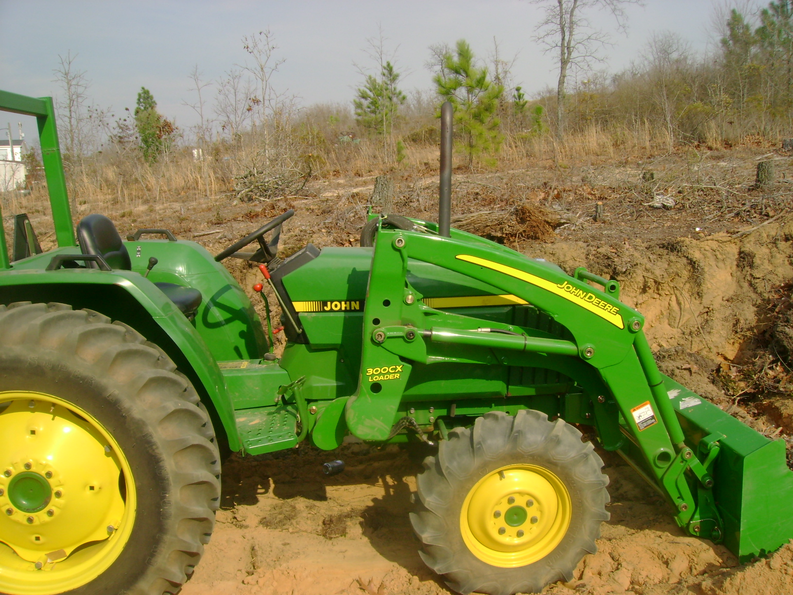

It didnt take more than a minute after i got this tractor and started to dig that i realized 2wd and loaders just dont work well. Since i was told to use 4wd only when you need it, i tried to start out with 2wd. All i had to do was flip that 4wd lever and all was well. The rear tires are loaded and i was digging in sandy soil with some clay in it. If you get a 2wd tractor with a loader your going to be very dissapointed in the long run.
This is a jd1070, which was i belive 39 horsepower with 35hp pto. I moved a hill with it then sold it and bought a 24x30 shop, now i need to buy another tractor to mantain the property, DOH

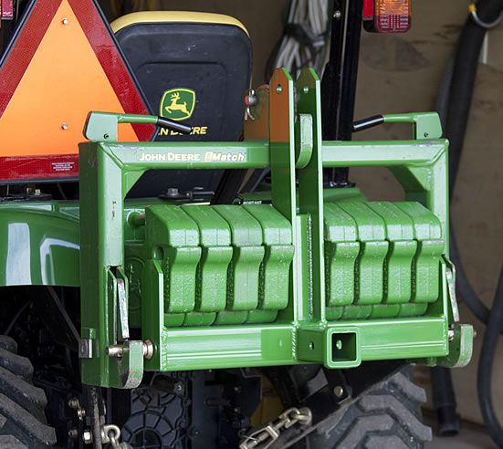

Somewhere in this thread, you asked about concrete weight, specifically a half of a 55 gallon drum. An 80 bag of redi-mix is .66 cubic feet, the same volume as a 5 gallon pail. So your talking 80/5 or 16 pounds per gallon. At 27.5 gallons that would be 440 pounds.
Add another 20 pounds estimate for steel to fab up the ballast box, you'ld have 460 pounds of ballast, give or take. Of course, I would recommend filling the rear tires as well.
/ Front end loader Q's #37
Concrete is 150 lbs per cubic foot, steel is just under 500lbs per cubic foot. I filled a ballast box of four cubic feet with as much steel scrap as I could gather up, I figure close to one cubic foot, and the rest concrete which will give me about 900 lbs all behind the 3pt lift eyes. I also partially embeded a frame made of 1/4" plate in the top to give me a place for chains, tools or whatever and also more weight if I need it. The tires aren't loaded because I don't always want the tractor to be that heavy but, when doing FEL work I really want that weight back there. I like the ballast box rather than an implement because it is quite compact so I don't need to be watching it so much when working in close quarters.
This works well for me, your results may vary.

Here's something I designed for my tractor and now offer for sale. It keeps the weights close to rear and allows for easier manuvering in tight spaces.heavy-hitch-applied.jpg
