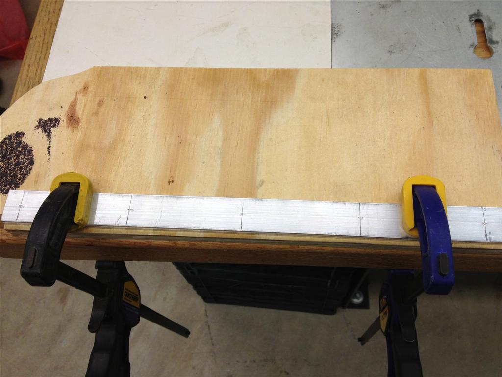

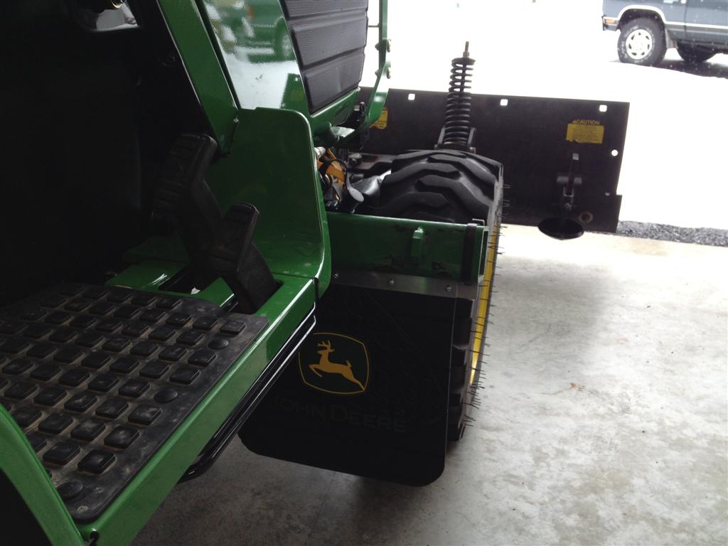

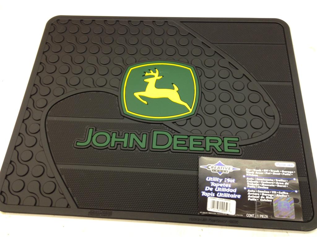

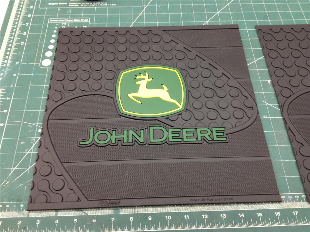

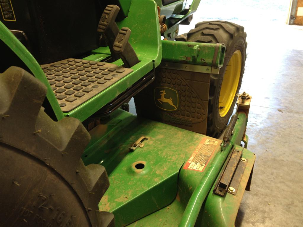

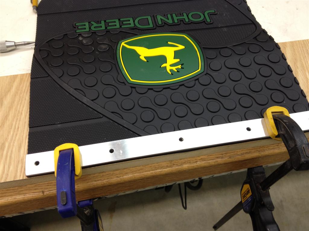

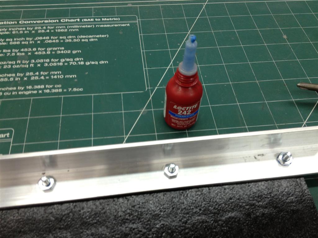

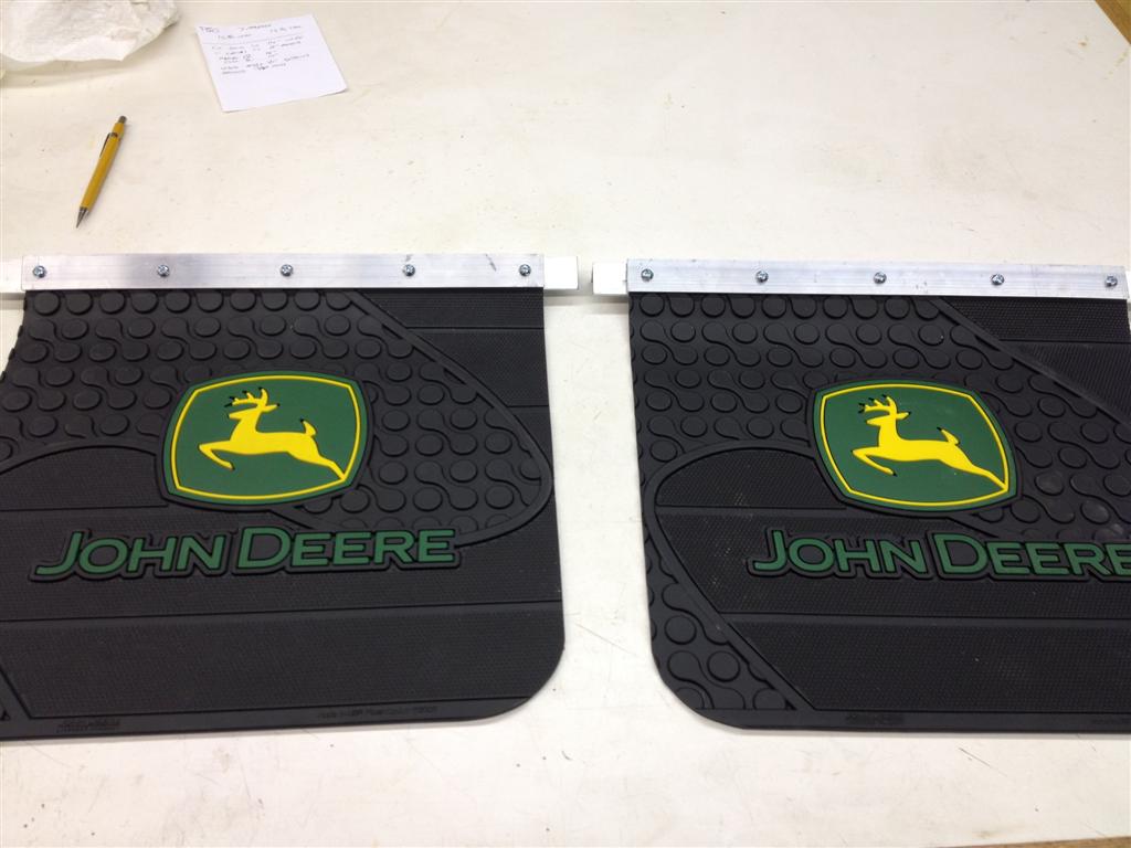

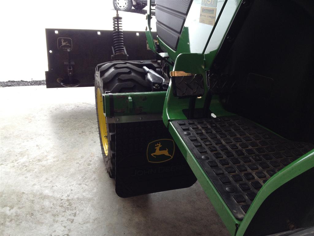

I too wanted fenders in the front, I guess I'm a fast mower as well :laughing: but I never could find anything so I went a different route, mud flaps.
Found these at TSC:
Trimmed them a little, and made some aluminum holders for them:
IMG_1881 (Large).jpg IMG_1885 (Large).jpg IMG_1888 (Large).jpg IMG_1889 (Large).jpg
So I ended up with this:
Then I mounted them with heavy straps:
My MMM was noticeably cleaner after installing these!
And, I don't have a picture but while plowing and roading to the neighbors there was A LOT less spray off the tires hitting me and the tractor. Probably not as good as real fenders, but it may give some ideas...
