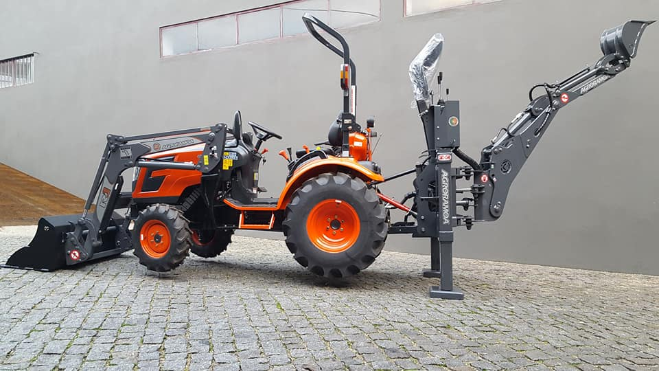

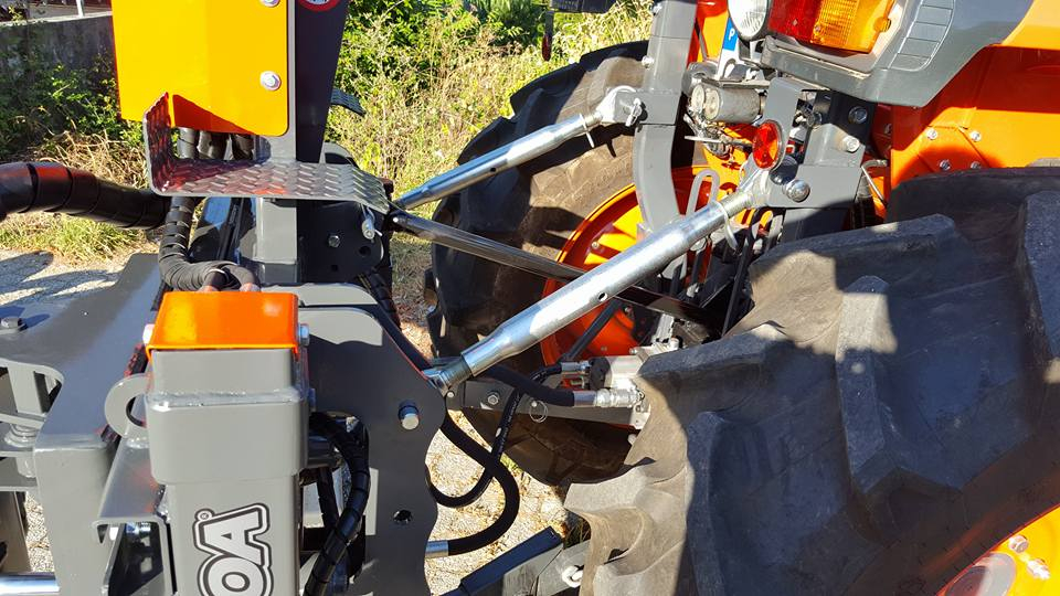

As it's been discussed before, 3 PT backhoe can be hard on tractors. So in the future, you may want to consider adding some extra links attached at other points on the tractor to help spread the load on other points other than the top link mount.
Similar to this, is a good starting point. This is also a 3 Pt backhoe.

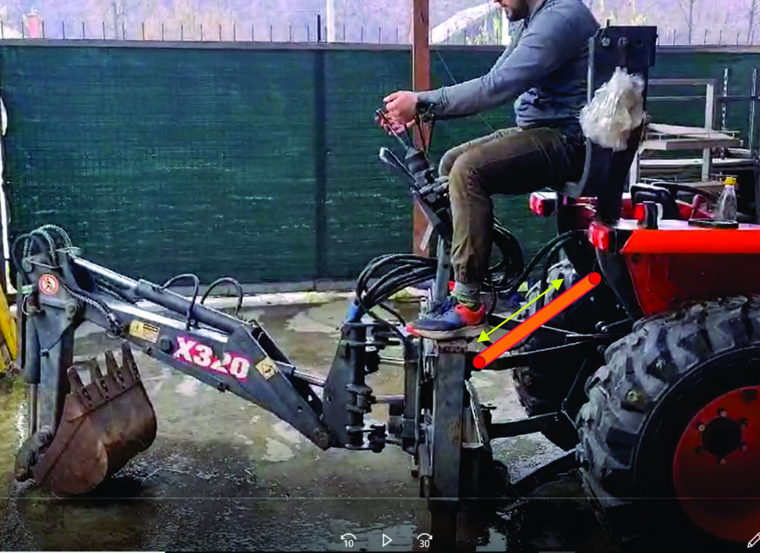

Thanks for all the advice ....sincerely. We wouldn't have done this without you... And I'm already thinking about other points of support , not on the top link - maybe on the protective FRAME on the tractor... we'll see, like the picture you posted.
Fixed in a row point because weight of the tractor keep the backhoe on the ground.

That will help too, specially to avoid the backhoe to simply lift the 3 pt by itself. Won't help a lot with relieving the top link pressure.
Here is another picture I had saved. I'm sharing these pictures mostly to give you some ideas to work from. If I find more, I'll share those too.
