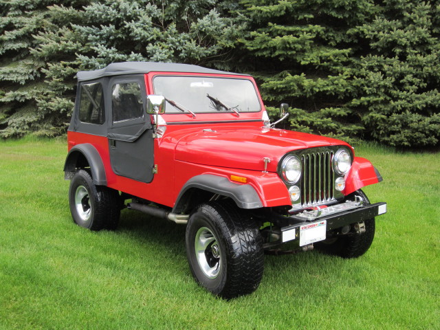

I did not understand their description and how it related to constant pulling or pressure like tractor use would be. Their description of a wheel spinning faster than it is driven would be like descending during rock climbing.
