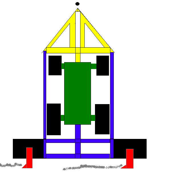

Ah, now this all makes more sense. Knowing the application really helps us help you. Based on your reply it appears that your parameters are blowing 2 windrows approx. 3ft sq on either side of the plow while minimizing the amount of equipment required and minimizing the impact on the "medians". Just off the top of my head I would say that mounting everything on the single loader would increase the impact on the "medians" as your contact psi will be higher. What if instead of mounting the blowers directly to the loader you built a "trailer" that the loader backed into that would essentially be self contained. Most loaders have at least have a hitch. This trailer could be "U-shaped" to keep the OAL as small as possible and bring the blowers up alongside for ease of operator observation. The loader then only has to pull it along. High floatation tires could be used to minimize ground contact pressure and it could have it's own power unit so as not to rob any power from the loader. Since it would be easily removed the loader could still be used as just the plow if need be or as a loader in the off-season. This also wouldn't necessitate the purchase of a new loader.

See attachment.
To hook up the snow blowers like a trailer, you could just tie them into the v-plow with quick disconnect pins. The blue parts are just the first ideas I had to mount the snow blowers. You could connect the snow blower to the tractor hitch and then run a piece of steel on each side to connect to the rigidly mounted v-plow, this turns the trailer into a easily disconnectable snow blower u-shaped frame. Also by placing the frame outside the tracks, it greatly reduces the stress on the rear hitch during turning. I would probably put a step on these steel frame pieces for easier cab access but that's something to be worked on in a later stage of planning.
In the rear you could use that space for the bat-wing mower style PTO drives for the snow blowers or for the power unit for the snow blowers and the rear of the frame could be extended rearward if more space for weight is needed.
The black circle at the top is a runway light.
If this turns out to be feasible, it's going to be one snow-taming beast. We'll all be eager for pics (including the construction) of the "TBN Airport Snow Beast".

Somewhat like I was trying to describe. However, if you stay with an articulated piece of equipment you have to keep the front and the back seperate (can't attach the V-plow to the back) or you won't be able to turn.

Attaching the blower component to the plow with a long beam was something I was wondering about too, but the loader that we have right now has a pivot in the middle for it to turn. We still need to be able to turn tight to navigate between runways, and taxiways, so unfortunately this won't work.
I didn't have any time at work today, but tommorow I'm going to take another look at the loader to see if there is a place behind the pivot solid enough to attach the blower unit to. There is also the option of purchasing a unit with a backhoe (I was told today that apparently money is no problem), which would make mounting much simpler. It would provide hydraulics as well, so a trailer unit wouldn't be necessary. This is a last resort though, because I would like to stay with the CASE 821B, since the airport owns a few which could act as replacements in case of break-downs.
Attaching the blowers to either end of the V-Plow was brought up initially, but it had to be rejected because the snow has to blow in the same direction, which would mean snow blows in front of the driver.
I think for now I am gonna run with the trailer idea and see how far it gets me. My manager seems to think it is doable. I am still not so sure how to solidly secure the trailer behind the loader, hopefully tommorow I will see something that catches my eye. Because right now the exsisting trailer hitch wouldn't be solid enough to keep the trailer rigid. It needs to be rigid, because when the loader wants to turn, the trailer needs to turn with it (if the trailer is a U-shape, which seems the best at this point); if it lags behind in moving it will interfere with the rear tires. I would like to see the trailer hook up with the hitch, and then arms on the side to securely fix it to the tractor.
