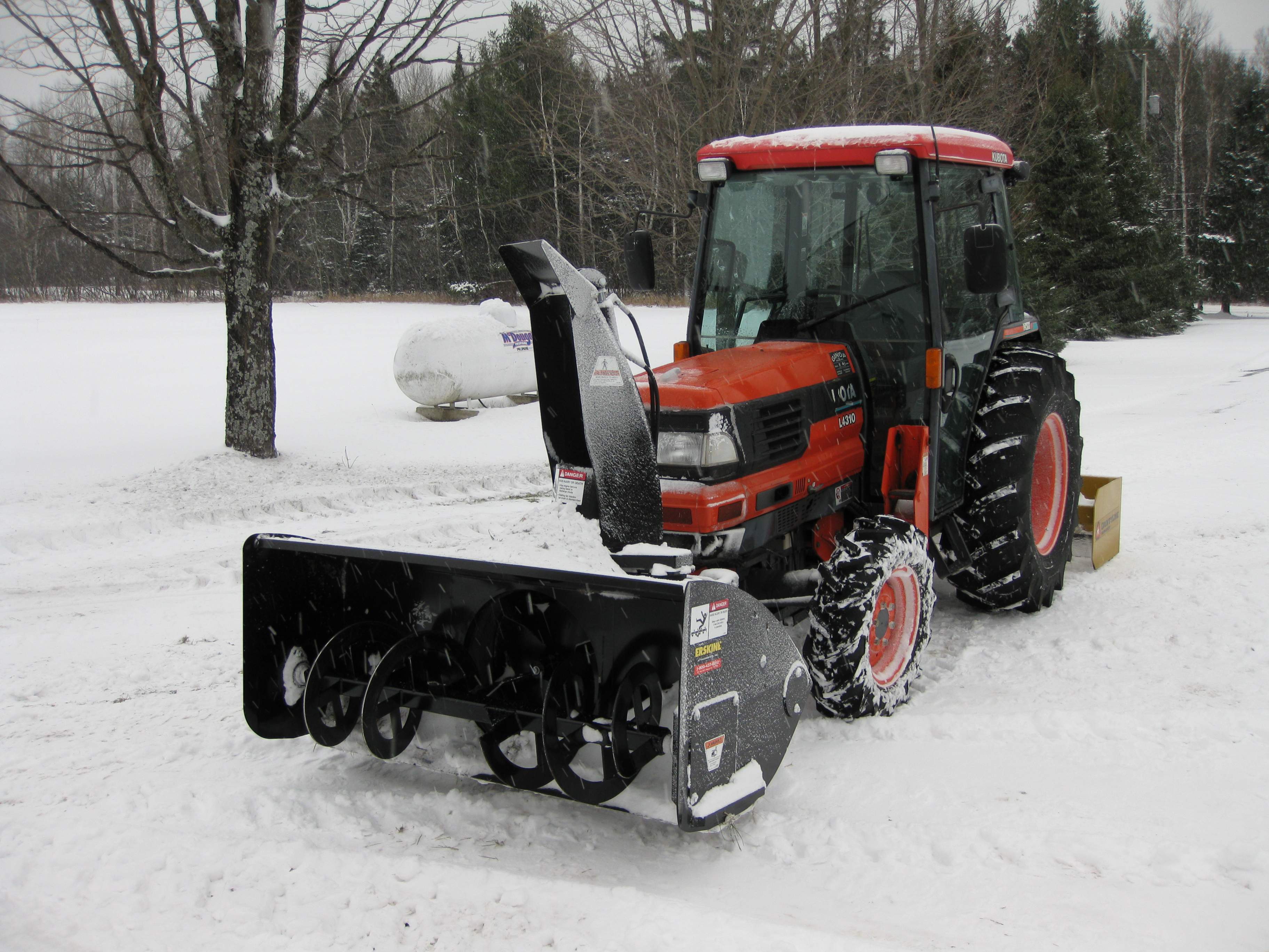

Ive gone through my first season (well almost,its still march) with my front mount , rear drive erskine and all i can say is wow. Solid well built heavy piece of equipment. I would recomend this unit to anyone. Oh and also NO SORE NECK ANYMORE?? Great work erskine.

rayclar, can you post a couple of pictures of how it mounts?

aczlan , every tractor mounts differently, even the kubotas are different. I had to modify my mount as erskine did not have a front mount for my model. My front mount , mounts where the loader attaches. Check out erskine's site.
