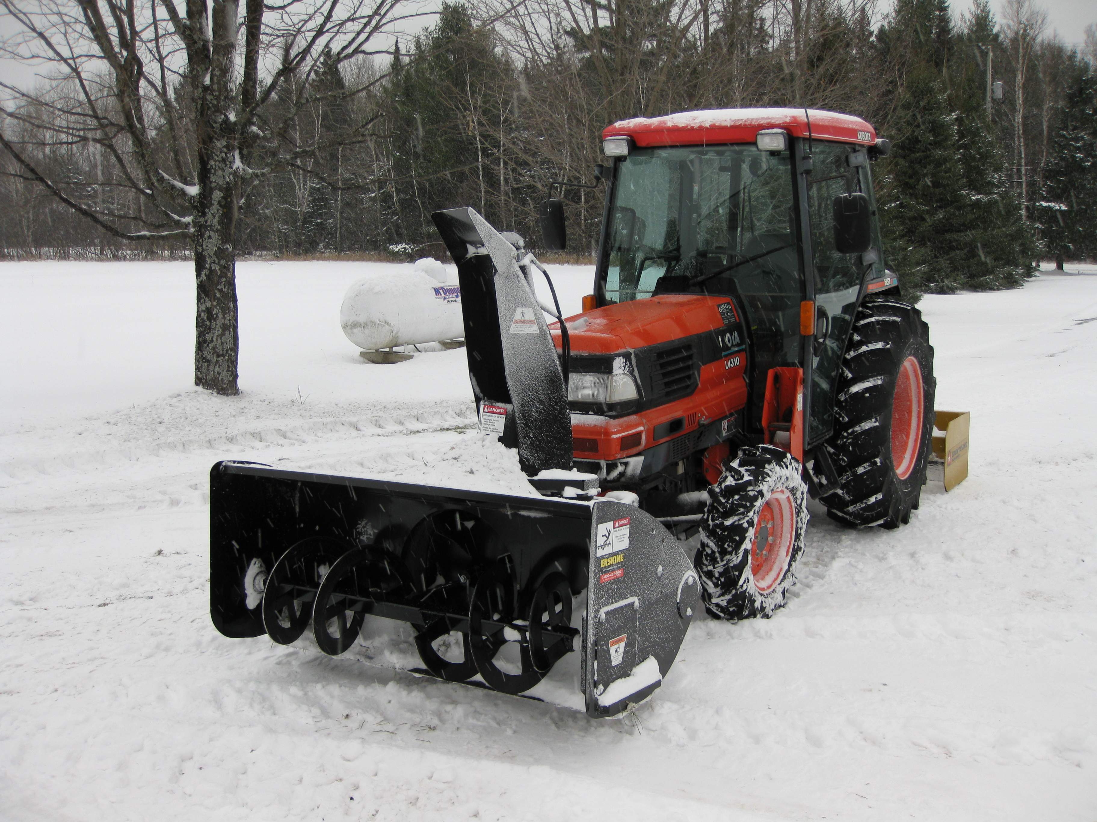

Ive gone through my first season (well almost,its still march) with my front mount , rear drive erskine and all i can say is wow. Solid well built heavy piece of equipment. I would recomend this unit to anyone. Oh and also NO SORE NECK ANYMORE?? Great work erskine.

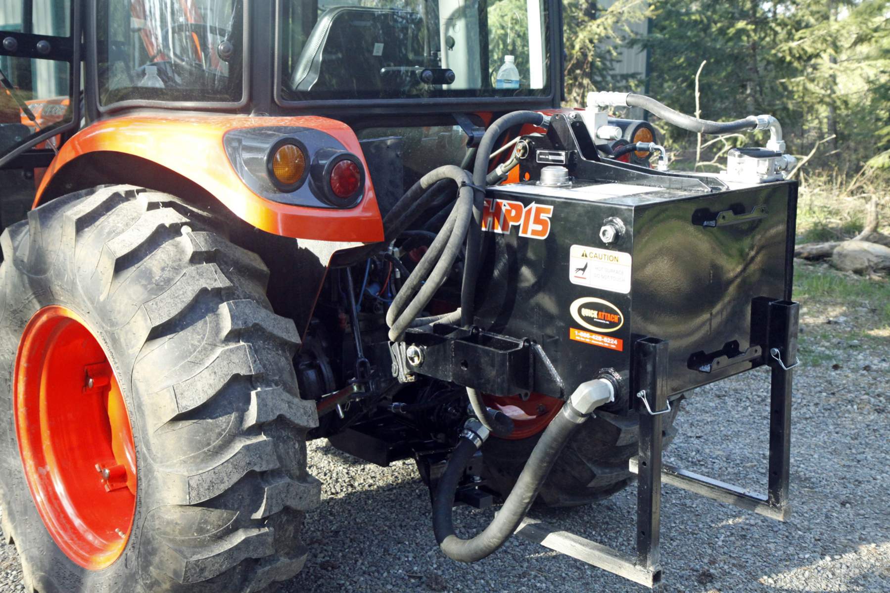

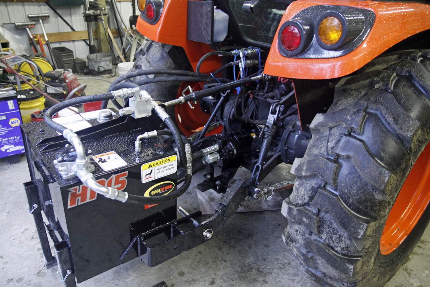

hes right. my hyd snowblower uses 25 gal rear tank with 3,000 psi, 15 GPM pto powered pump. mine is all hydraulic motors...no gears. The system works great, and i love it. But expensive.
Luckily i was able to sell my old tractor for enough to buy the blower, so it was a non issue for me. but to buy one your looking at about $10,000-11,000 for hyd power supply and all hoses and blower. plus $300 in hyd fluids.
another benefit of all hydraulic motors to drive unit....NO shear bolts...NONE. man, i hate shear bolts\
but before buying this unit, i looked at alot of high end rear pull and push units. A nicely built, heavy duty unit that mounts to the rear are in the high 4 to low $5,000 range. I likes the rear pull units, but it would be useless in clearing the snow that sheds off of my barns. otherwise i did like these units.
If i was doing driveways...id go rear pull no questions asked.

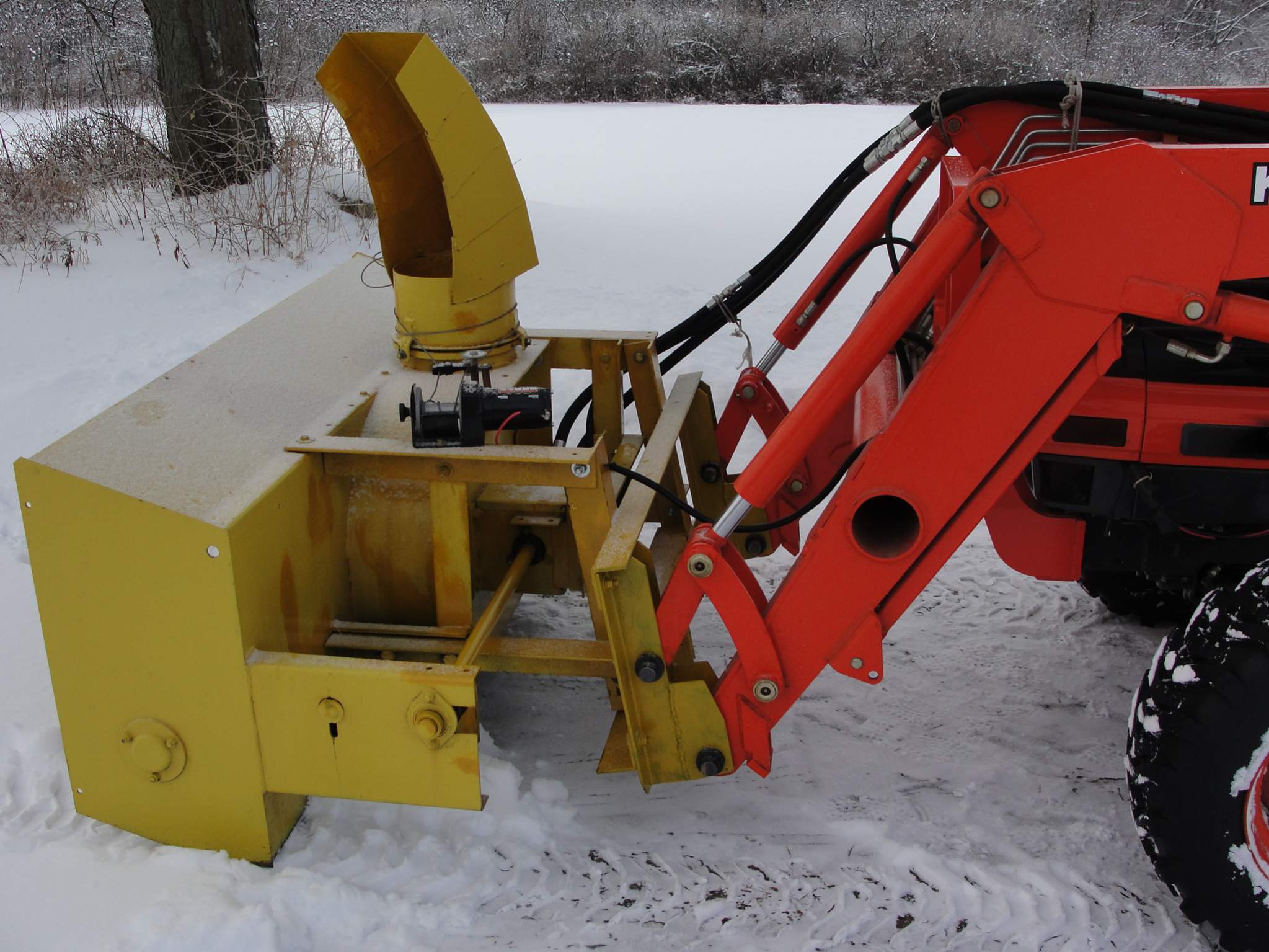

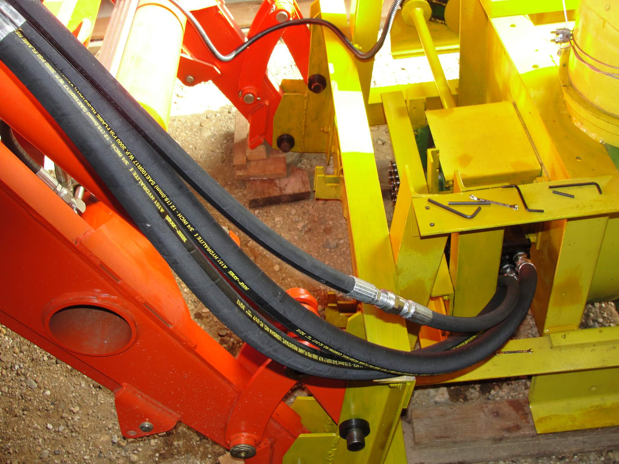

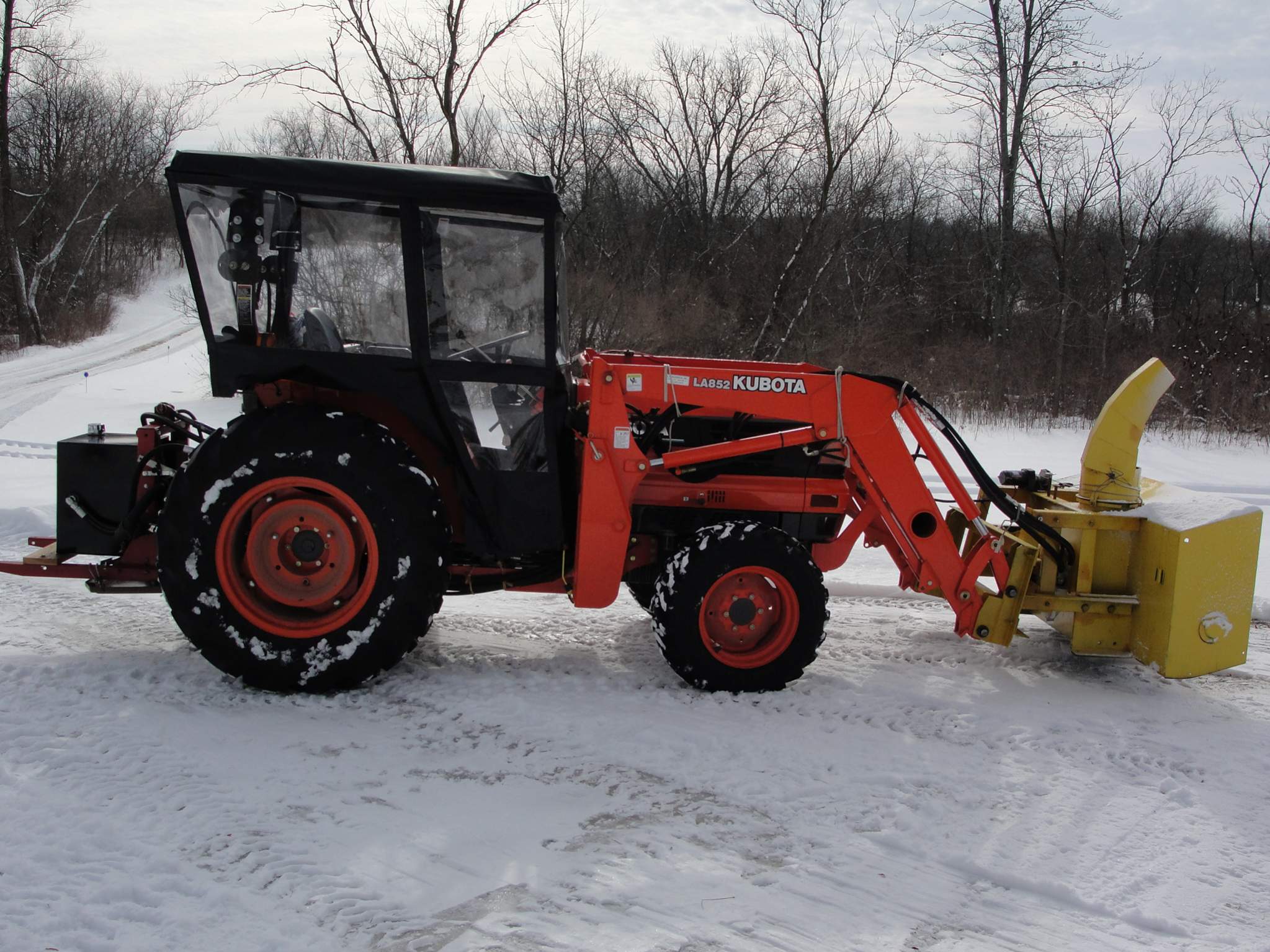

It looks like that "black sleeve" is made for steadying a shaft.............. but the orange color behind indicates no shaft in place perhaps?
That Pull Behind blower would take some work to mount it up front on a loader (replacing the bucket ex.). Here are some pics to show my rear push blower mounted on the front. The blower in your pic would be more difficult to do a 4 point than
my setup. (It works really really well)....................... no more "pain in the neck" looking backwards!
Mine is 95% done (fix hoses to tractor frame, loader arms etc) but last "Thanksgiving" it was needed as is with snow coming down so now with spring here I can complete it. In dollars about 1/4 of the price of an OEM.
