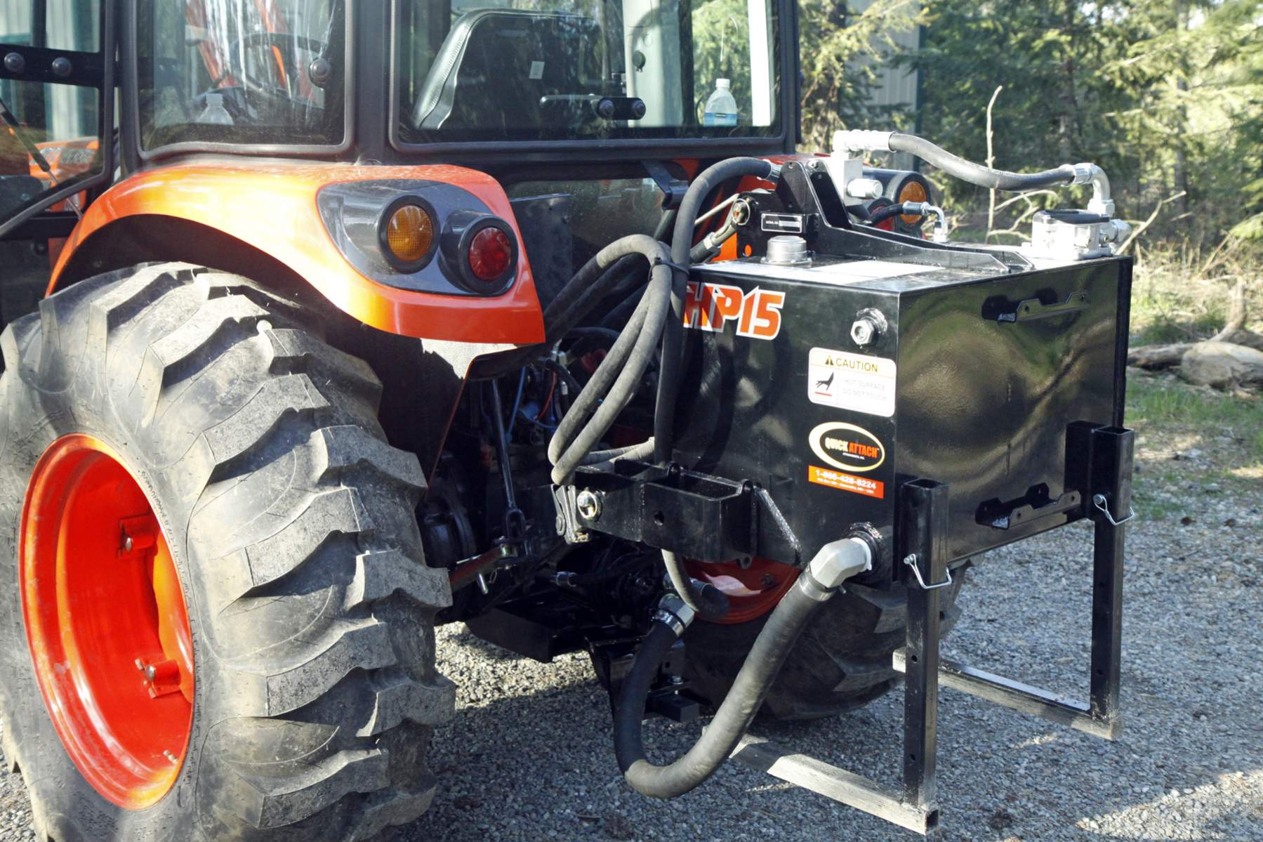

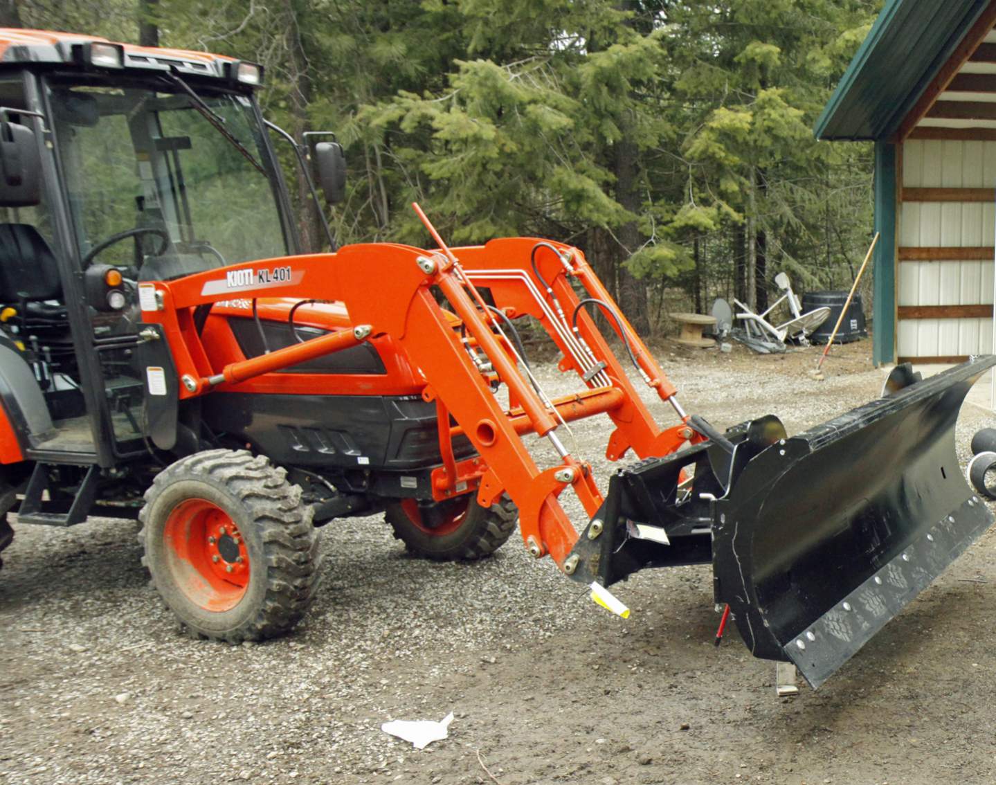

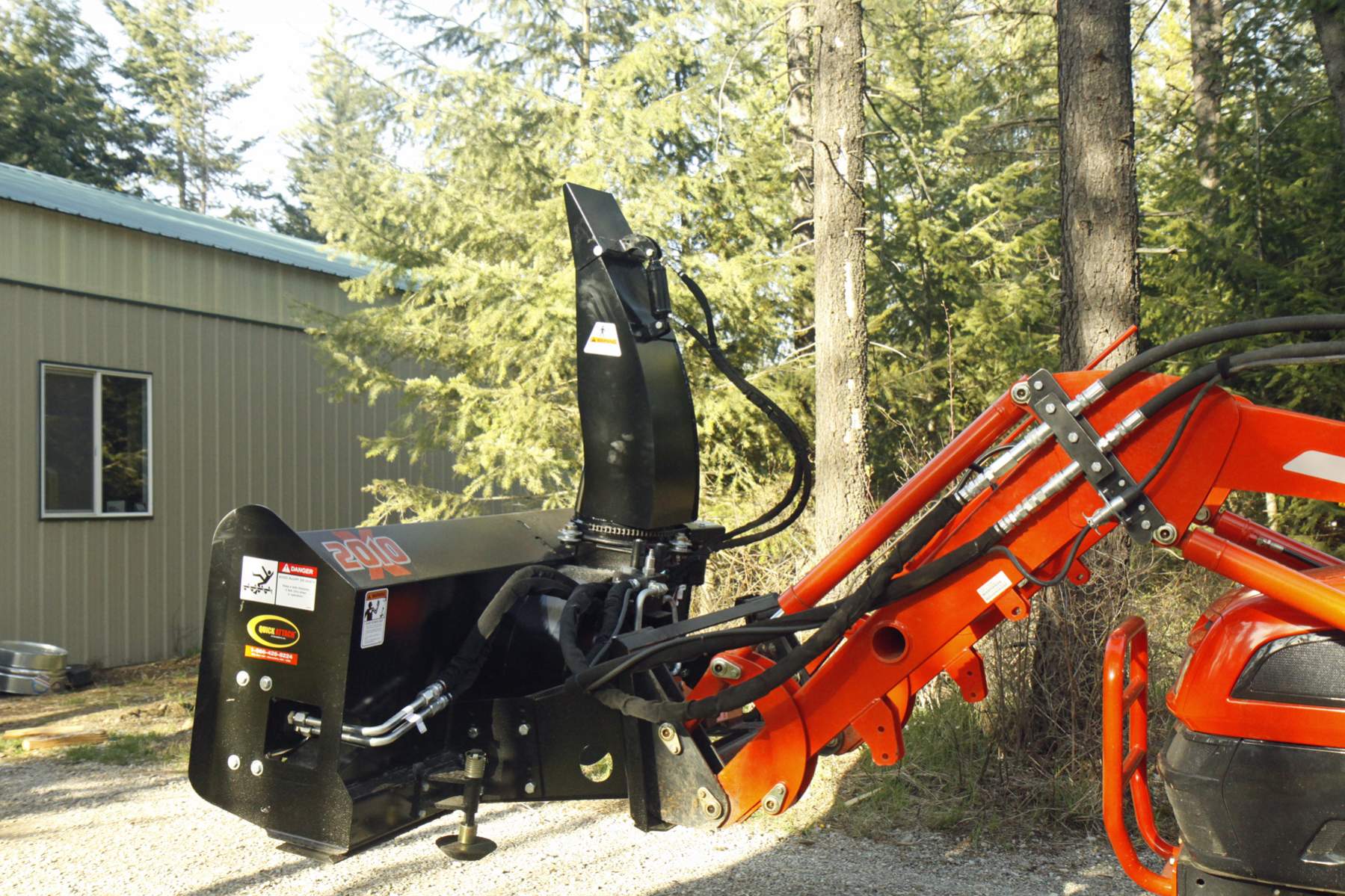

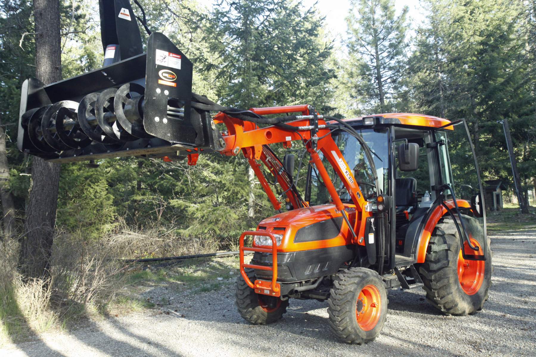

My new tractor is HST controlled, so i can set speed to conditions. i haven't Had it thru a winter yet, but due to neck and back issues (probably due to 8 winters of driving backwards) i recently purchased a loader mounted blower and rear power-pack from Quick Attach. They are kind of spendy, a little over twice the price of a good quality rear pusher model, but my back required it. I actually cant wait till winter
That thing is awesome. Being able to lift the blower up to much up piles is a terrific feature. I see it is hydraulic-powered...does it have it's own PTO pump? There is no way that tractor hydraulics would even be close to being able to run that thing - you'll need at least 25-30HP up at the blower.
JayC
yes, it has a rear mount hydraulic unit with its own pto powered pump

i love my loader mounted blower. But Leonz is correct about the power loss in a hydraulic unit UNLESS it uses the rear 3 point hydraulic system. My unit cost a little over 2x what i was quoted for a WELL built, very heavy duty rear mount standard blower. A pull type blower would be useless for my operation, especially when i have to move roof shedded snow piles 5' tall.
My neck thanks me every time i have to blow snow.
The biggest drawback on my system is the time it takes to install everything at start of season. That does suck.
I also LOVE the maneuverability the front mount gives me. I can lift mine over any obsticle and turn on a dime. Its really great passing thru a gate. I can lift it over a post and begin turn right after front tire meats post. I can get in tighter spots with this tractor and blower than i could ever get with my old JD870
