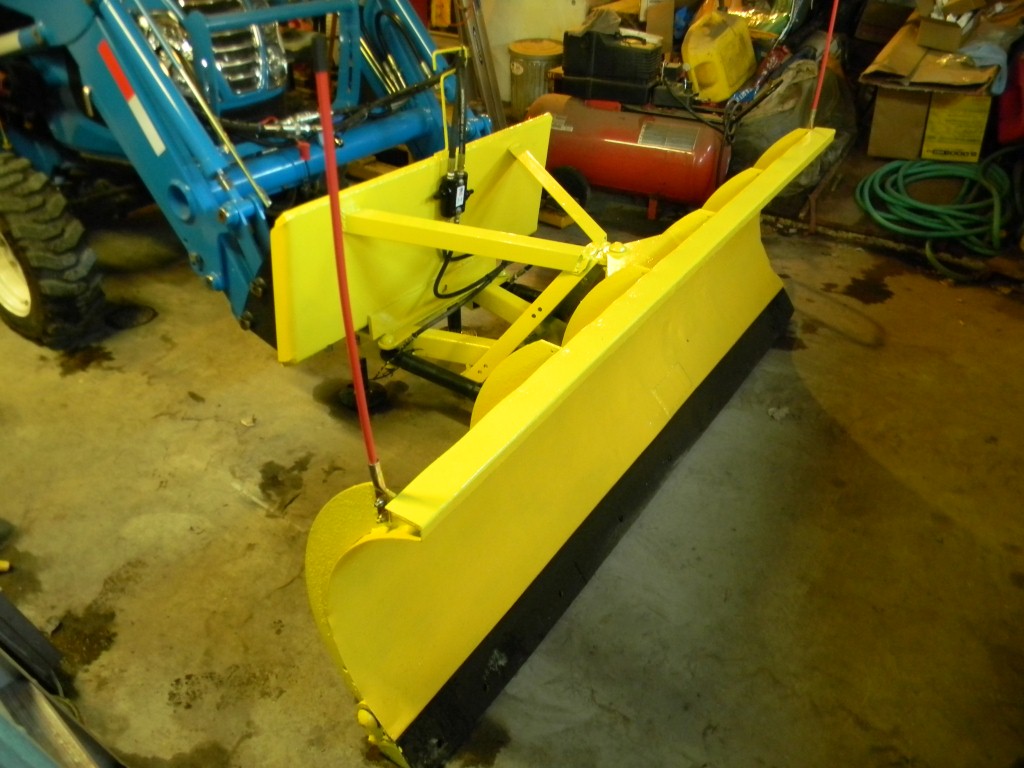

I just bought a 7-1/2' Western Plow for $300. Removed he truck mount and brackets. Welding two pin mounts on the lower edge of a quick disconnect plate and hook on the top for a chain. Loader will raise, lower and tip forward and back. Removed the hydraulic Rams. Western plows have a series of holes in the rotator segment. Will just have to get off the tractor and rotate by hand then insert a lynch pin.

I plow 325' of driveway. And, I have come to realize, that if I plan it right, most of the time, I don't have to change the angle.
Even when, the weather gets real ugly, I only have to change it a few times.
While I would like to have power angle, it's not that big a deal to me at this point.

I have no problem pushing a 6' loader mounted plow, on a gravel drive, through deep snow, with the plow angled.
I have turf tires, (no chains), 4wd, and I keep the backhoe on for ballast.
The secret, is to not angle the plow all the way. The more you angle, the more sideways, and turning forces you put on the tractor.
Mine works well, angled half way.
I have had both frame, and loader mounted plows. I believe, the loader plow is superior in every way.
A loader mounted plow, would give you the ability to make the first pass at 6-18", if the snow is too deep. (I never have to).
And, you can push the tops off the snow piles, if you need to. My wife drives a civic, so, I have to do that all the time for her to be able to see over them.

I Though I would have to cut my plow down when I first made it. I am glad I tried it first.
My GC is about the same size as your tractor, and it pushes my 6' plow with no problem.
Each property is unique. And, my land is flat.

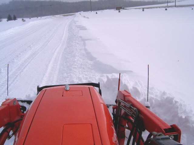

With chains on all 4 I have no problem sliding sideways with the plow angled.
A 6-10" or more is no problem.

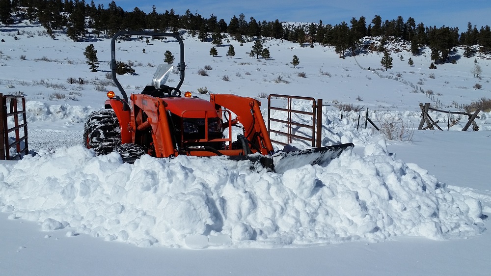

If you have a very simple set up to plow, like a narrow driveway, a small parking area, and an easy place to put the snow, you might not mind the manual angling. If more complex, or if you need to plow fairly often, go for the power angle. As mentioned above, tire chains will solve any issues of being pushed sideways when angled.

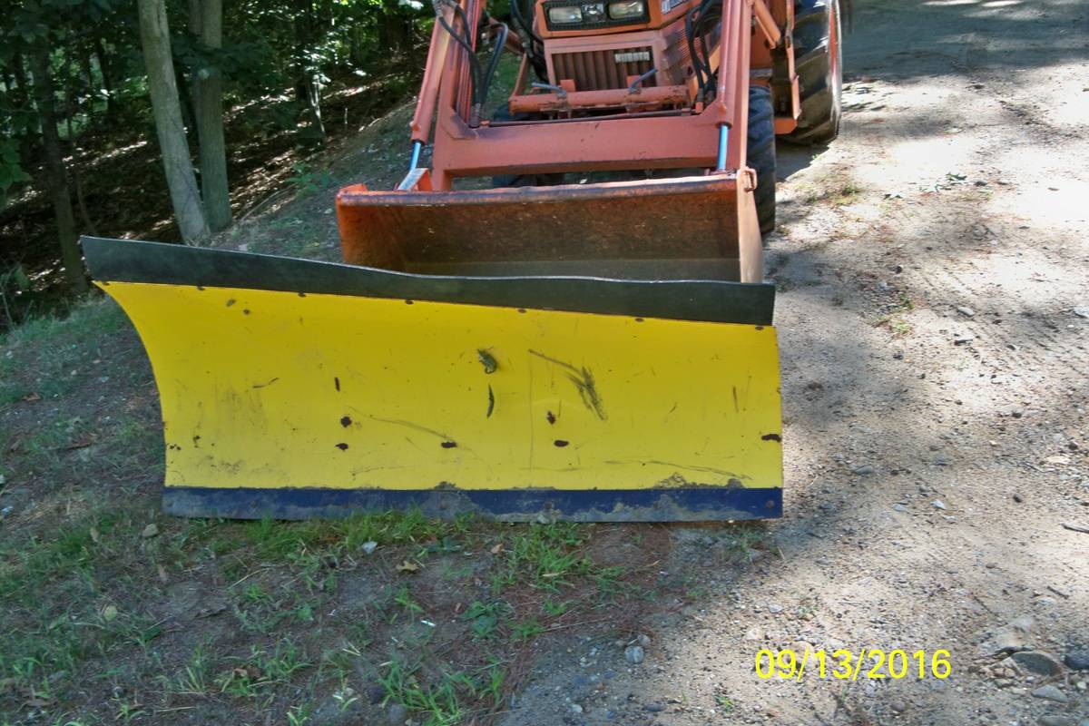

Thanks all for the replies. FatTire, I have NOTHING like your spot. I went ahead and made the deal on the plow below. The shabby mount will fit my bucket if I don't get a bracket made in time and for $125, its a cheap way in to see if plowing is my thing.
Gonna give it a bath and put the right color on it. Will post when I'm done.
