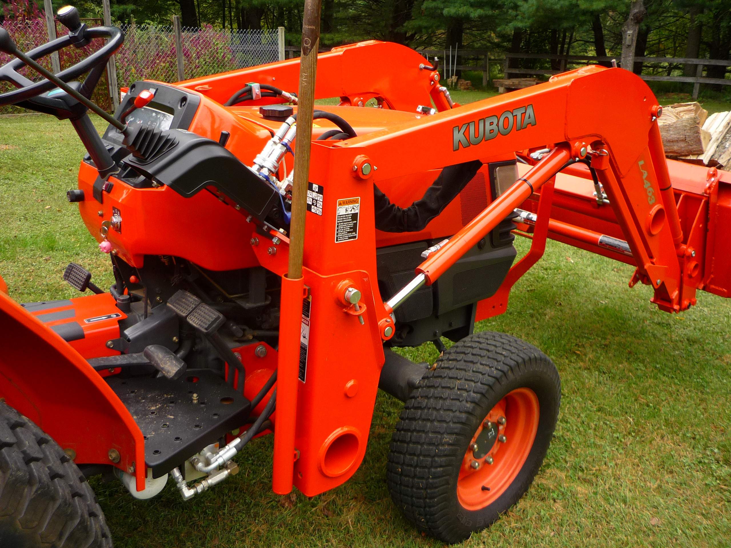

I use a set of rear remotes, with 3/8" hoses. Quick connects, and a crossover relief valve. Almost swings too fast, but I know what to expect, so I just nudge the valve to pivot the plow. Keeping the lift and curl functions is good, since you will want to use them to push and lift snow as needed. Works fine, doesn't cost much. I don't need to pivot the plow constantly, so not having a third function isn't really a problem. I had used the curl circuit on an earlier tractor with the same plow, and it wasn't as useful. You can just see the hydraulic hoses on the left loader arm.
