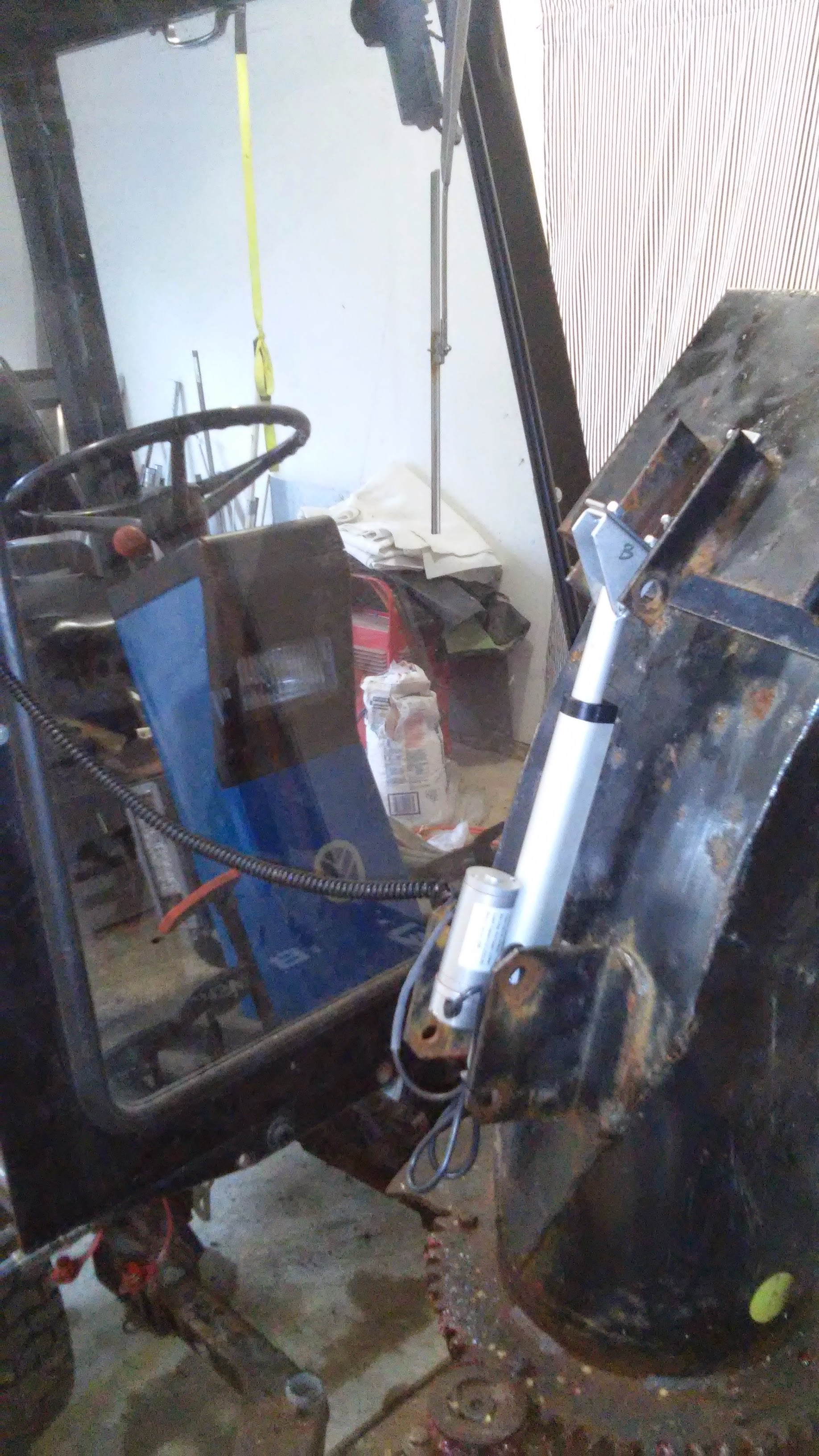

Do you have the hydraulic chute? I'm pretty good with hydraulics, someone posted how he added hydraulics and it looks pretty easy. I think the hydraulic option is pretty expensive from Kubota. I also had a different machine that I put an electric actuator on the chute deflector. That's really handy, I'll probably do the same thing again.

Hydraulic chute rotator is definitely the way to go. Here's the electric actuator I put on the deflector of a machine I used to have:
